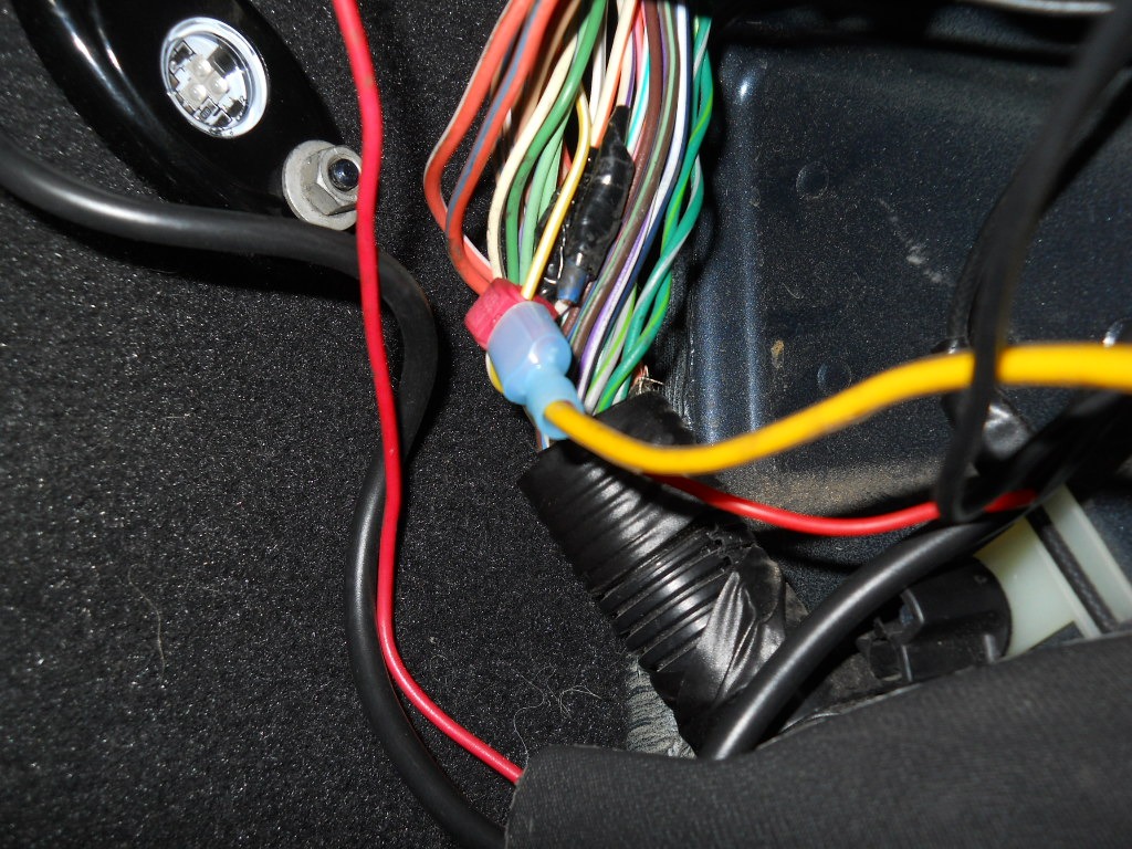

On my 08 I tapped into the yellow wire with a white strip on the Passengers side at the footwell.

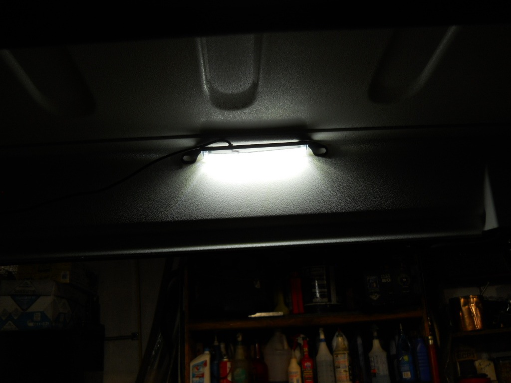

I also put a LED at the rear top right above the door to help light up the back more when the domes are on.
Yeah, now that looks nice,..!!

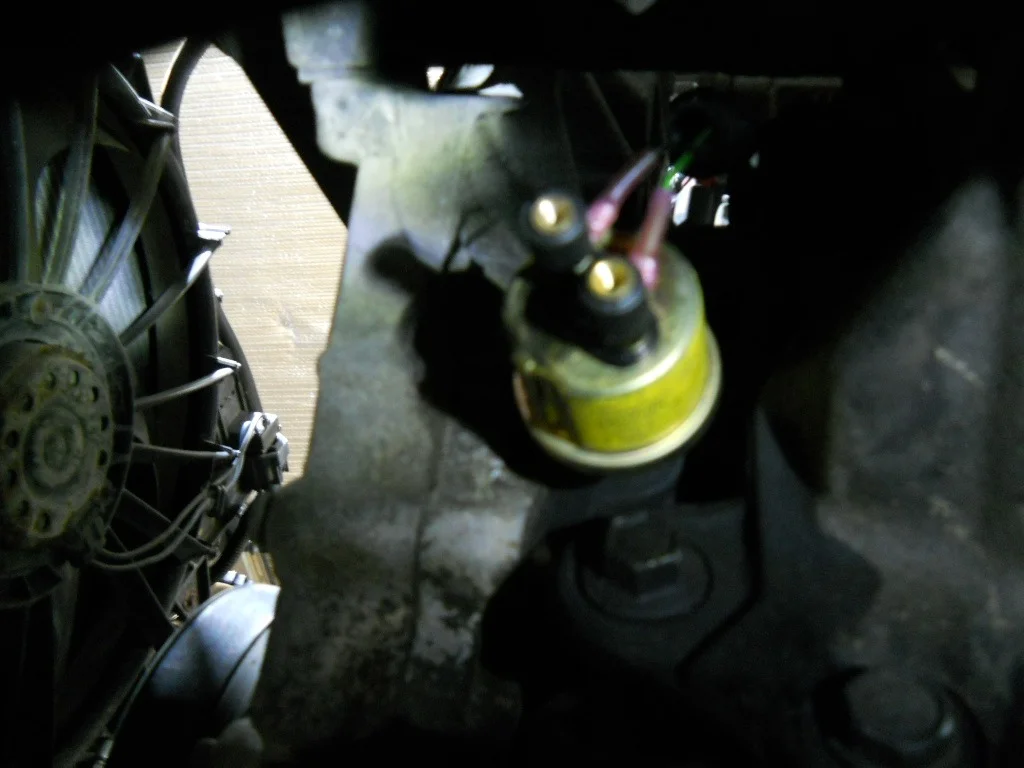

Did you have to tap that sending unit in,.. or was there already a place for it,.. ??
There's either a 1/4 or 3/8 npt plug there I don't remember now it was quite a few years ago I put it in. You just need to get a reducer plug to go to a 1/8 npt which is what most senders are now days. Also make sure to have a oil pan under when you remove it quite a bit of oil comes out when it's removed.
Got it all working last night,... passenger side, did have to remove the molding along the door, way easier to get to that than the end of the carpet,.. I'm old.
Appreciate the assist..!!
