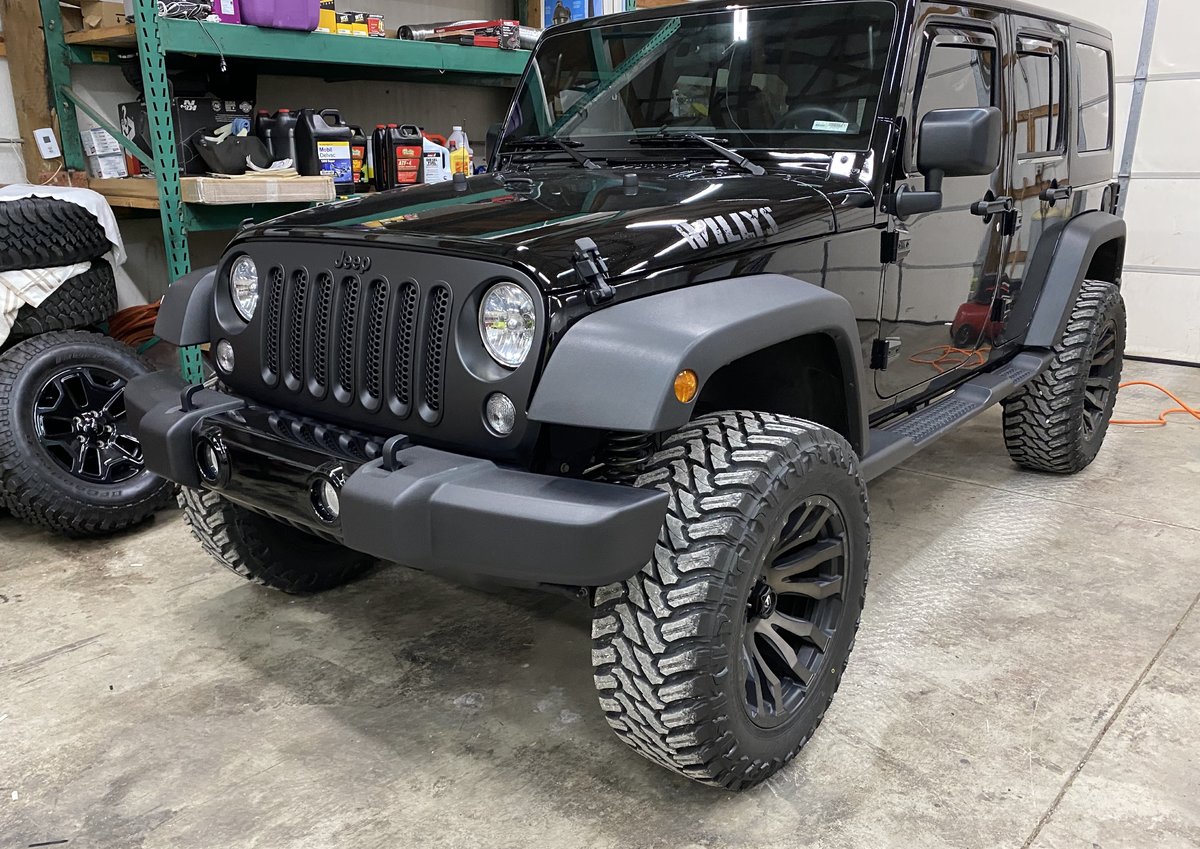

thanks for the advice. I saw your post from the new member page. I'll get a pic up once ASAP lol

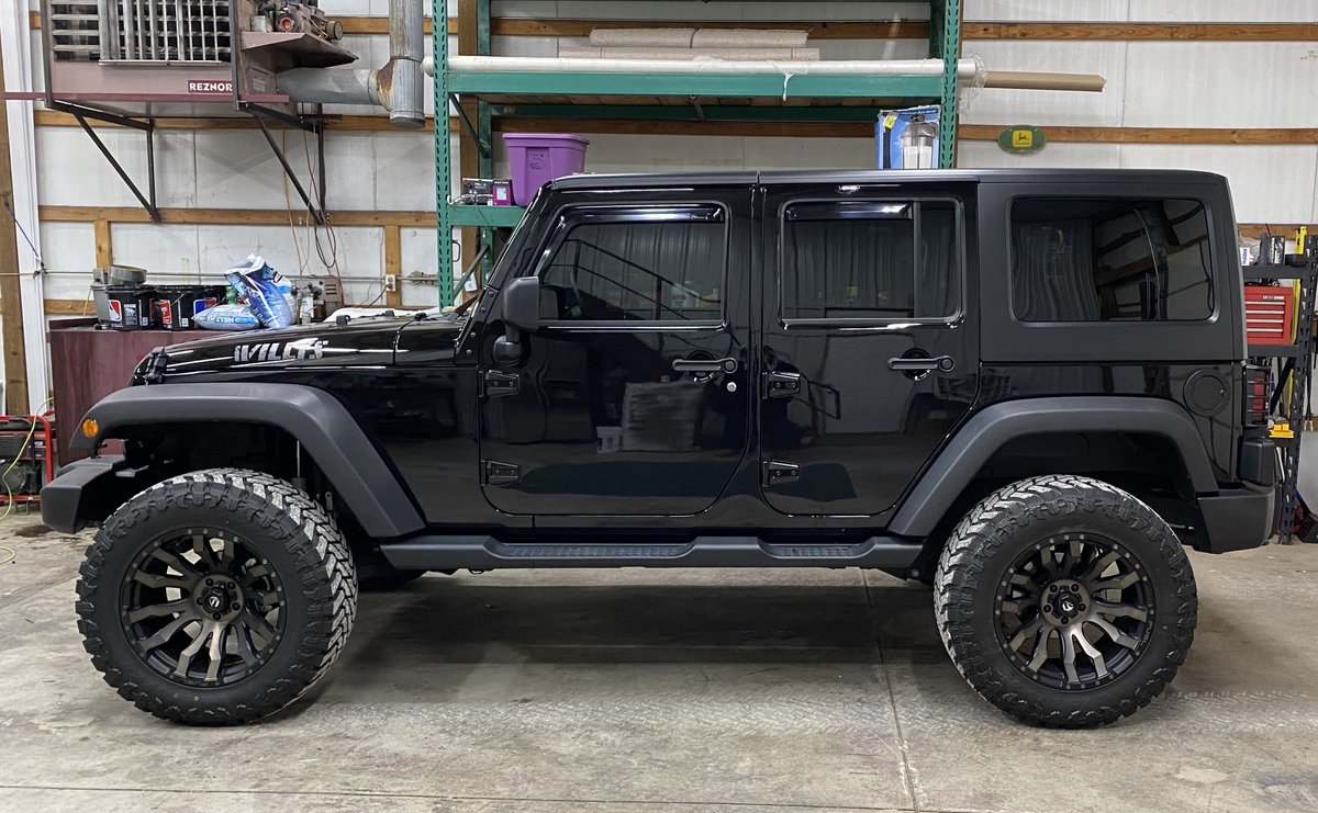

I did a 3.5” Rough Country lift with shocks and a Rough Country steering stabilizer all for $1,000 and that was professionally installed. I have 20”x10” wheels and 35” tires. It rides phenomenal, no steering issues and looks great.
