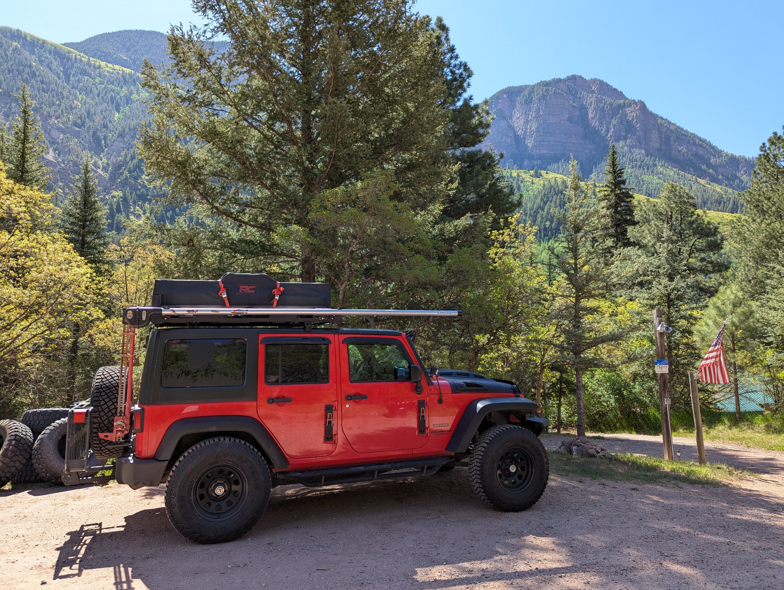

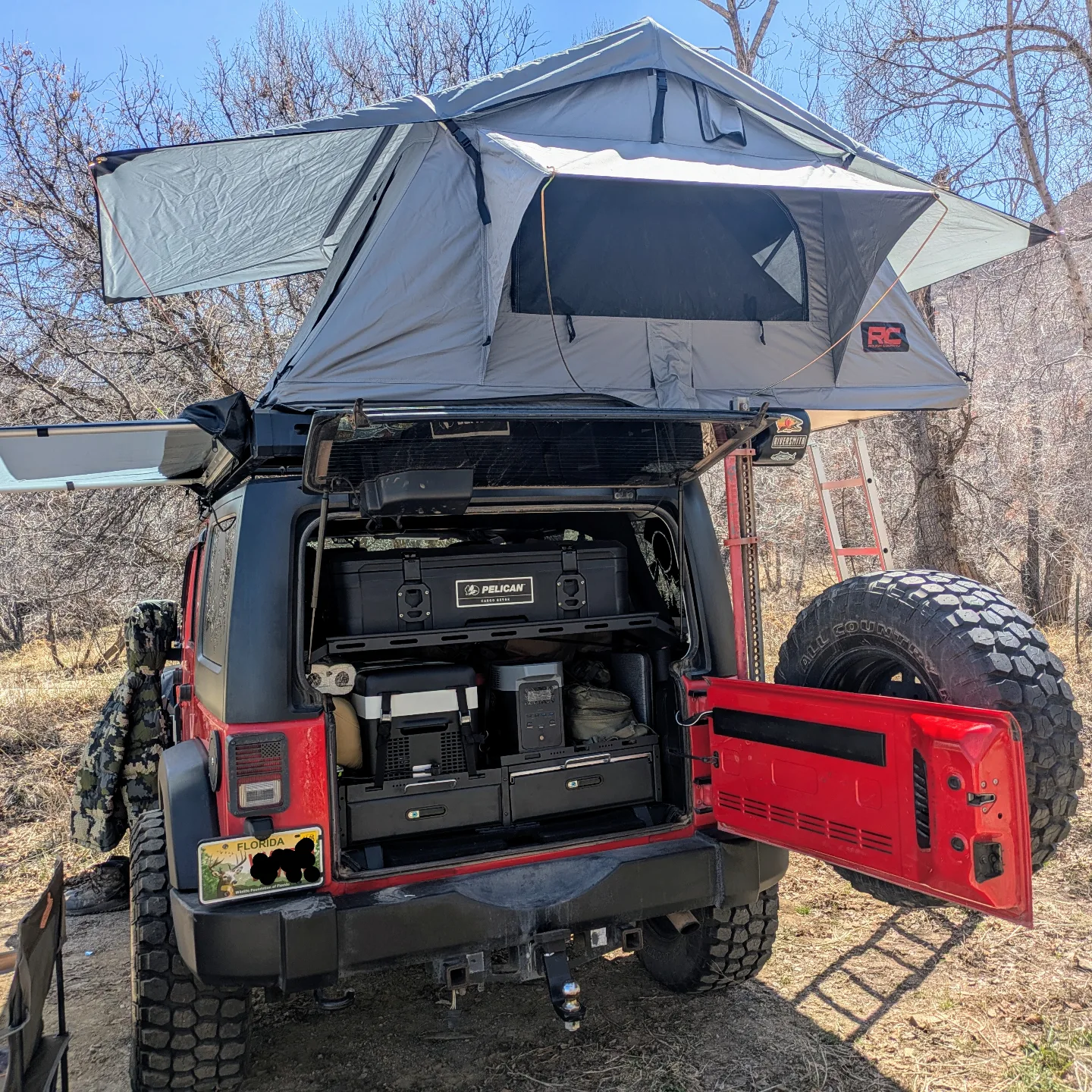

I have a 2.5" teraflex base spring lift kit on my JKU. After adding the seat delete platform and all of the shelving, bumpers, winch, gear ect... The lift looks a little lower than it use to be.
Can I get away with adding 3/4" or 1" leveling kit / coil spacers without upgrading much else to regain the normal lift height? Not much fender gap especially in the rear!

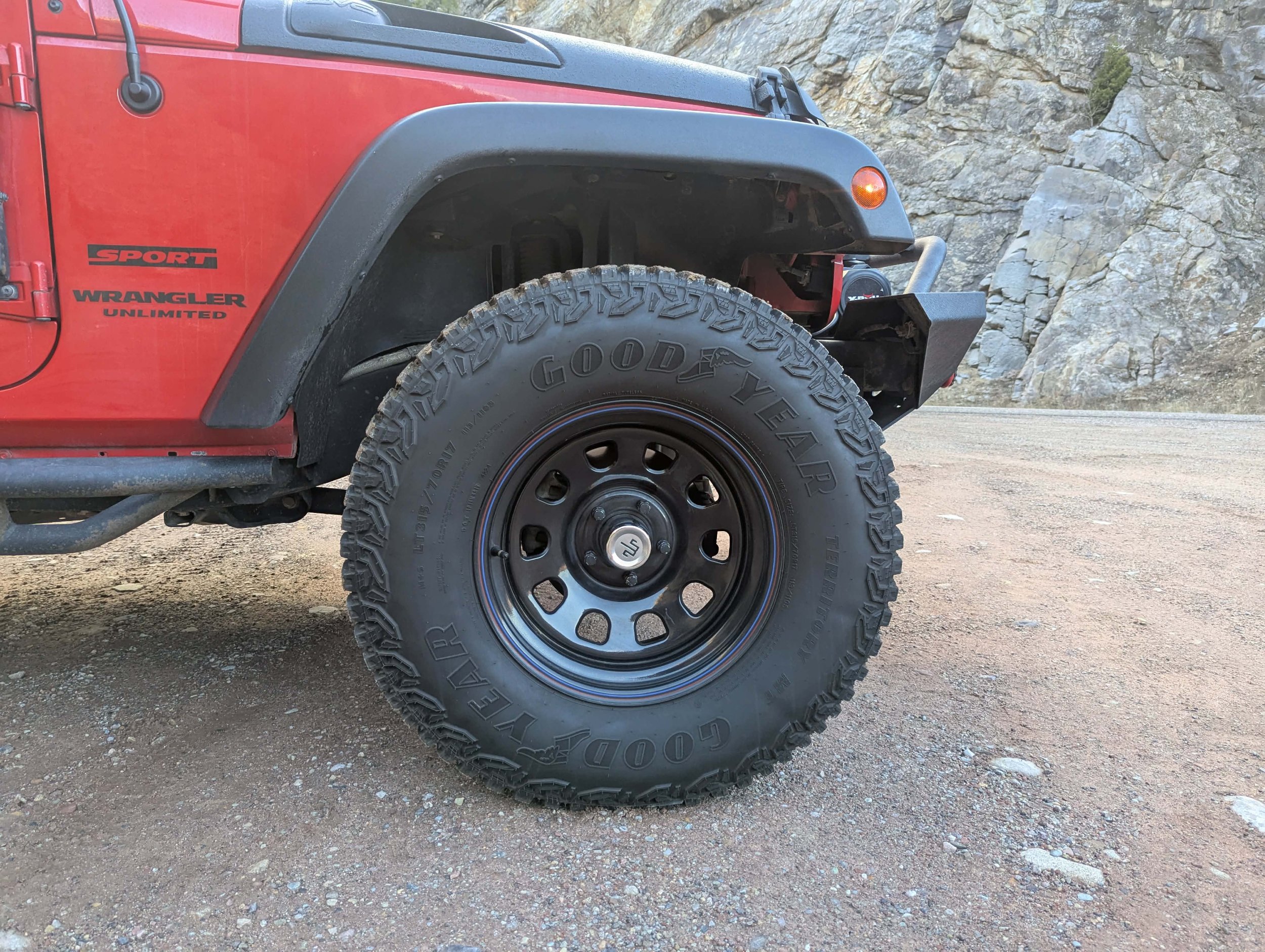

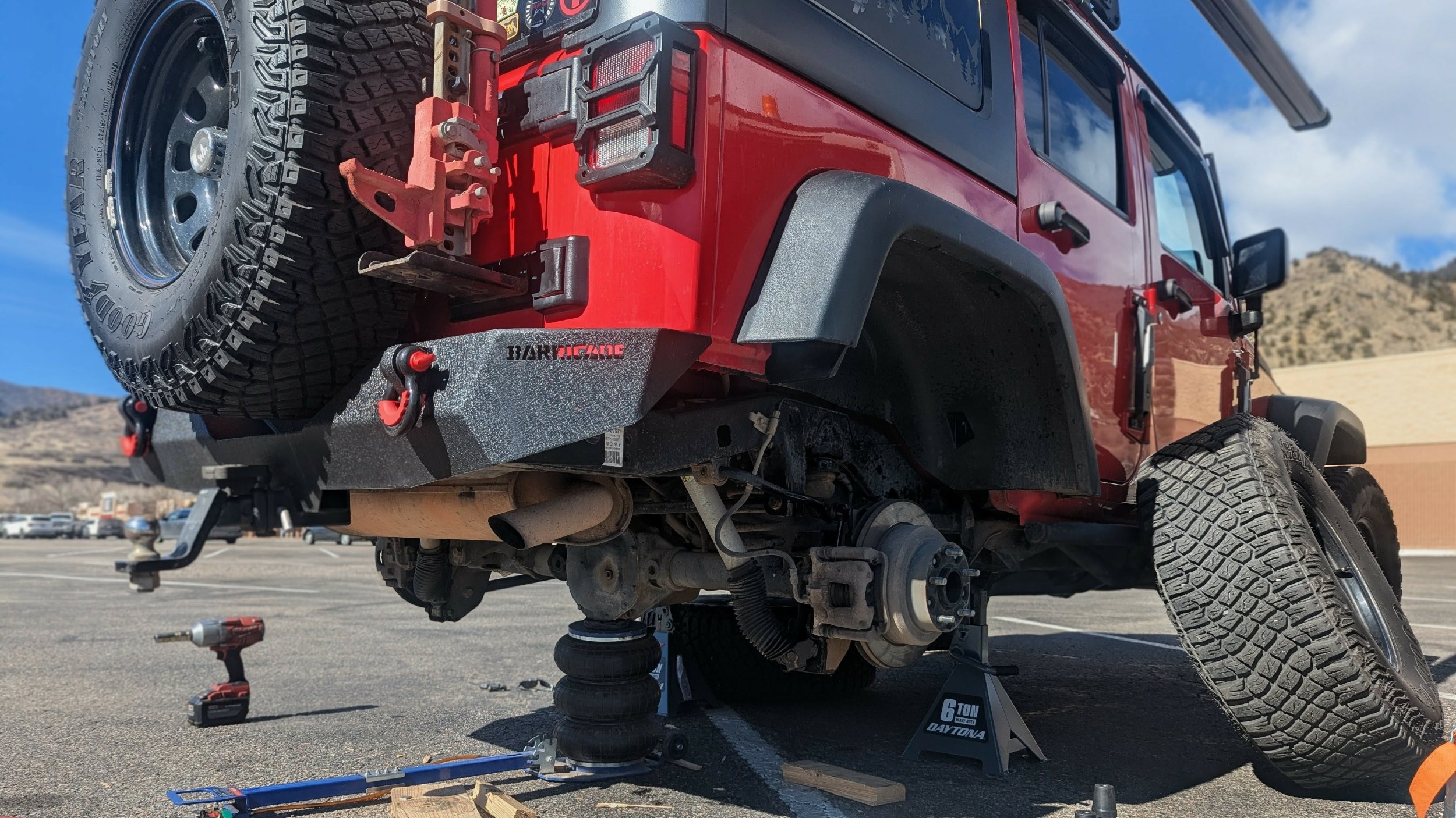

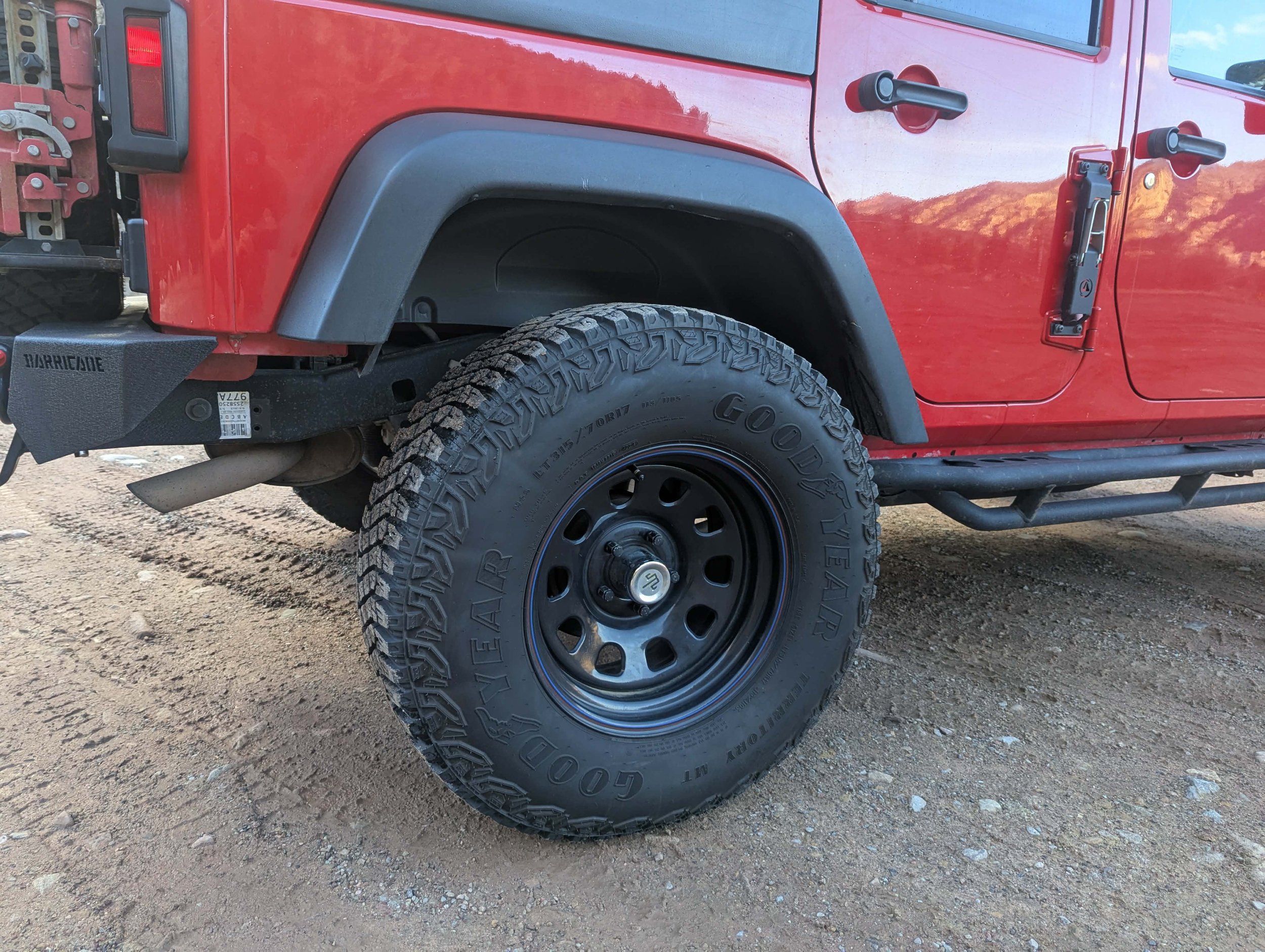

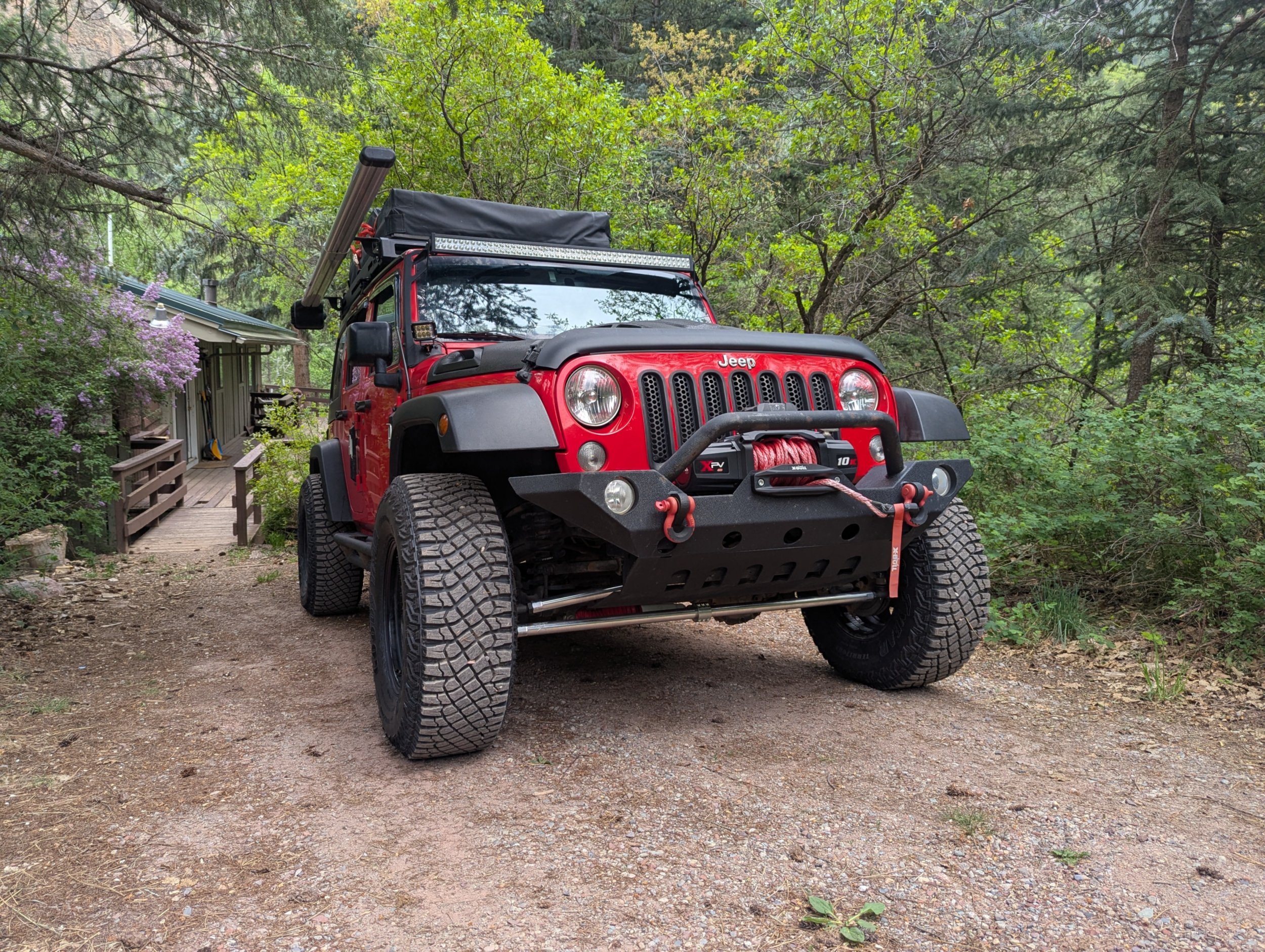

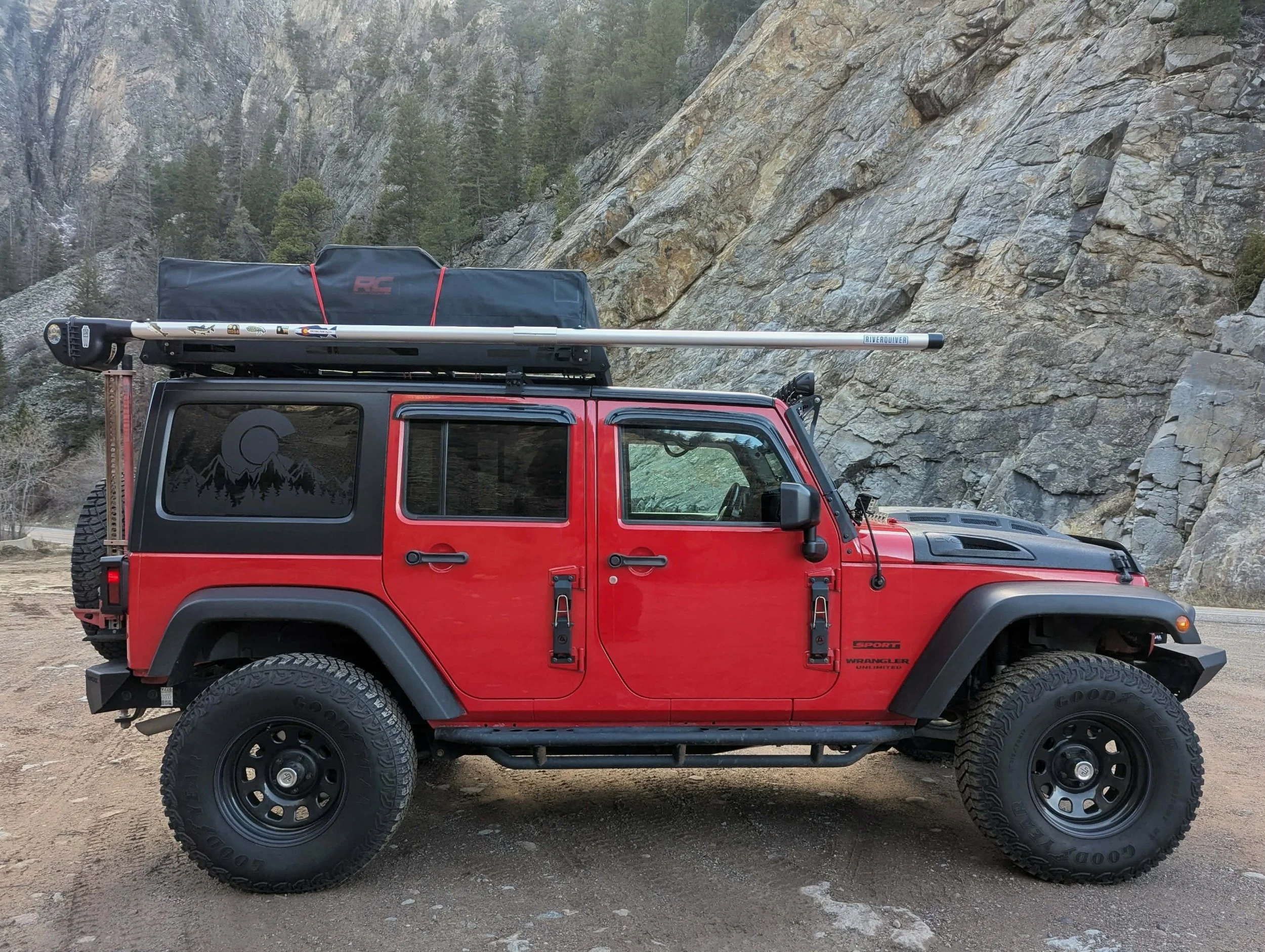

Posting a follow up just because everyone hates dead end threads. I ended up going with a 1" teraflex coil spacer in the rear and a 3/4" Rough country in the front. This gave me a little more than the origial lift gaining an aditional 1.75 inches of fender clearance in the rear and 1.25" in the front. The stance looks much better and all the sag is gone.
The only additional thing I needed was the extended sway bar links for the rear and adjustable quick disconnects for the front. The JKS brake line relocation brackets I purchased wernt necessary but I plan on throwing them on anyways.
Looks way better now!
