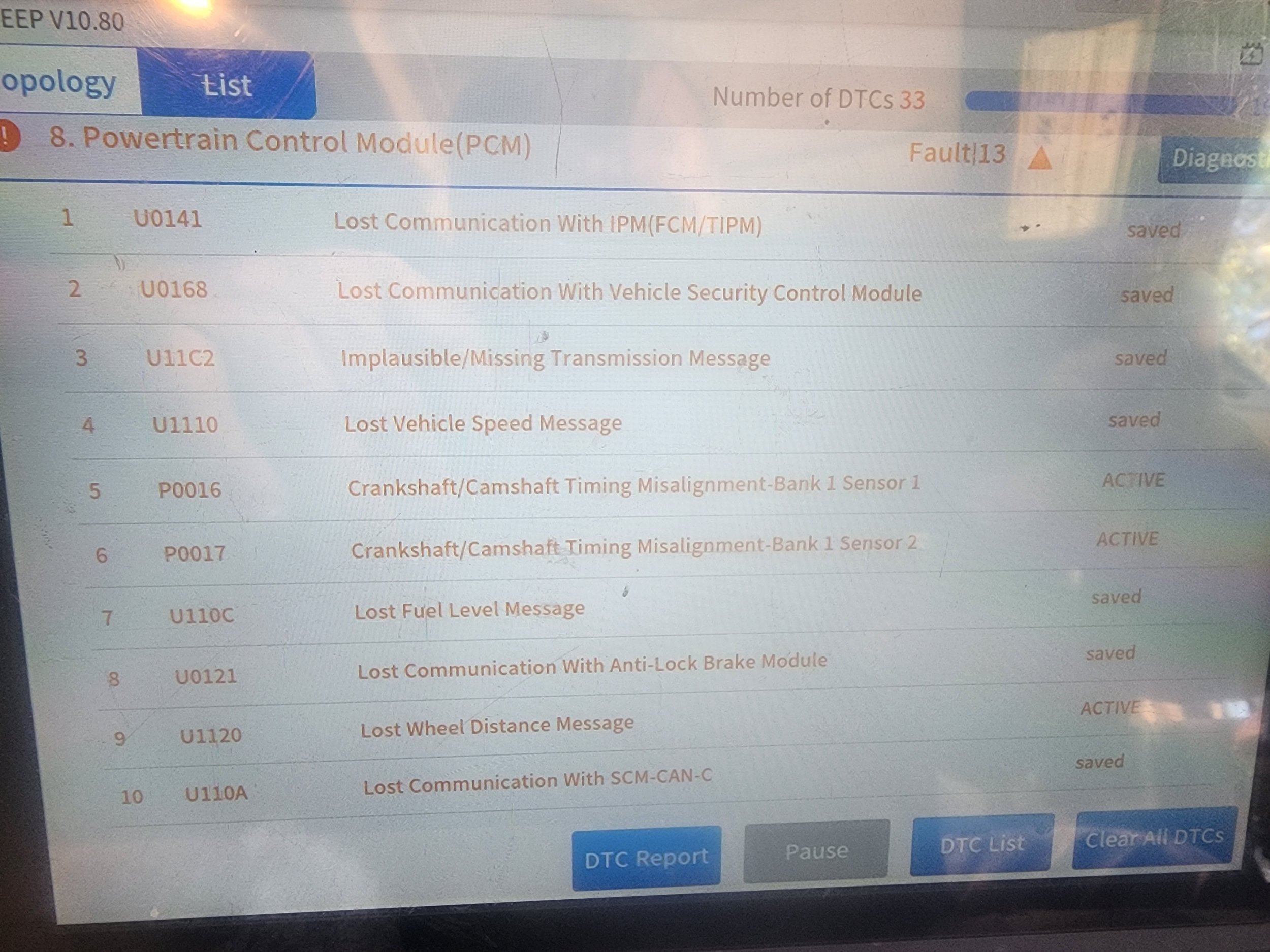

I have attached all the U codes im getting from the pcm, I did a ecm reset bu disconnecting negative terminal for about 30 min and used a jumper cable from negative disconnected to positive cable and it cleared it up for about 10 min after running then all the U codes came back on , I believe TIPM might be the culprit U0141?
It sounds like you're on the right track with your diagnosis, and the fact that the codes cleared temporarily is a good indication that there might be a communication issue, likely related to the TIPM as you speculated. The U0141 code indicates that there is a loss of communication with the PCM, which can often point towards an issue with the TIPM or the wiring between the TIPM and the affected modules.
Since you’ve already done a thorough check of your grounds and fuses, here are a few more suggestions:
  • Make sure the connectors to the TIPM are clean and secure. Any corrosion or poor connection can cause communication issues.
  • Check the wiring harness that runs between the TIPM and the PCM for any signs of damage or wear that might cause intermittent communication failures.
  • Besides the U0141, look for other codes that might provide clues about what's going on. Sometimes, codes can be related or point to a specific failure elsewhere in the system.
  • If you have access to a test tool, you might want to test the TIPM itself or consider bringing it to a professional if you suspect it has failed.
  • Sometimes there are service bulletins or recalls related to electrical issues in specific model years. It might be worth checking the dealership for any information on that.
If you decide to replace the TIPM, ensure you follow the correct programming procedures, as this part often requires programming to recognize your specific vehicle. I'd highly recommend getting your TIPM tested and or replaced with wranglerfix.com. Mark (the owner) is a highly reputable member of the Jeep Wrangler community and he has the best customer service you'll ever find (not hyperbole).
Keep us updated on your progress! Good luck, and I hope you can get to the bottom of this soon!
