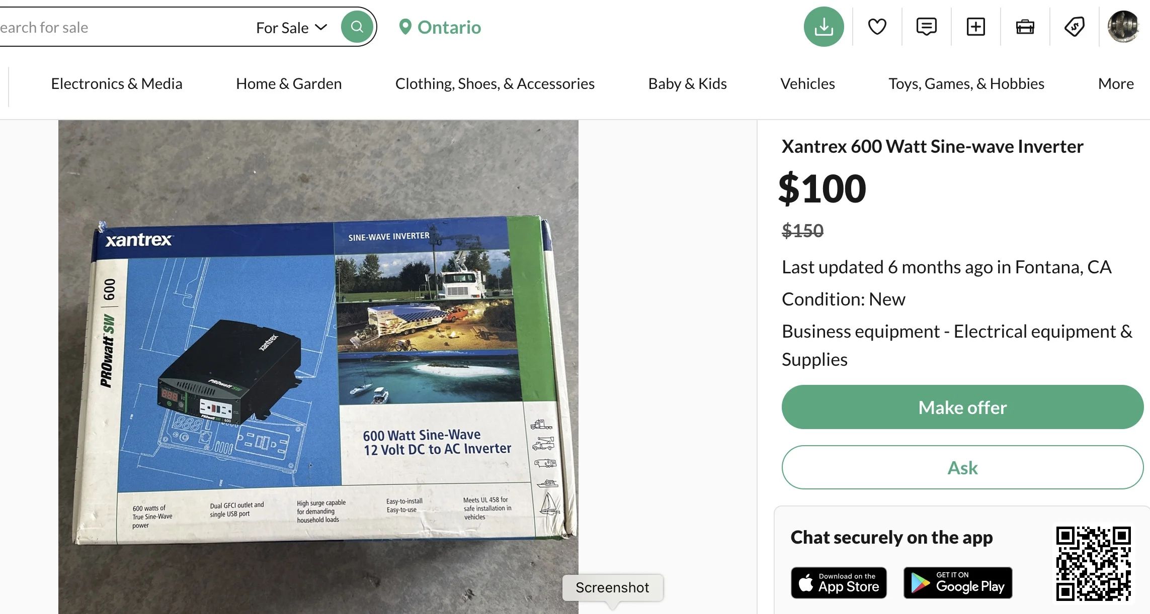

I found this on offer up, anyone used this type?
