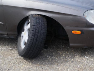

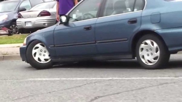

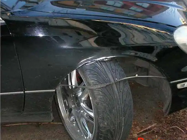

Ever seen these guys on the side of the road?
