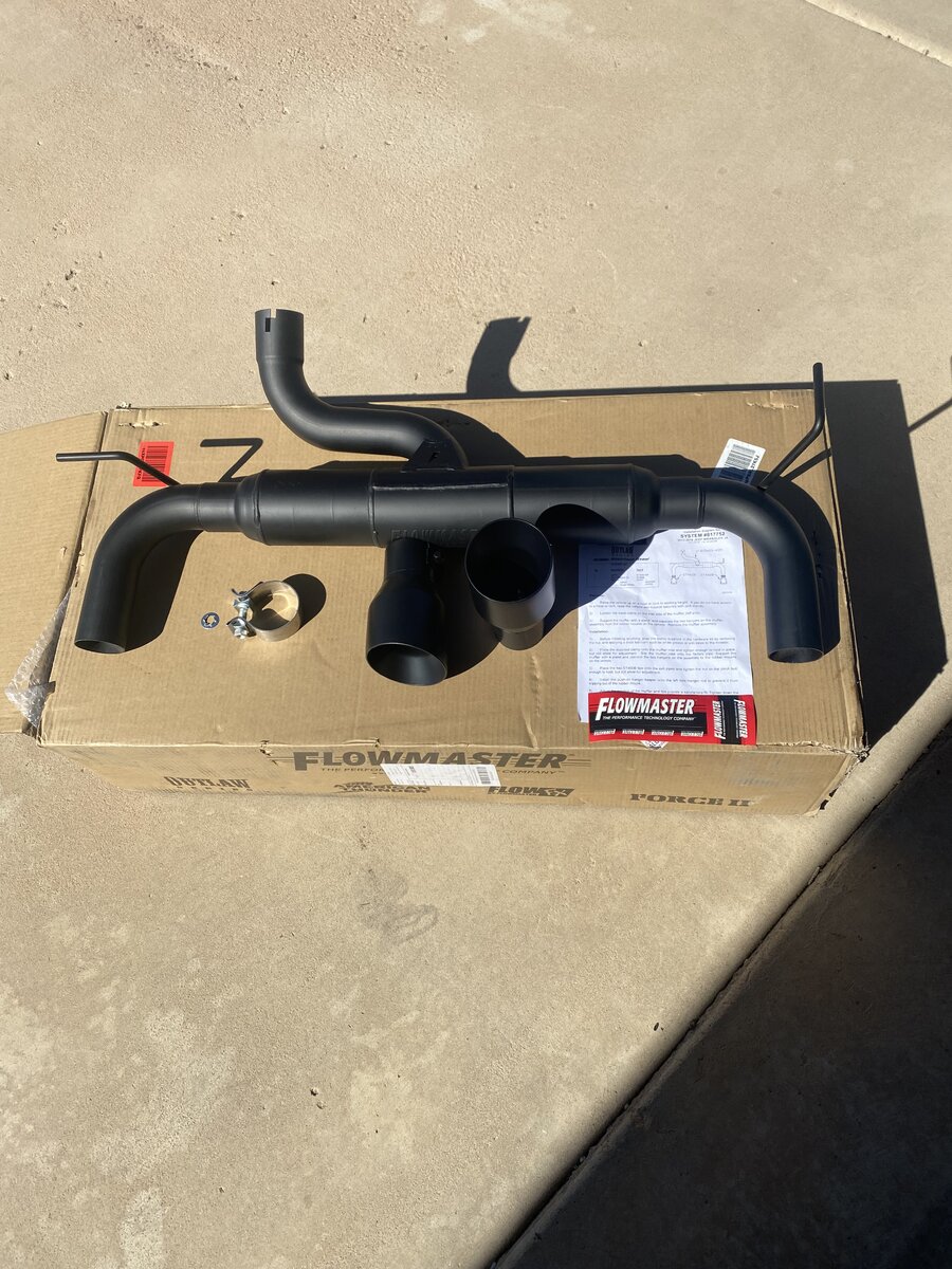

The procedure will be pretty much the same for any system, but I chose the Flowmaster Outlaw. This is an a axle-back solution, but cat-back options are readily available from many manufacturers. Let's get started.
Flowmaster includes all the parts needed, and those are pretty few. The muffler assembly, a band clamp, tips, instructions, and a bunch of stickers. Because everyone knows each sticker is worth 5HP, right? I never actually read the instructions, because Manly Men don't need directions, right?
The entire system has a nice black powder coating finish, and looks great under my black bumper.

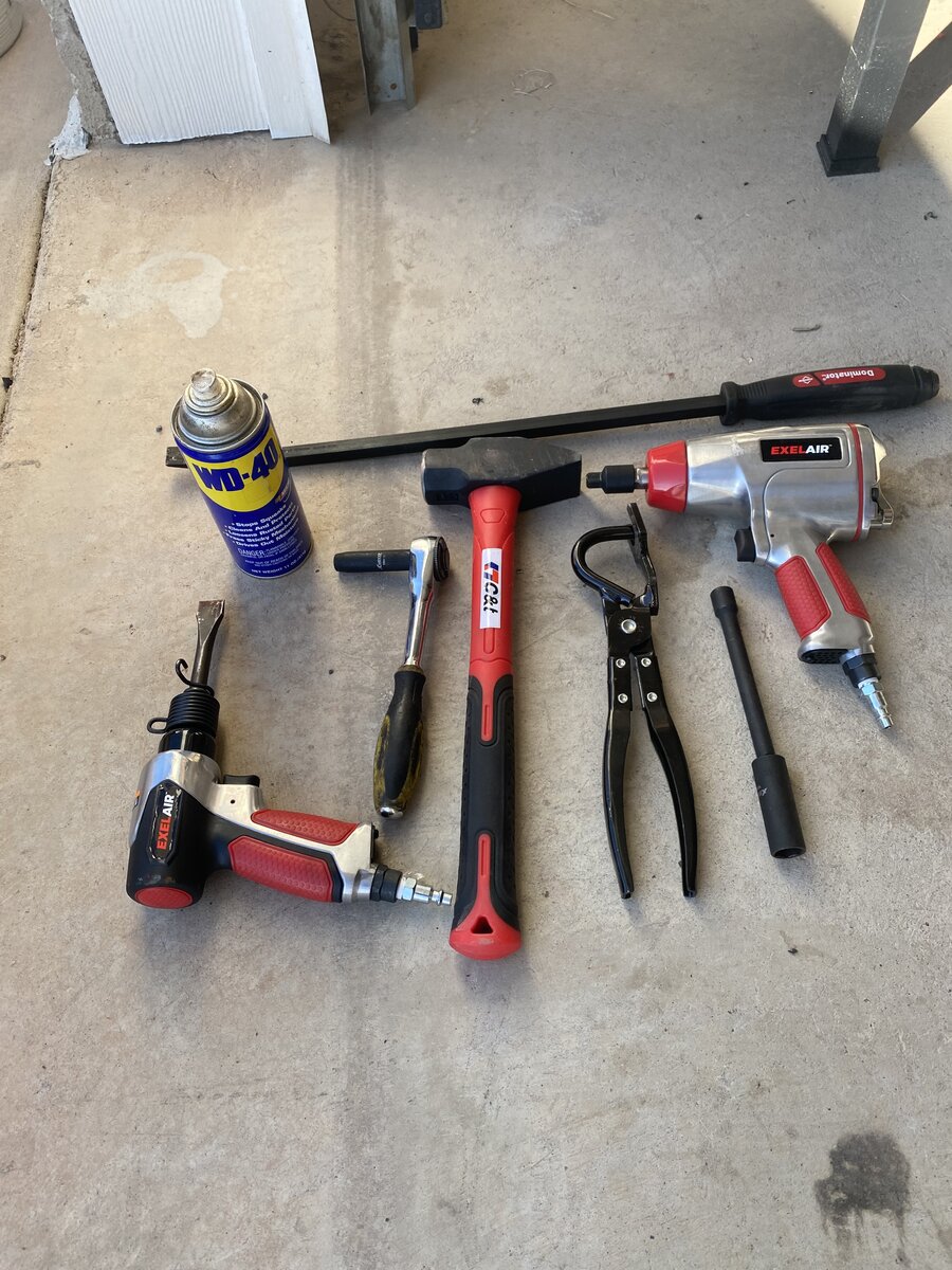

Theoretically, the only tools needed for this swap are: 16mm socket, 10mm socket, extension, ratchet, some WD-40 and a pair of exhaust hanger removal pilers. Theoretically. I'll get more into that in a minute.

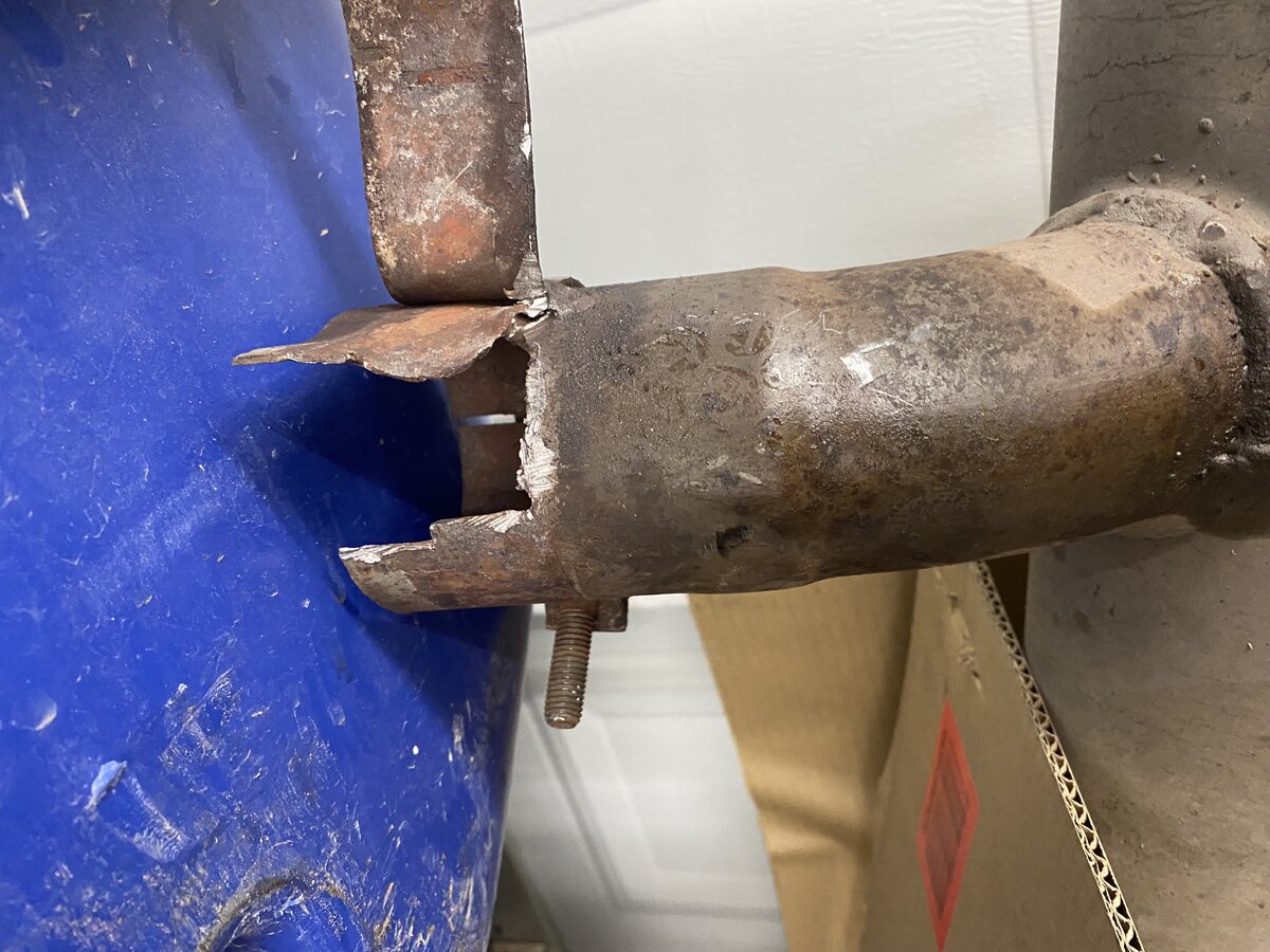

The next step is to remove the band clamp holding the muffler to the intermediate pipe. The OEM muffler connects to the intermediate pipe just after it arcs over the rear axle. It is secured with a band clamp. I had already liberally sprayed WD-40 on the area. Use the 16mm socket and extension to loosen the clamp. Oh, wait. There's 9-10 years of rust welding. That's ok, I'm sure you can bust it loose. Me, I used an impact gun. Because work smarter, not harder.
Here's where that "theoretical" tool list rears it's ugly head again.
All the videos I watched say to grab the muffler and start wiggling/jiggling/twisting and slip the pipes apart. Then they turn around and do just that. Easy. 30 second job. In hindsight, I noticed that all of those clips had a skip at about that point. This is, no doubt, where they edited out the actual getting the thing broke loose part of removing the muffler. Because 9-10 years of rust welding...
I tried the wiggle/jiggle/twist method. Yeah. That didn't do anything. I tried whacking on the muffler with a hammer. Nothing. I tried a pray bar. Nope. I whacked on it with a bigger hammer. Still nothing. I grabbed a propane torch to see if heating (expanding) and rapid cooling (contracting) the joint would break the rust loose. Not a chance. Ultimately, I grabbed my air hammer and a nice chisel and started pealing back the pipe. That worked.
The OEM exhaust has a resonator just downstream of the cats. There is a fine line between a resonator and some mufflers. So I grabbed an exhaust clip with the stock cats, resonator and intermediate pipe. A muffler delete is free, and some people like the sound.
Now on to the actual install part of our installation. Put a little anti-seize on the supplied band clamp. Place the clamp over the connecting pipe on the muffler. Now slip that over the end of the intermediate pipe. I used a wire brush to remove some of the surface rust, but I really don't think that was actually necessary. Position the clamp and snug it down. Not too tight, because you're going to want to tweak the connection to get the tips level and such. I used my 16mm socket, extension, and impact gun, but a plain ratchet will work just fine.
Now grab the tips, slip them on, and position them to your liking. This is easiest if you snug the pinch bolts. Once everything is positioned, crank down the band clamp, re-check the positioning of the tips, because they probably shifted a little. Crank them down. Use a ratchet, not your impact gun, otherwise your aftermarket exhaust might need an after-aftermarket bolt...
