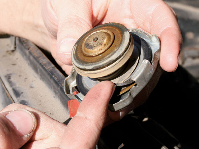

While checking the coolant level, inspect the condition of the radiator cap. Radiator caps keep the cooling system under pressure, thus increasing the temperature at which coolant will boil over. On the JK, the cap also allows coolant to travel between the coolant recovery tank and radiator as the coolant temperature changes. A faulty radiator cap can allow the coolant to quickly boil over at lower temperatures or prevent the coolant in the recovery tank from returning to the radiator. Inspect the rubber seal; if it is cracked, split, damaged, or missing, replace the cap.

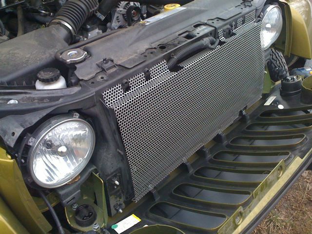

The efficiency of the radiator and electric cooling fan can be greatly reduced by mud, dirt and debris and also lead to engine overheating. JKs that see any kind of off-road duty can easily ingest mud, dirt, and water through the front grille. The cooling fan, fan shroud, and radiator can become packed full of muck and not only reduce cooling system efficiency, but also cause the fan motor to bind-up and quickly fail. The electrical fan on all JK models has been known to be quite fragile and is regularly the cause behind cooling system issues. Clean the radiator and electric fan as necessary. If the fan does not operate, or works only intermittently, refer to the related article below for fan diagnosis.

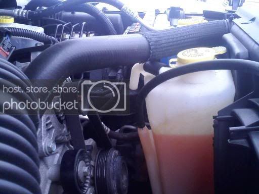

In order for the cooling system to properly operate, there has to be a sufficient amount of coolant in the system. Coolant circulates throughout the engine and absorbs engine heat via heat transfer. The warm coolant passes through the engine and eventually makes its way through the radiator where it is cooled before being sent back into the engine. Surprisingly, many owners fail to regularly check their coolant level and, as a result, may experience engine overheating. While a low coolant level may be an indication of a larger problem in the cooling system, a lack of coolant circulating the system cannot adequately absorb the heat produced by the combustion process and can quickly lead to engine damage.
With the engine cool to the touch, remove the radiator cap and inspect the coolant level. Fill the radiator until full and top off the coolant recovery bottle (aka coolant overflow tank) to at least the minimum fill line. The radiator and recovery tank can be topped off with distilled water; however, a 50/50 coolant mix should be used if a relatively large amount of coolant needs to be added.

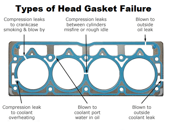

Step 5 – Check for leaking head gasket
The head gasket fits between the cylinder head and engine block to seal off combustion, oil, and coolant. While a head gasket can fail in a variety of ways and cause numerous problems, failure of a head gasket between a combustion chamber and water jacket can cause engine overheating. More often than not, head gasket failures on today's alloy engines are caused by a previous overheating incident that allows the cylinder head to warp and prevent the head gasket from properly sealing. Unlike most other cooling system components, a leaking head gasket cannot be visually examined without disassembling the engine. That being said, there are several signs that may indicate that your JK has blown a head gasket.
- White exhaust smoke
- Bubbles or excessive pressure in the cooling system
- Loss of coolant without any noticeable leaks
- Coolant mixing with engine oil (milky oil)
Figure 8. Types of head gasket failure and associated symptoms.
