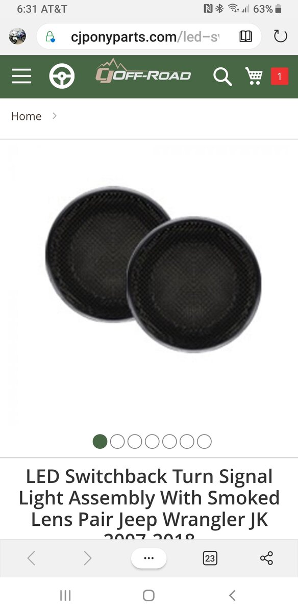

Mrriverajr Member Joined Apr 4, 2020 Messages 41 Location 07660 May 20, 2020 #1 Anyone uses these ? If so where does the red wire go ? https://www.cjponyparts.com/led-switchback-turn-signal-light-assembly-with-smoked-lens-pair-jeep-wrangler-jk-2007-2018/p/ML22/?utm_source=Pony&utm_medium=Email&utm_campaign=OrderConfirmation&lac_guid=6b53a3a9-8a91-ea11-8348-0050568938fc
Chris Administrator Staff Member Joined Sep 28, 2015 Messages 32,367 Location Florence, AZ May 20, 2020 #2 The red wire would get tapped in to one of the running light wires so that the halo ring comes on when you turn on the parking lights / running lights.
