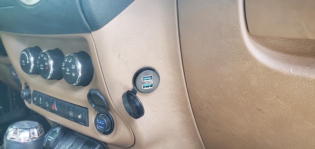

also added a dashcam hardwired and decided to go ahead and add quick USB ports so i don't need to reach into the glove box to connect to Carplay or android auto. it also connect perfectly with my ODB2 sensor so i have real time data with Torque PRO and Jscan on the go.

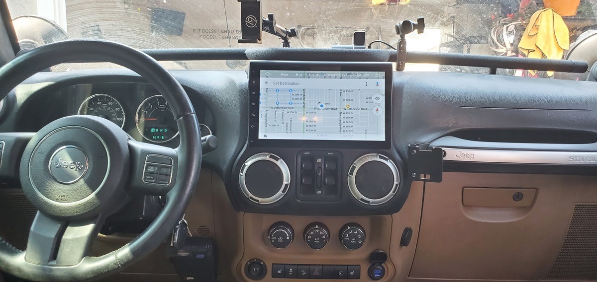

Honestly so far, I'm extremely pleased. tried everything and everything works, up to the steering wheel controls.
all in all it took me 2.5hours with cleaning. a good 30mins was hacking the harness.
finished product:
the USB connections (bottom is for Android auto/Carplay and top is to add storage, usb drive..etc.....)

screen is beautiful and really responsive.. it is NOT waterproof though, none of the connections are sealed.
finished product:
