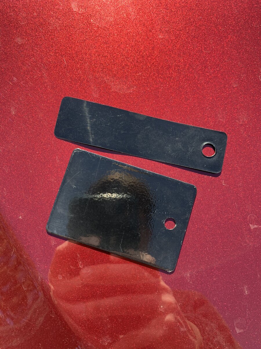

Finally got my Poison Spyder Crusher Fender Flares on order and once they arrive, I will be getting them powder coated black to match. The question is, do i just go glossy black or do i get the glossy black and have them clear over it? I worry that there may be too much orange peel with them glossing over it, but wonder if the clear over the powder coat adds more protection...
Does anyone have experience getting orange peel out of powder coat? Can that even be done? If it can't, I will ask them not to clear over the glossy black. I will attach a picture of both samples . The larger is with clear over glossy black and has a ton of orange peel.
*side note: the fenders won't be scratched like these samples, These were getting tossed around in my jeep and I even took a key to the larger sample to see how strong it is. lol
Orange peeling normally occurs due to some external factor- most of the time dealing with either the outside air temperature or the temp of the working surface. It can also occur as a result of the coating process applied at too high a pressure. Other factors include the working surface not properly prepped, or the use of chemicals to prep the working surface have caused some pitting or created an uneven surface. Personally, I'm not a fan of the clear coat because it tends to show off the orange peeling a little more.
