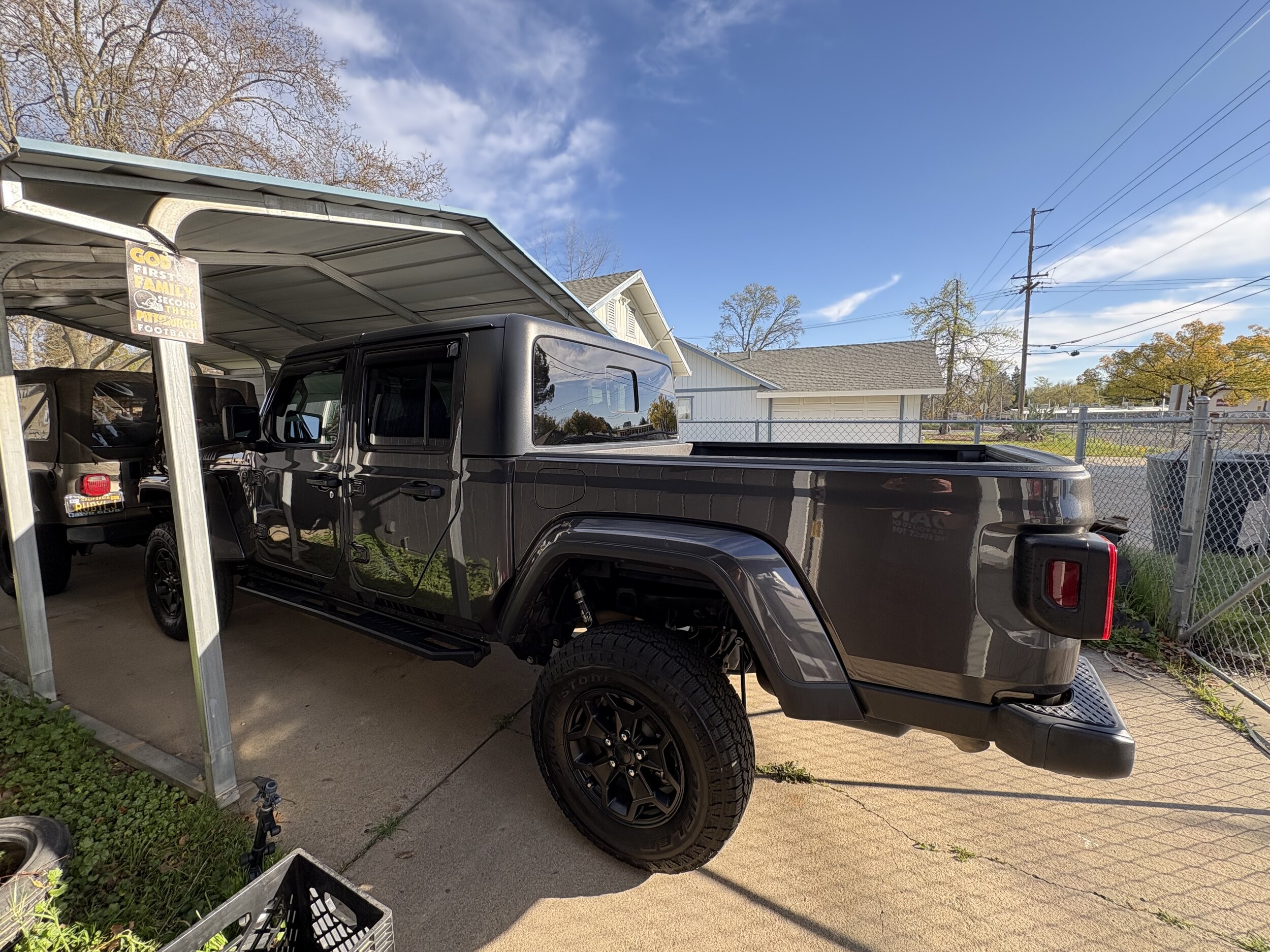

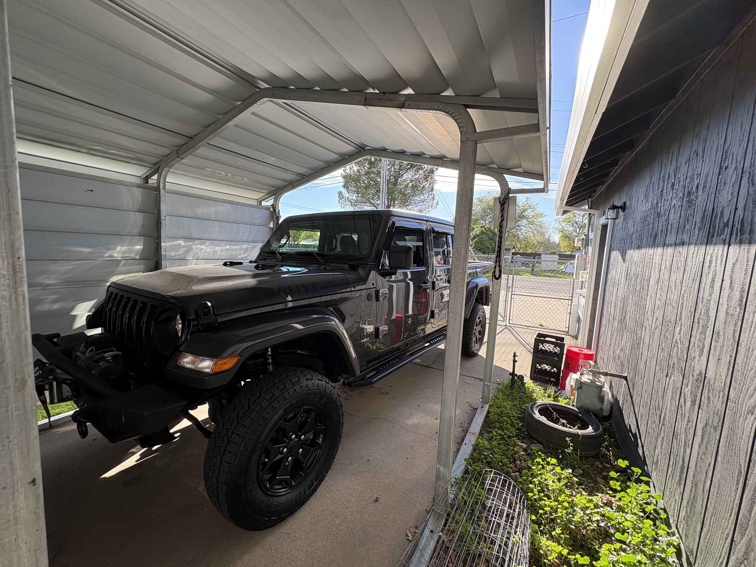

Didn’t think I’d go this route. After talking to a few people and one guy who mods and works on 4’s we ended up getting a Gladiator yesterday. It’s a 2021 with 31K miles. It has the tow package, it’s clean. Outside of the tow package it’s pretty basic down to manual windows and door locks. It is the 8sp automatic. It sure picks up speed a lot faster than the JK. Drove it back over an hour from the dealer, it sure has a smooth ride.
Based on my research it has a 2.5” lift which is EVO. I don’t know much about EVO, but the lift appears to be installed right from what I can tell. Has the bolt markings on it, changed out the brake lines to braided steel lines, etc. They installed Fox shocks on it.

Nice! Wheelbase definitely has a large impact on ride. Sounds like the 8sp is a nice addition on the JL/JT.
So are you getting rid of the JK or keeping both?
