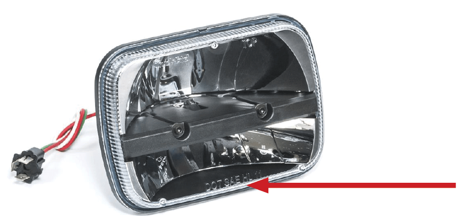

In the US and Canada, lighting products are certified by the lighting manufacturer as compliant, and unless the certification is "clearly erroneous," the certification will stand. The reputable manufacturer will state that its products are "designed to conform" to the elements of the FMVSS-108 requirements.
Some of the misuse of terminology stems from the fact that there are three products that must be marked with the "DOT" symbol: headlights, replaceable bulbs for headlights and reflective tape.
