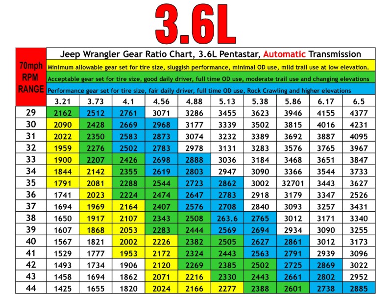

You're in Texas flatlands and have a 0.83 OD ratio. Seeing how the 3.6L is powerful enough to manage moderate hills and headwind, many are happy with 4.56's with 35"s. However, if it were me I'd go with the 4.88's (actually I'd probably go 5.13's b/c ~2860 RPM at 70 MPH is quite smooth still and I'm in the "Endless Mountain" region of the northeast).

Ok, yea thanks, we are on the same page. I did not look at 5th gear as OD. All good, thank you. So on your chart either 4:56 or 4:88's would work for either tire size in the blue performance band, but I slip into green on the 35's with 4:56. That would be in line with what I am being told, then.

4.88's would keep you in the "blue". I always err on the "blue side" of gearing, as the Wrangler is essentially an aerodynamic "box" driving down the road and the engines all benefit from some additional torque multiplication.
