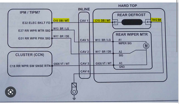

Where does the defroster grid get grounded? Have a short to ground and want to trace the ground. Is it the thicker black wire in the connector where the blue/white wire is power? Thanks
Where does the defroster grid get grounded? Have a short to ground and want to trace the ground. Is it the thicker black wire in the connector where the blue/white wire is power? Thanks. 2016 JK Sahara
