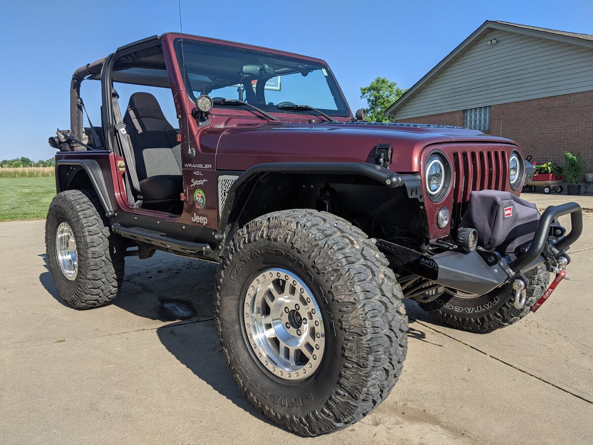

Here is a picture of my TJ "The Sienna Peral" and my newest project JK "Detonator".

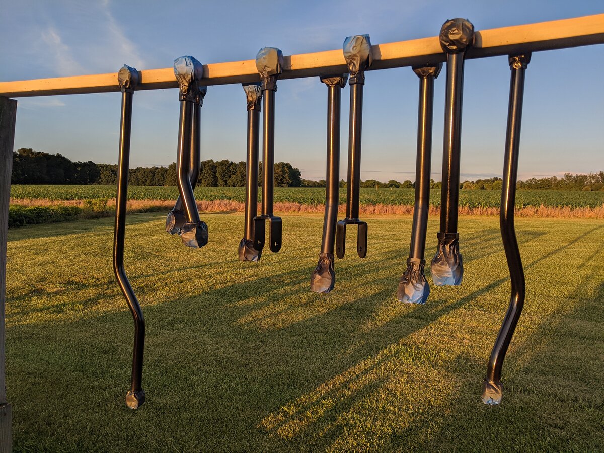

I opened up the boxes to the Metalcloak lift this weekend. I figured I would give some of the components a little more protection. I sprayed them with some black paint. I'm guessing I'm still a couple months away from having this put on, but I figured I would get them prepared.

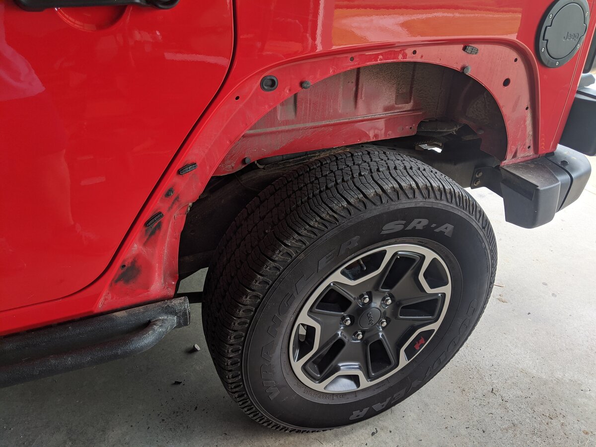

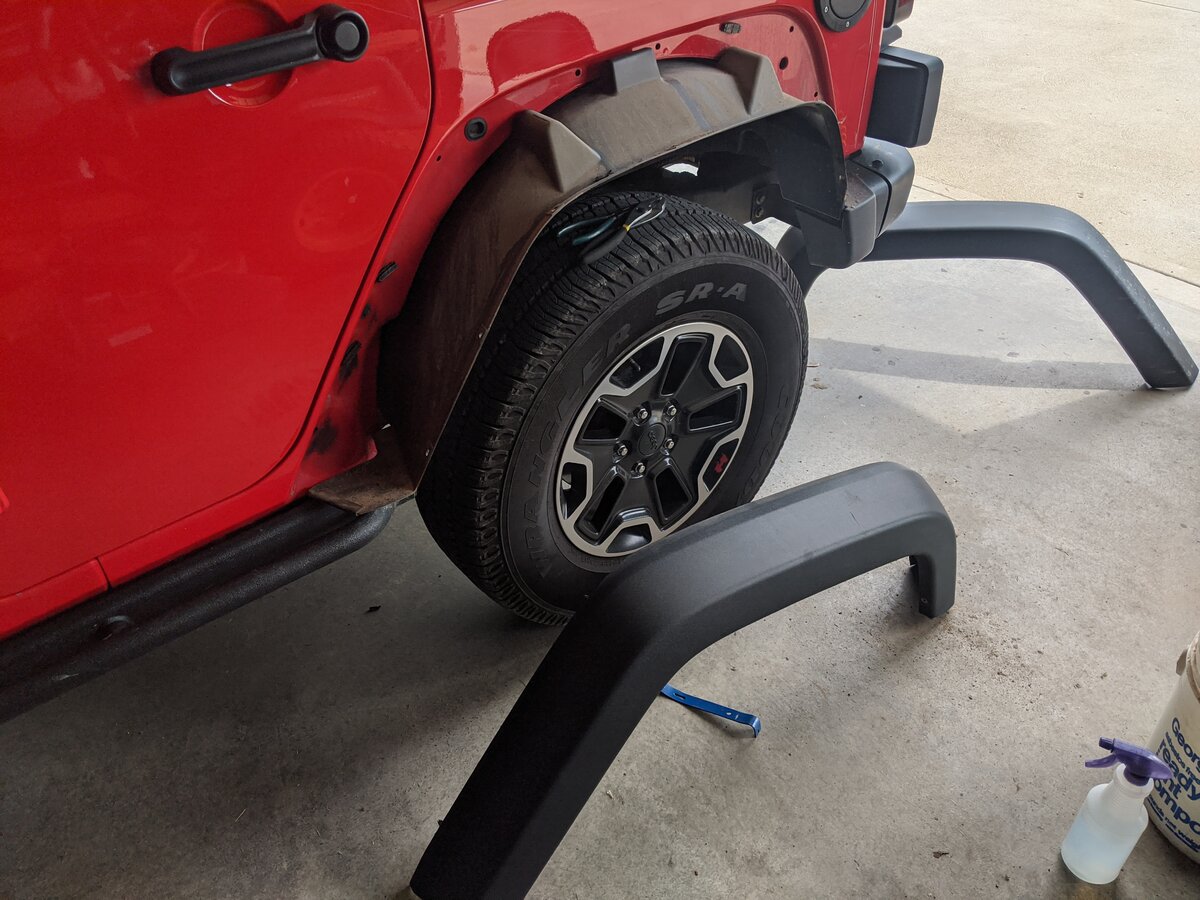

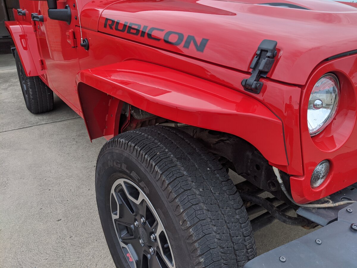

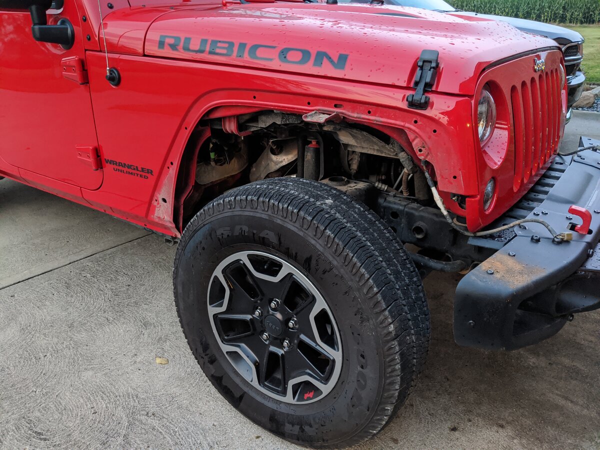

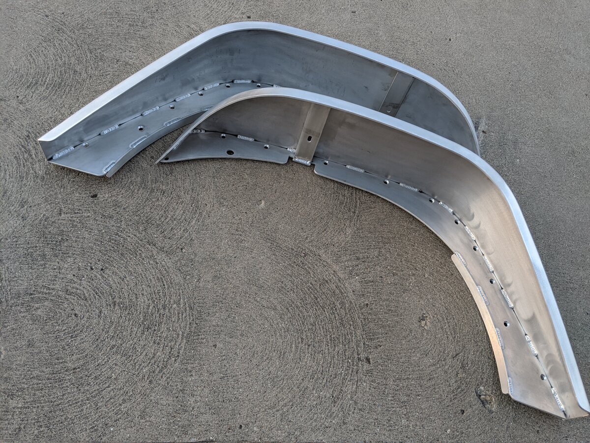

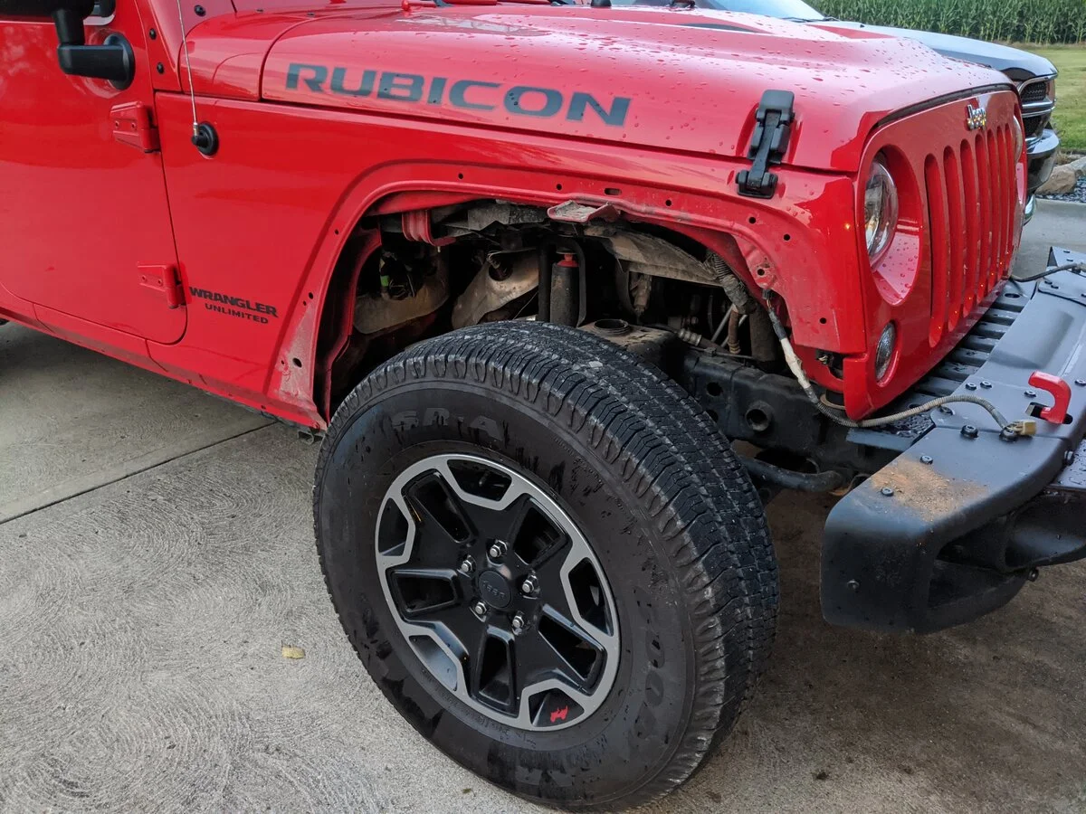

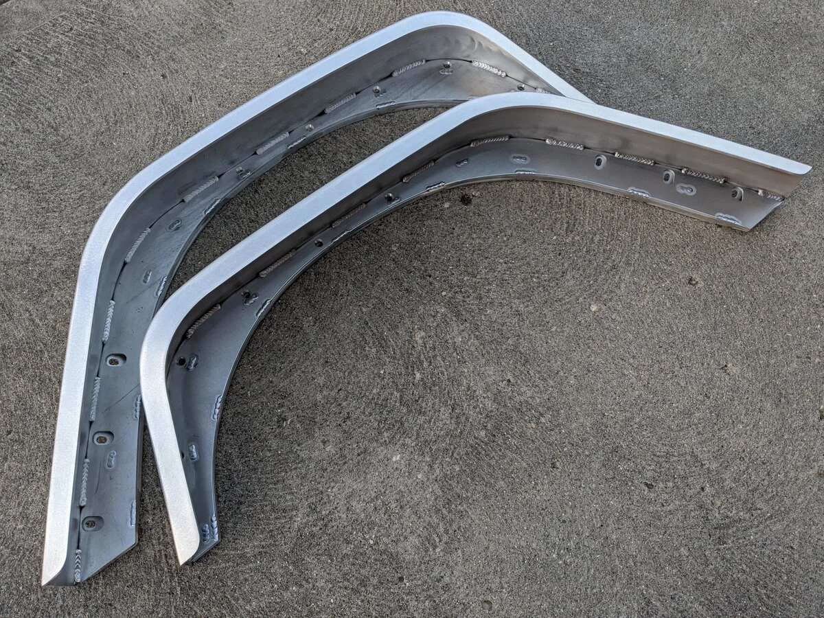

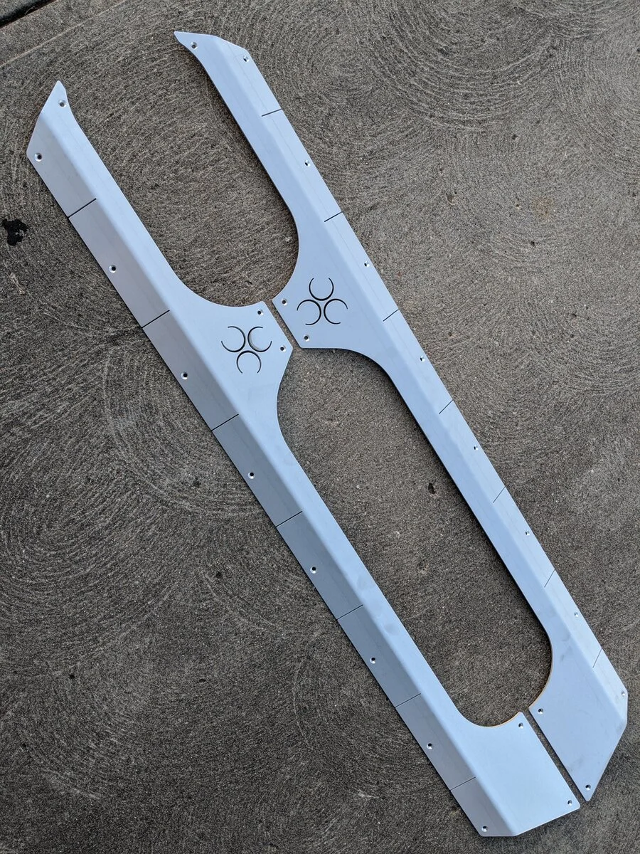

I had some more parts show up this weekend! Nemesis Industries Odyssey front fenders, Notorious Dovetail rear fenders, and their Titan Tub Armor as well. Looks like I need to start getting to work. I have a busy week ahead, but I'm hoping to get these fenders installed by the weekend. I'll then remove them and I'm going to have them color matched. I can't wait to see the final installation.

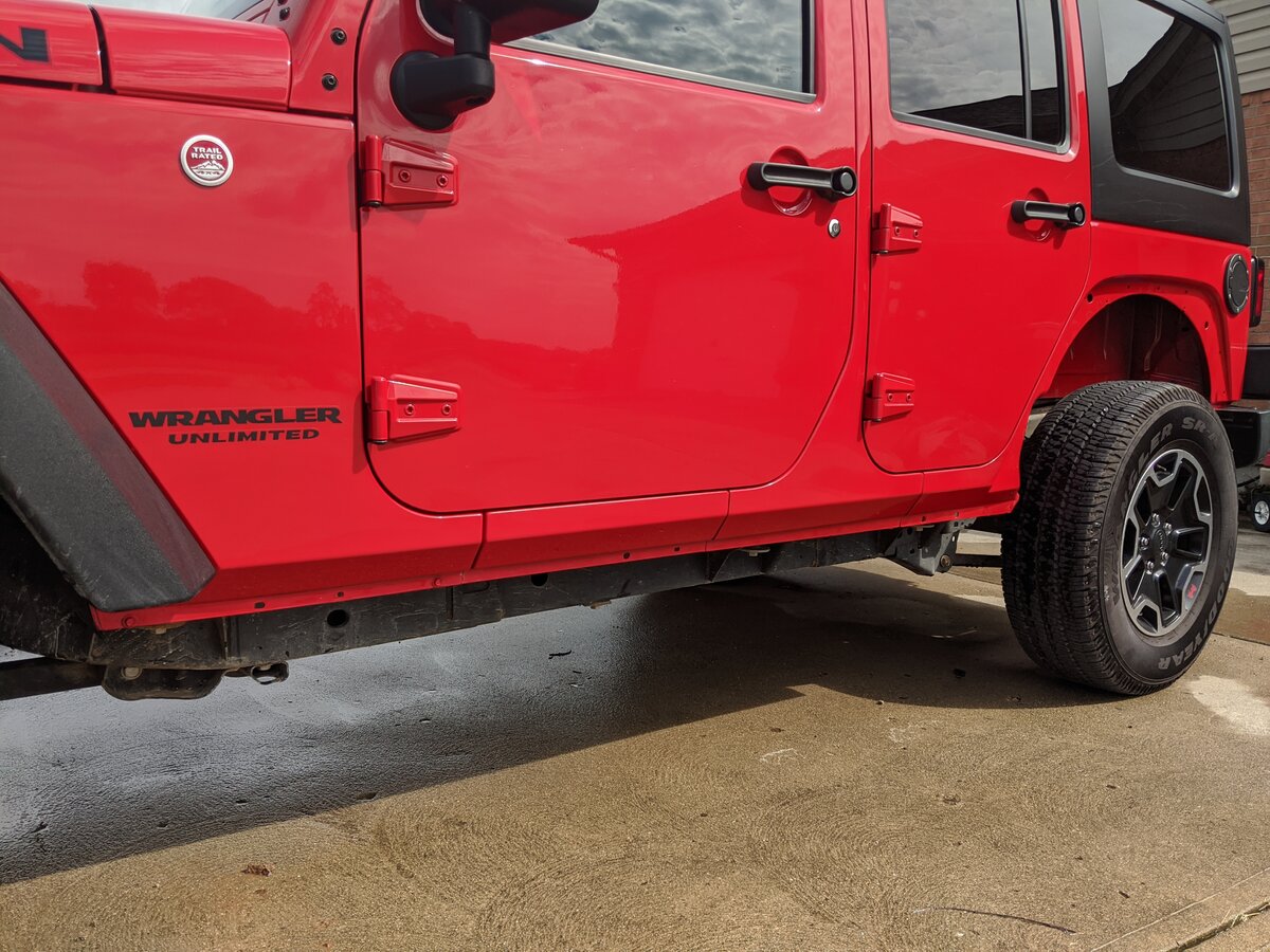

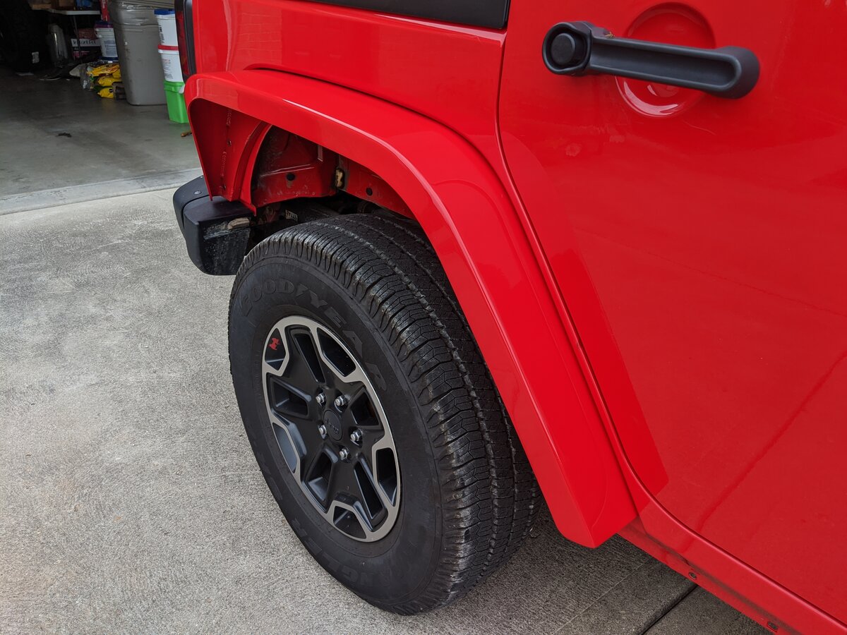

Took the Nemesis flares to a local body shop. They color matched them for me. Picked them up a couple days ago. Finished the install last night. Now my current tires look really small. I will also address the fender well area in the future. I prefer black inside my fender wells.
I also removed the OEM sliders. I color matched the Nemesis tub armor too, but those still need to be installed. Now I'm saving up for some Rock Slide Engineering sliders with steps to help the wife out. I figured I would install the tub armor when I get the sliders.

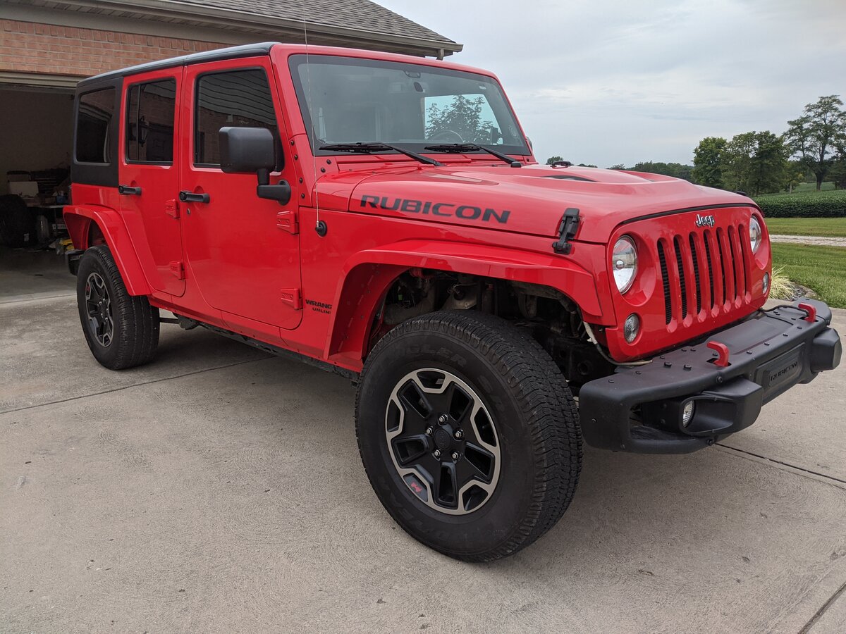

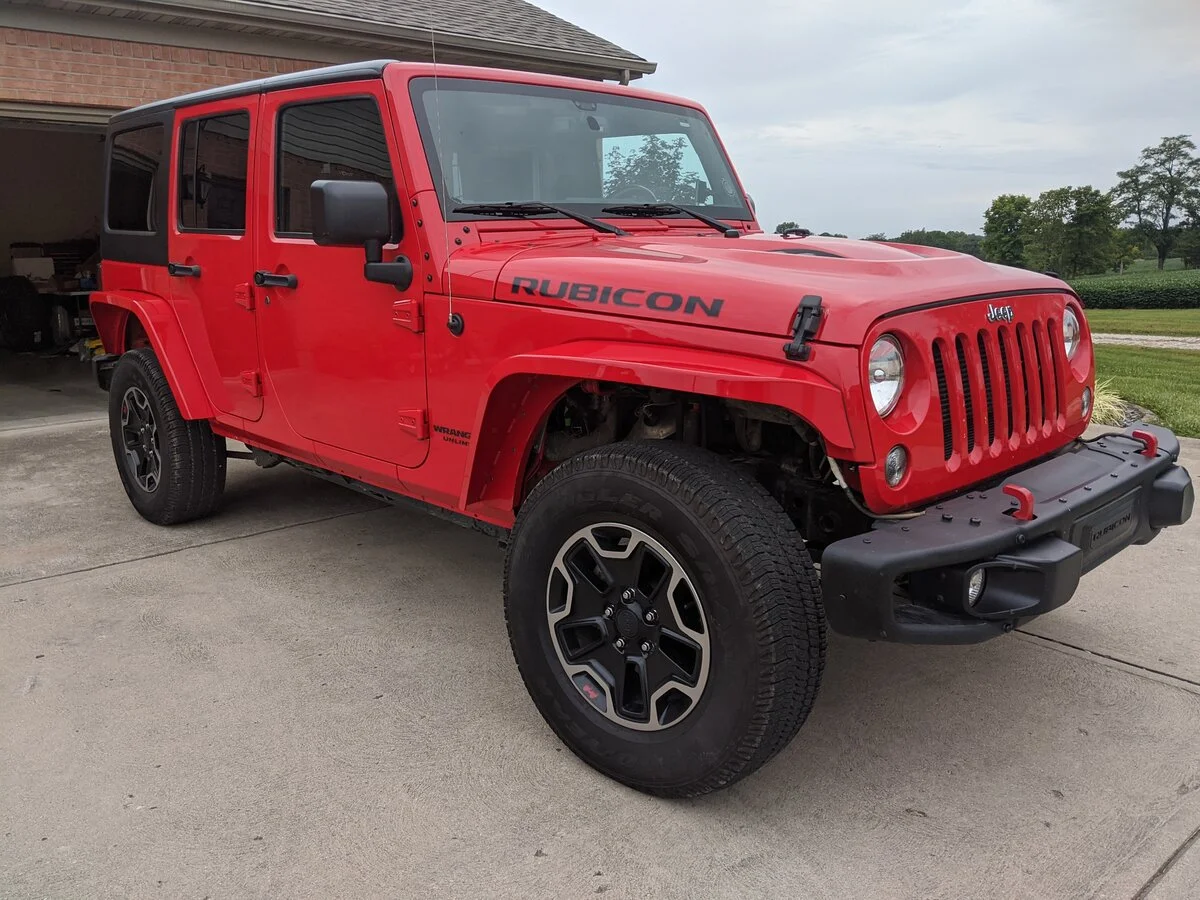

I made an appointment to have my lift installed. Supposedly the week of September 21st. One more month before I mount my new 37's. I can't wait! Anyway, here are a few progression pictures.

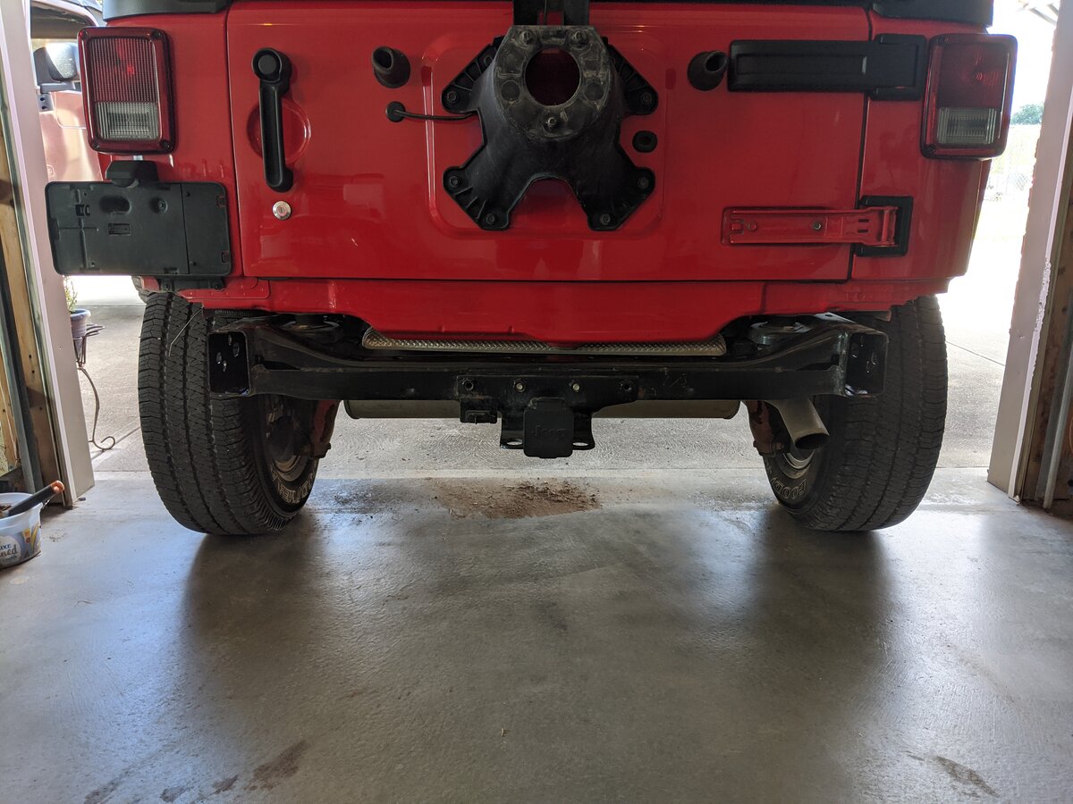

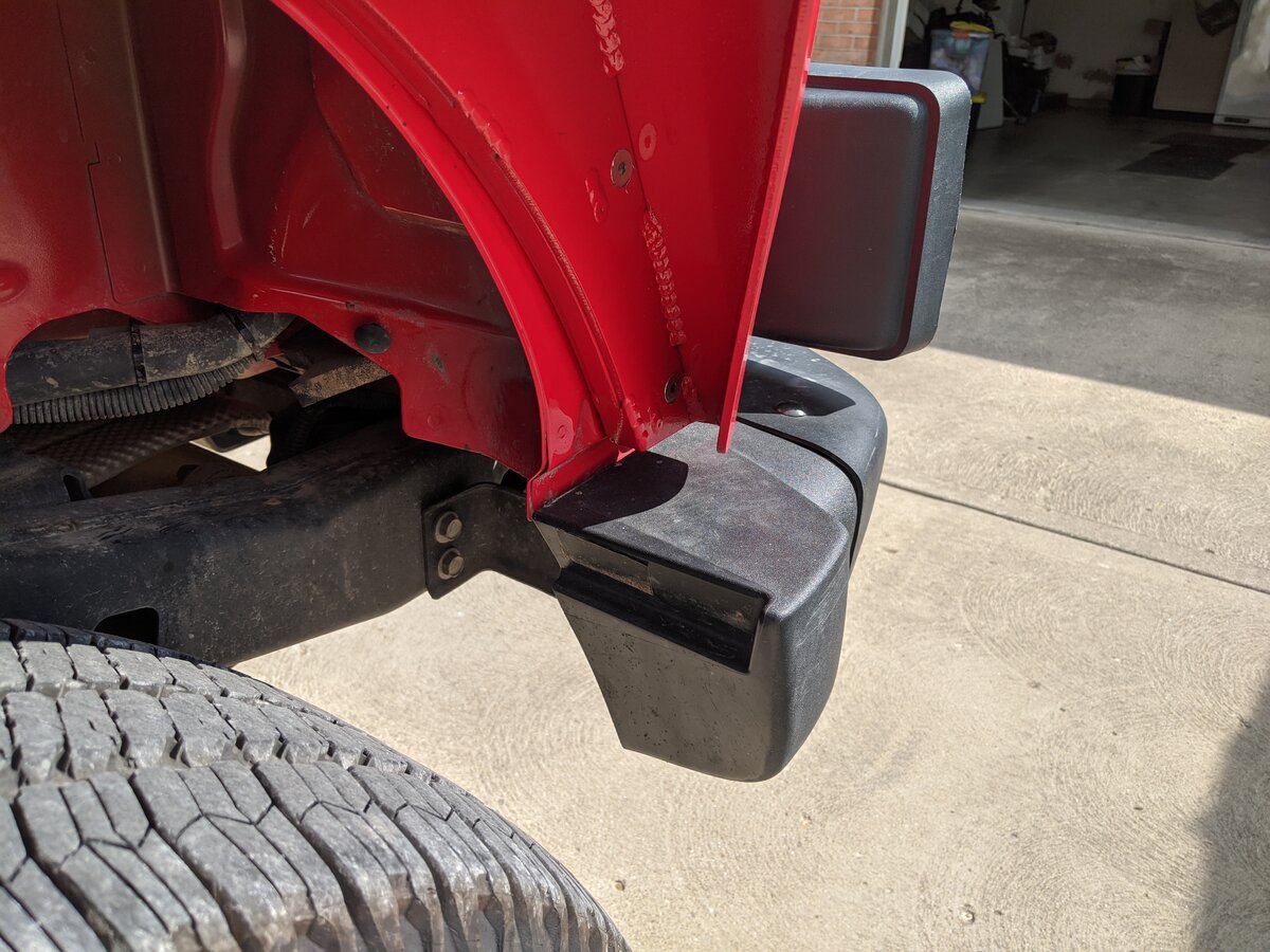

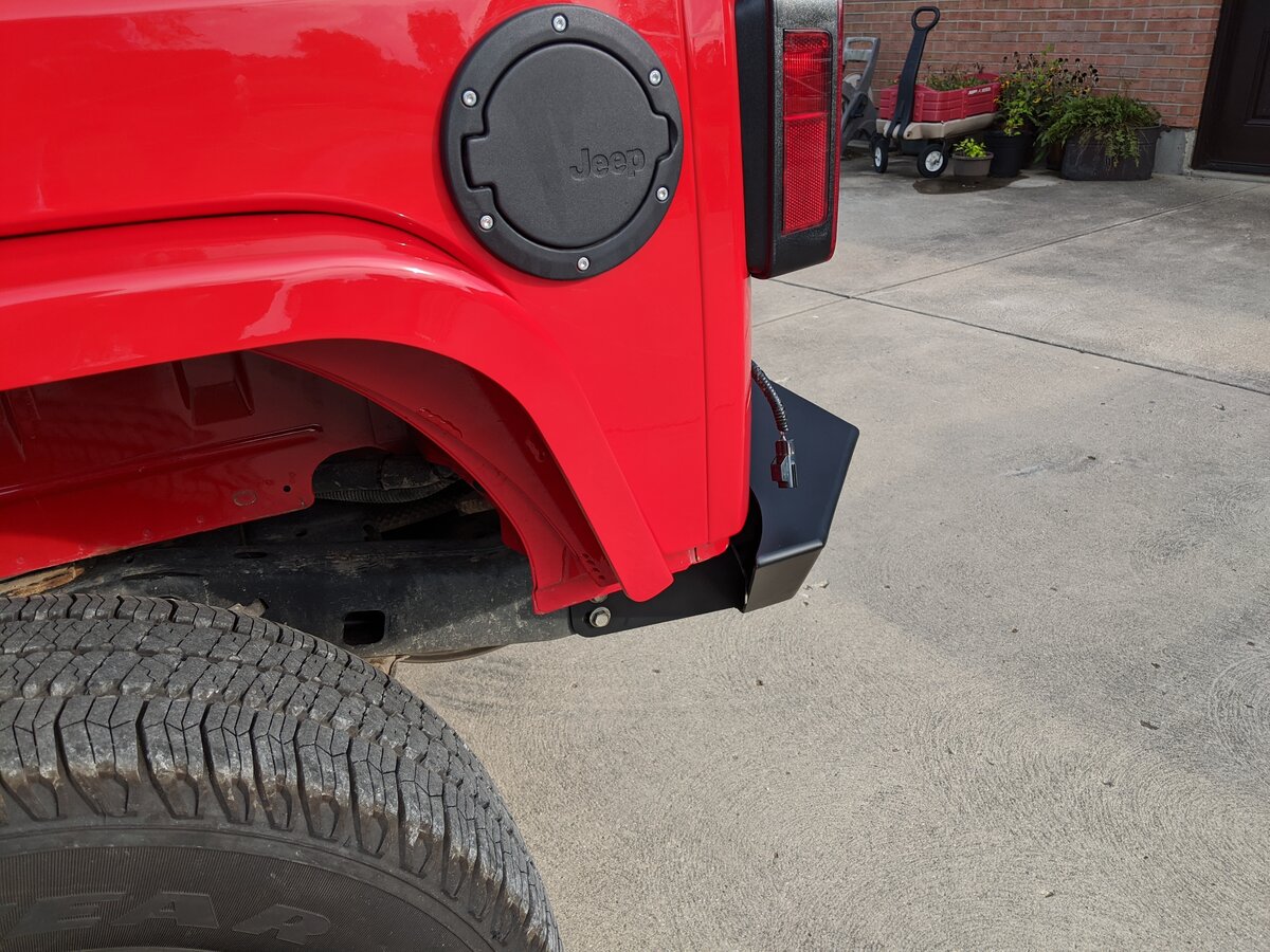

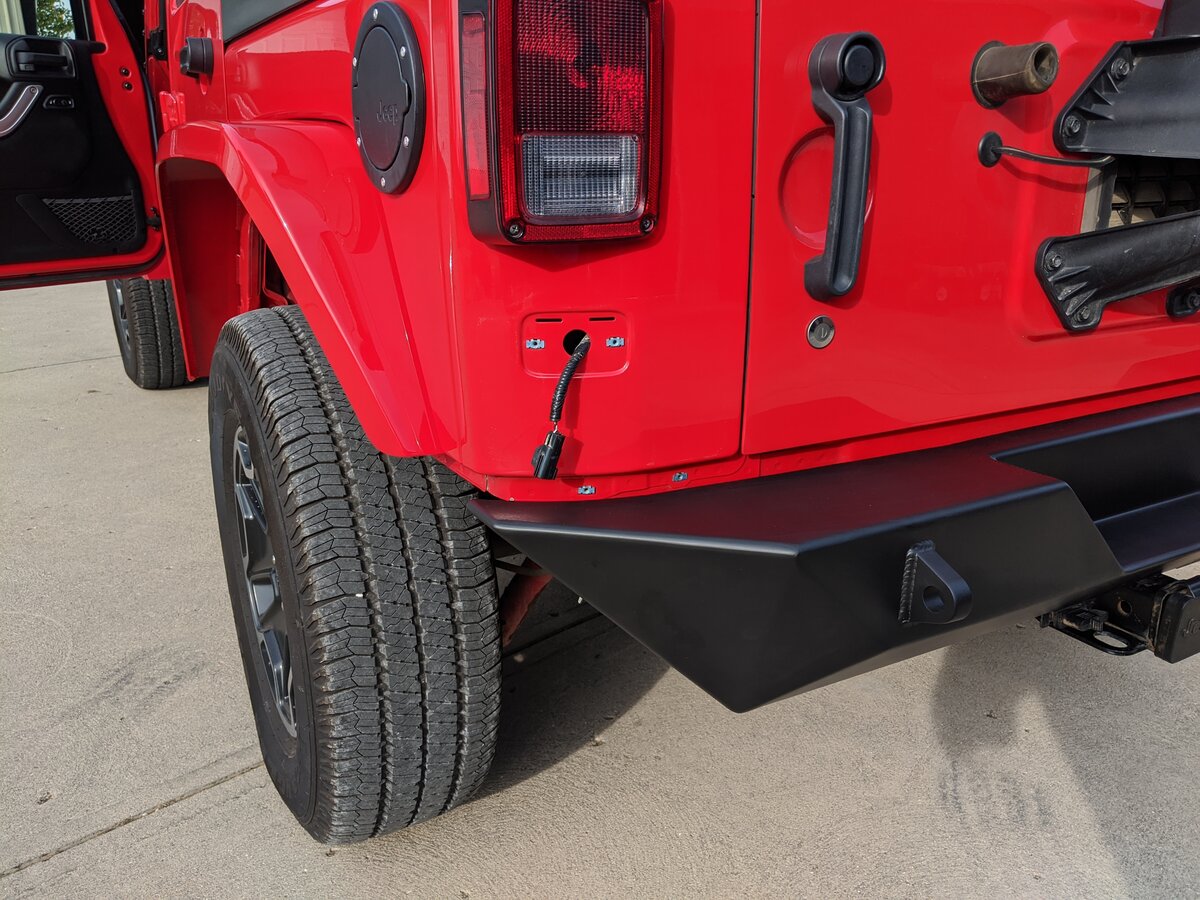

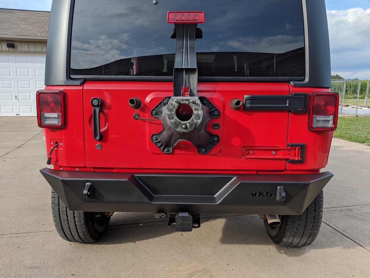

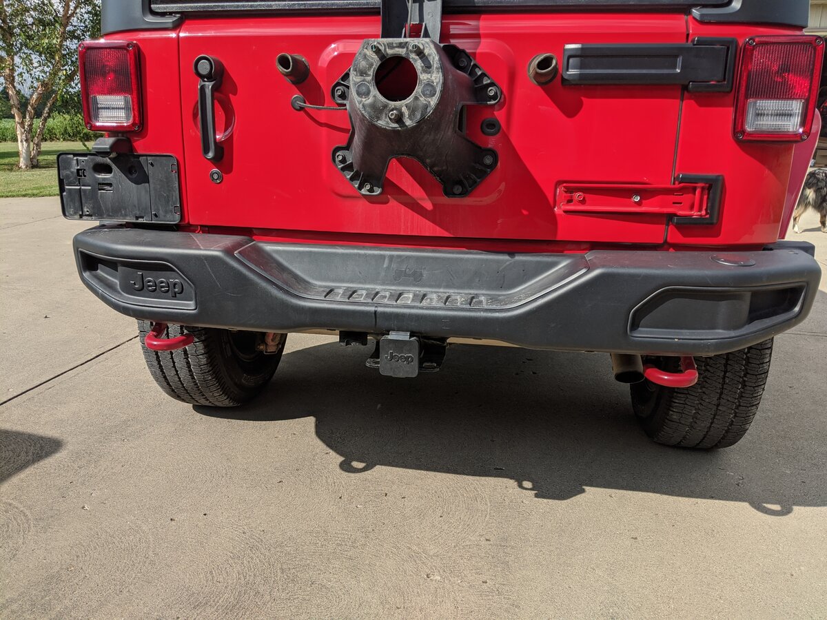

With the dovetail rear fender flares I knew I wasn't going to like how the stock rear bumper stuck out past the sides. It's a shame because I really like the look of the stock bumper. I ended up purchasing a VKS rear bumper to replace it. This allowed me to retain my factory hitch. I had a friend talk me into finishing it with cerakote. I had no idea what that was, but I let him do it. It turned out pretty nice. We will see how it holds up. Here are a few pictures from tonight.

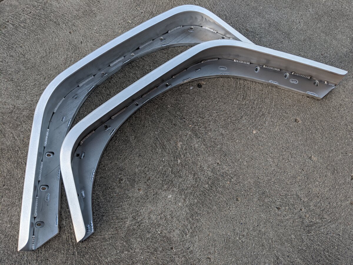

Those are interesting fender flares. Can't say I've ever seen them before. Are they metal or plastic?
These flares are aluminum. I was between Poison Spyder, Genright, Metalcloak, and Nemesis. I am wanting to keep most addons down in weight, so I knew I wanted aluminum. I have Metalcloak on my TJ and Poison Spyder and similar designs seem a lot more prevalent. The Nemesis flares won out. I admit they look kind of silly right now. I'm hoping its just the stock wheel backspacing and the seriously wimpy tires. I'm praying when the KMC Machete beadlocks and 37" Toyo Open Country MT's go on I will be happy with my decision! Find out in 3-4 weeks...
These flares are aluminum. I was between Poison Spyder, Metalcloak, and Nemesis. I am wanting to keep most addons down in weight, so I knew I wanted aluminum. I have Metalcloak on my TJ and Poison Spyder and similar designs seem a lot more prevalent. The Nemesis flares won out. I admit they look kind of silly right now. I'm hoping its just the stock wheel backspacing and the seriously wimpy tires. I'm praying when the KMC Machete beadlocks and 37" Toyo Open Country MT's go on I will be happy with my decision! Find out in 3-4 weeks...
Can't say I blame you, aluminum is the way to go. My favorite ones are the GenRight ones, but they aren't cheap. I have the GenRight ones on my TJ and really, really like them.
Yes, they look silly right now, but once you get the right wheels and tires on there, that will totally change the look. With 37s, I don't think it will be an issue. I have Trail Ready beadlocks, I'll have to check out the KMC Machetes.

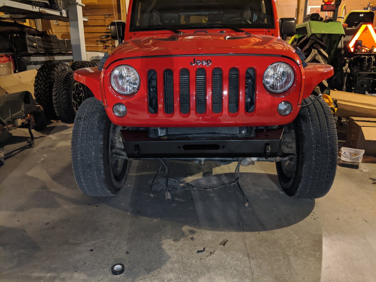

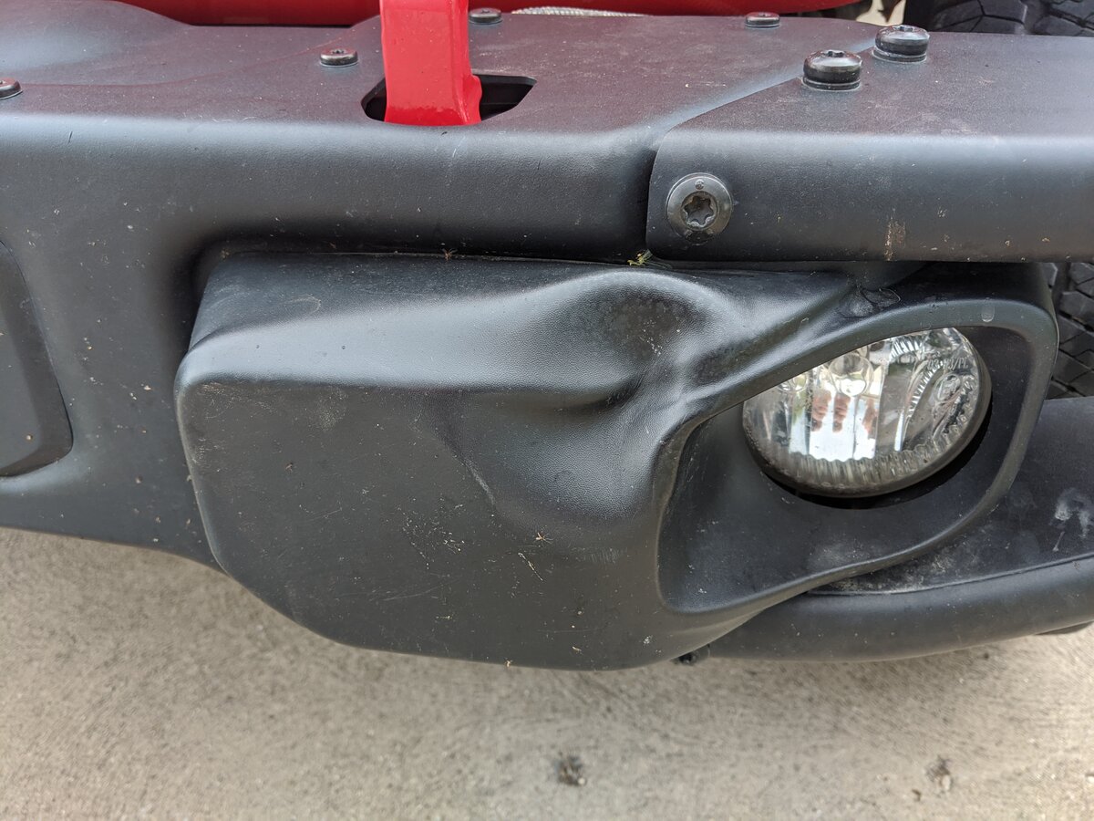

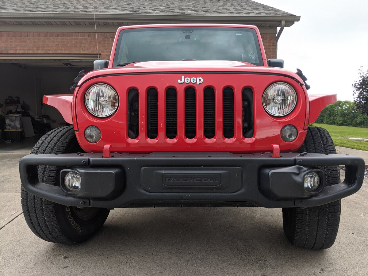

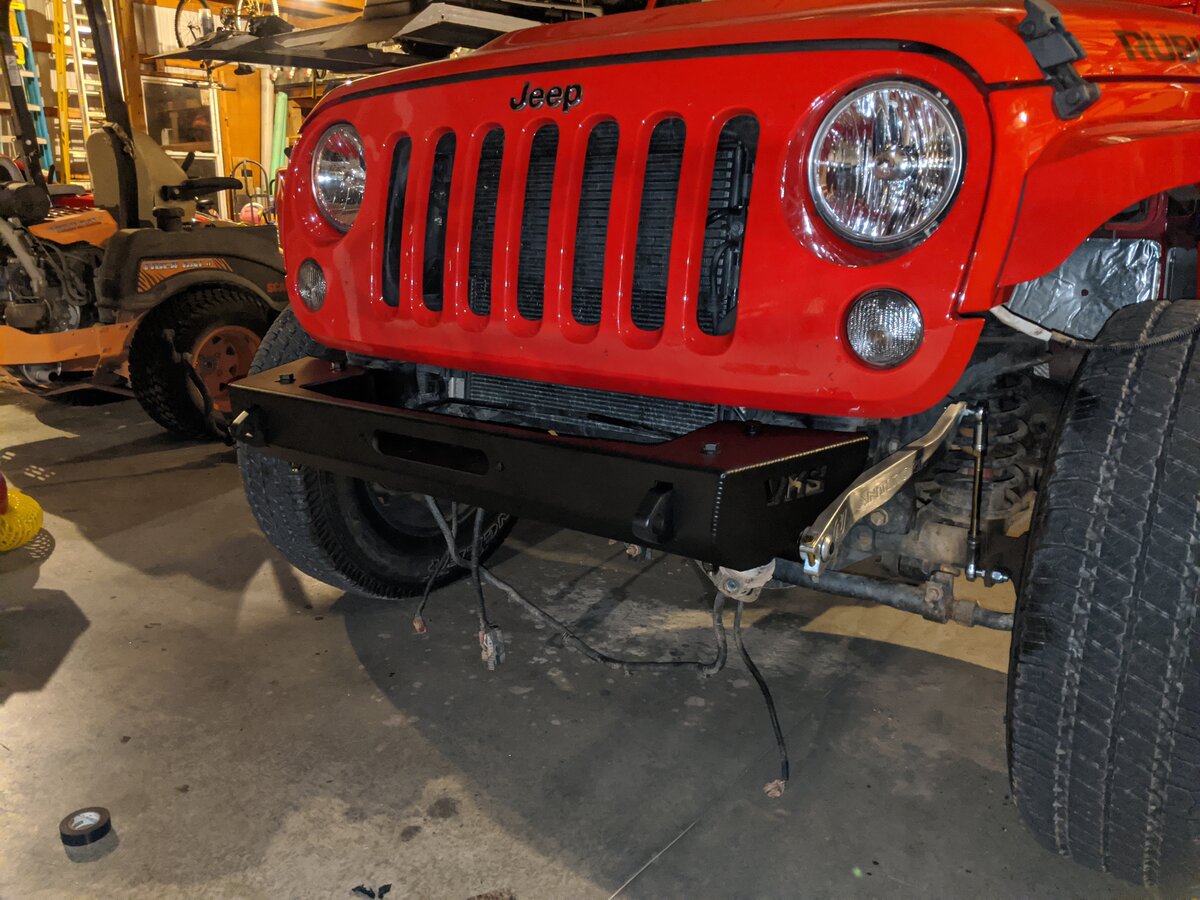

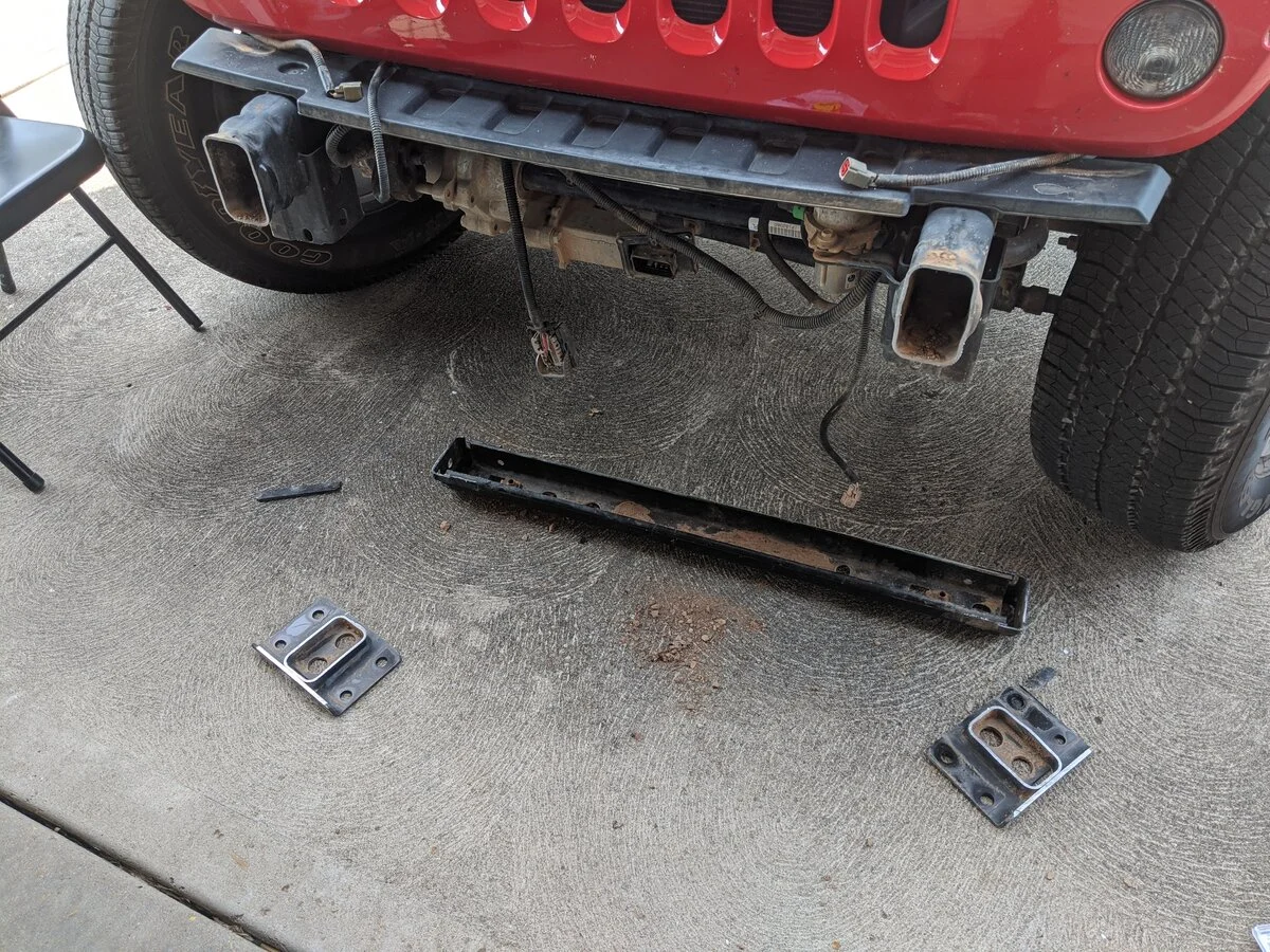

Time to turn my attention to the front. Again, I really like the factory front bumper. It's the OEM steel 10a that can be modified to fit a winch, but I opted for an aftermarket replacement instead. The previous owner had pushed in one of the front plastic pieces. I may try repairing it before I eventually sell the bumper.

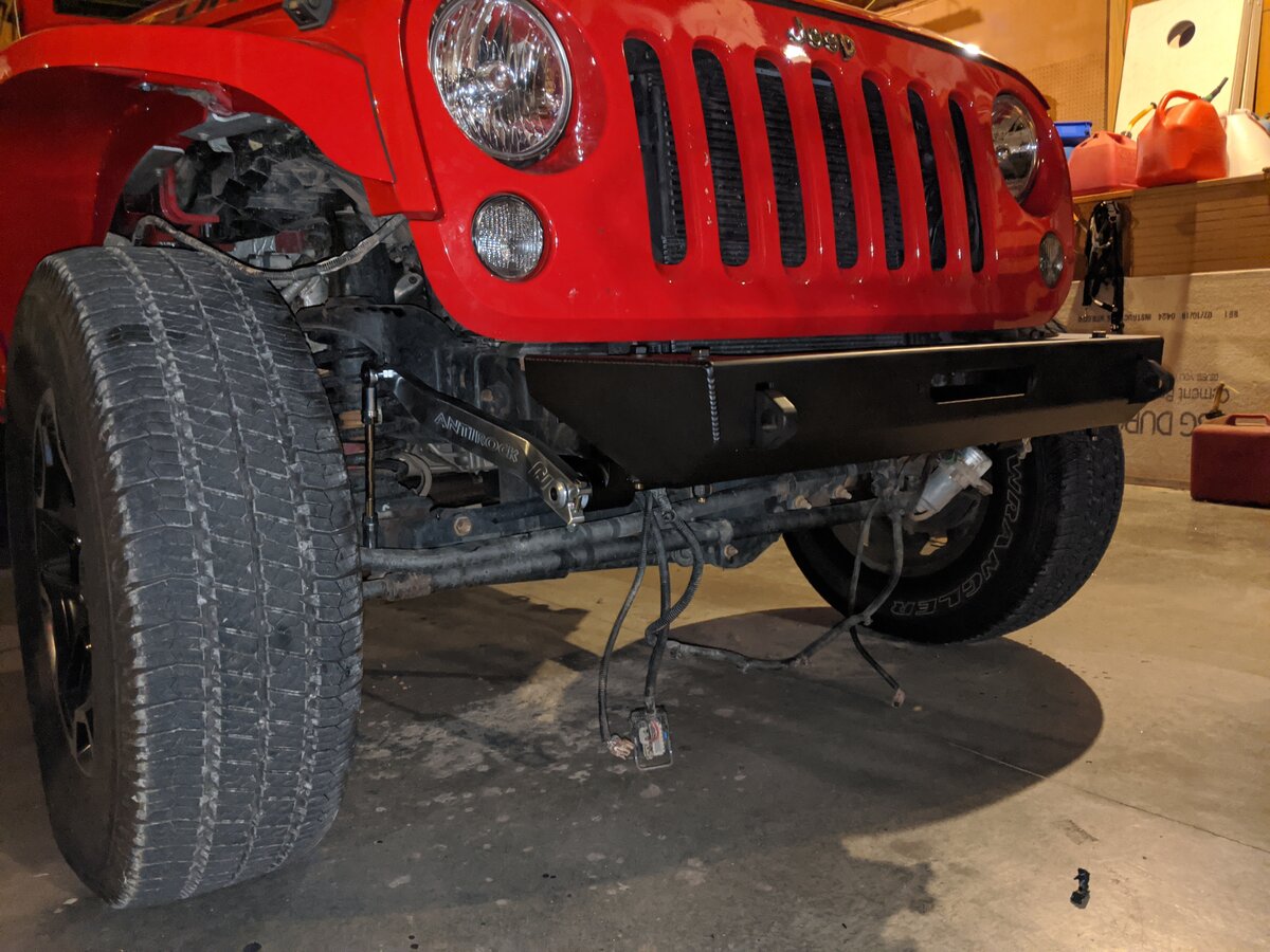

I decided to go with a minimalist approach to the front bumper on this build. I bought a VKS Shorty V3 bumper with no bar. I liked the winch being recessed and the light weight (26 lbs) was the clincher in my decision. This was also cerakoted to match the rear bumper.
This bumper requires cutting part of the frame rail and the crash bar off. Nothing like cutting on a new to you vehicle! I'll be nervous as hell for sure.

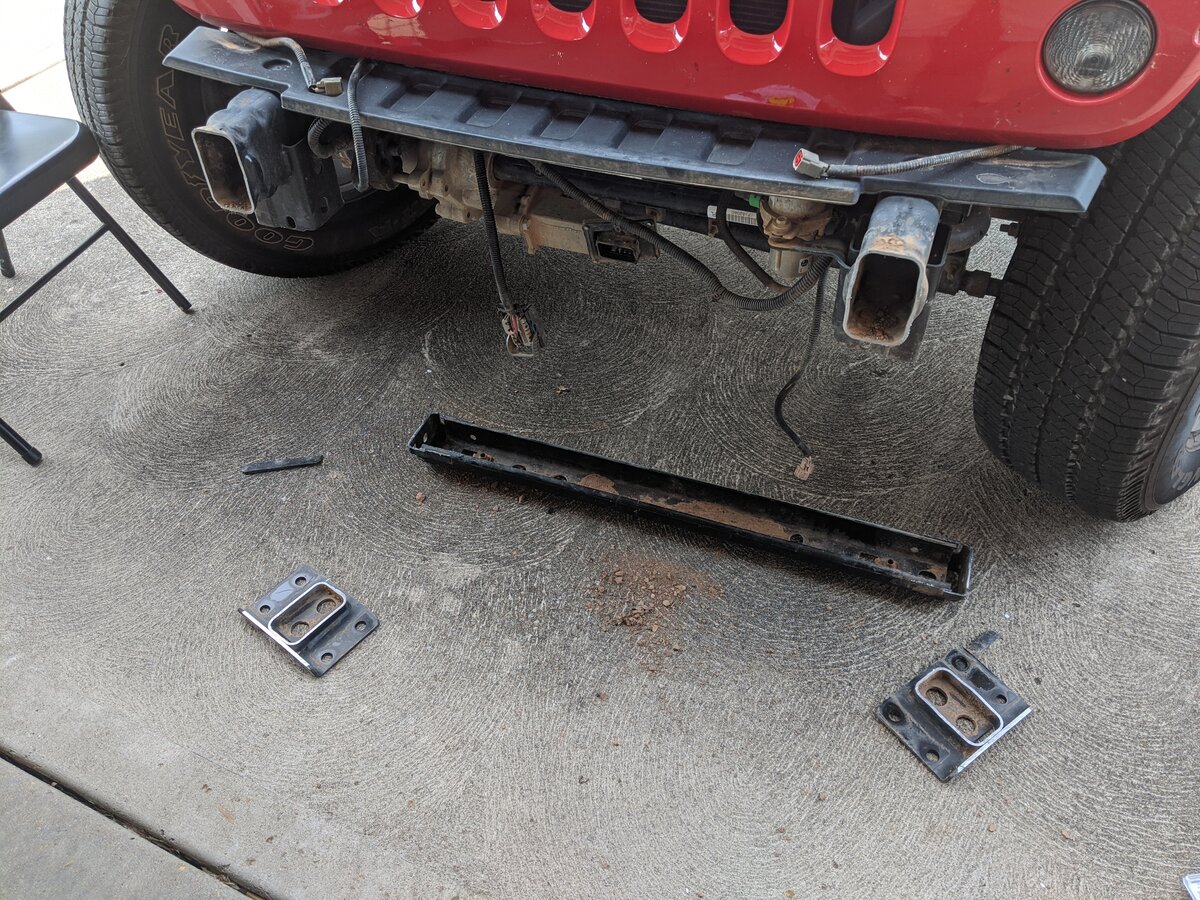

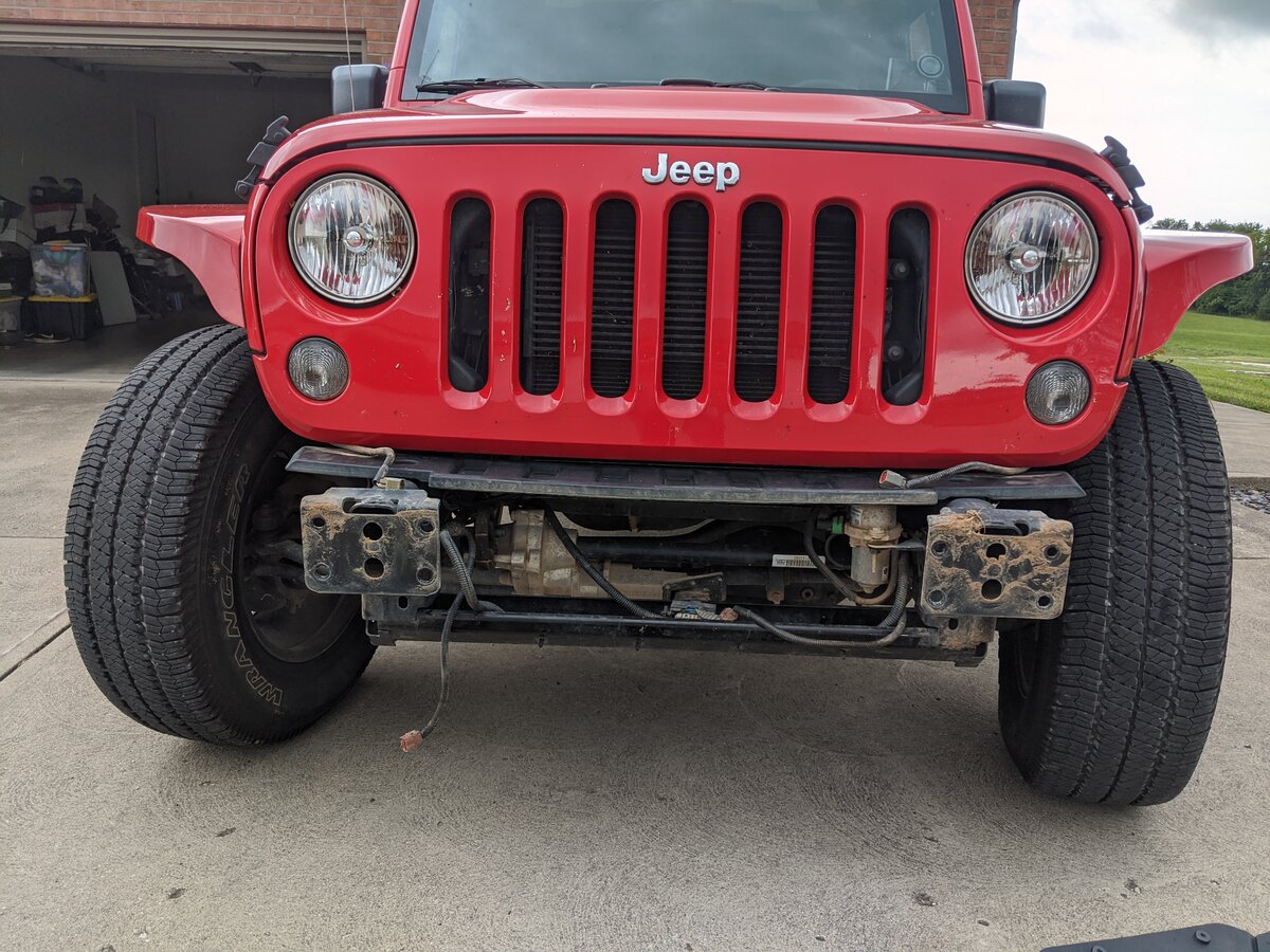

Unfortunately, tonight I only got as far as removing the stock bumper. Heading out of town for work for a few days. I won't get back to it until early next week. Until then, here are a few pictures.
I cut the frame on mine when I installed my front bumper, didn't like how far out it stuck past the grill. I also made it sit lower when I made my new mount brackets.

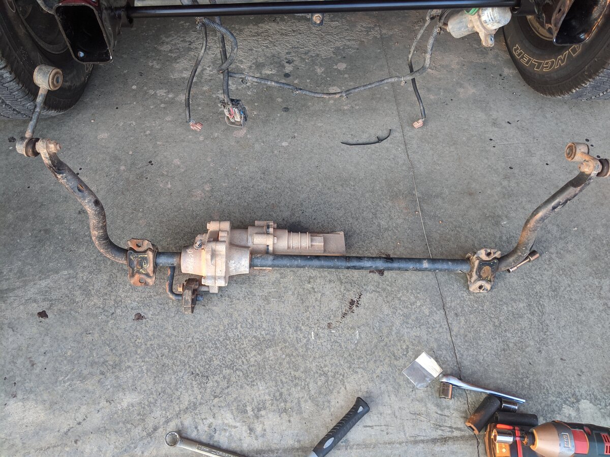

Finally had some time to get some work done last night. I finished cutting the frame caps and crash bar off. I tried to sit the new bumper in place, but the sway bar actuator was in the way. I forgot that I remembered reading that it needed flipped to fit. I had already purchased a Curry Antirock so I figured it would be a good time to install it. The sway bar actuator dropped easily and the Antirock went in just as easy.
Now, back to the bumper. Set it in place, marked some holes and drilled them. Removed it, filed and sanded all rough edges and shot it with some paint. Let it dry and bolted it all together. It was late when I finished. I need to clean up all of the wires hanging down (fog lights, sway bar actuator, side markers).

Can't really see it from a side view but looks nicer like mine not sticking out so far.
If I choose to drill different holes, I can slide the bumper back even further. To the point where I would need to cut my grill for a winch to fit. I don't want to do that though. I hoped to have set it back to where the winch will barely fit without trimming. Time will tell. Unfortunately I don't have the winch yet. Directions actually recommend mounting the winch and then setting the bumper in place.

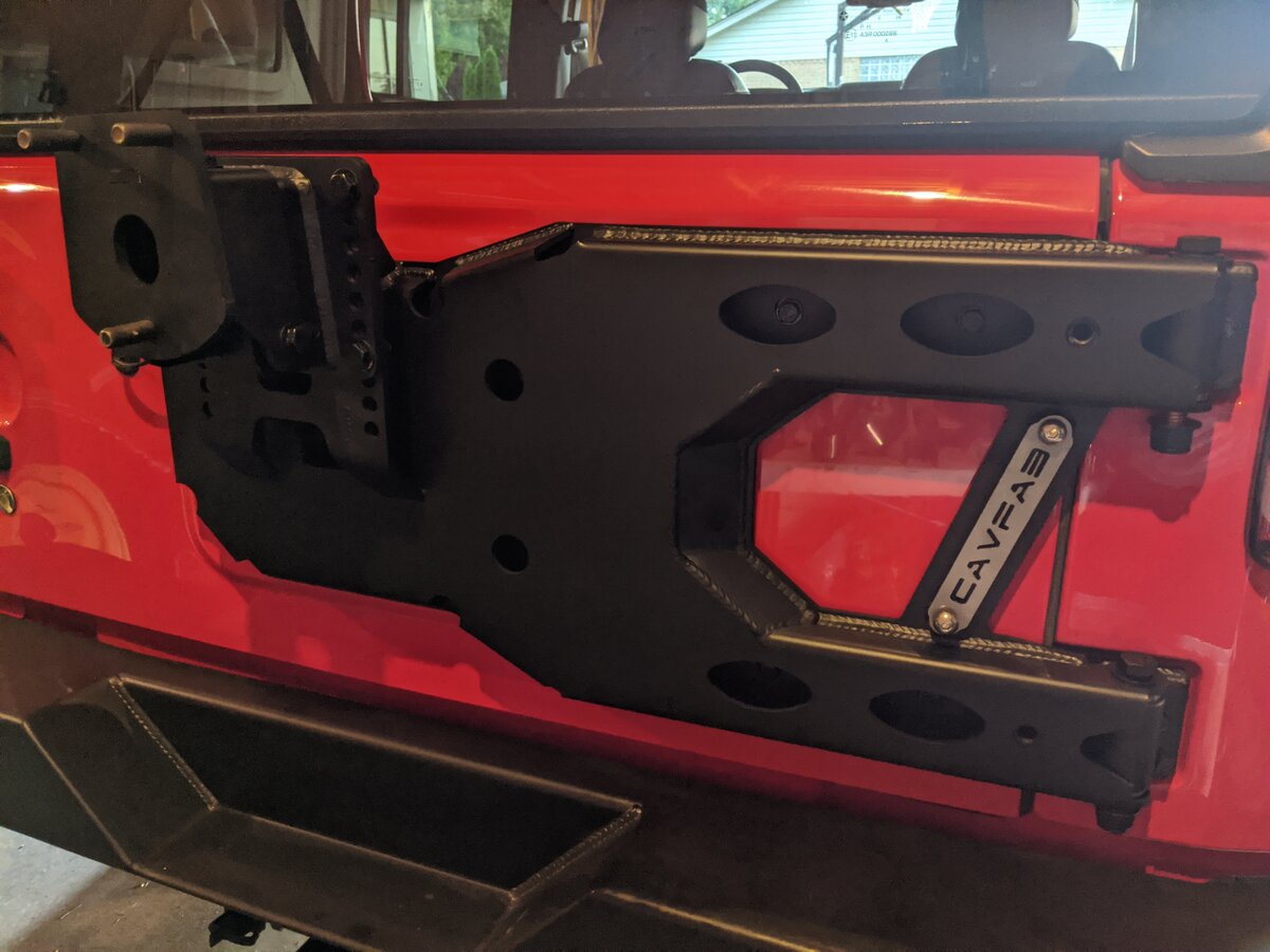

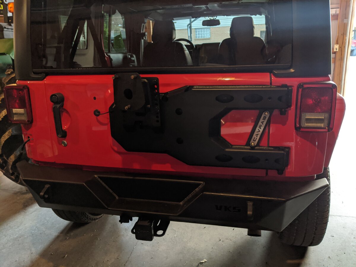

Was able to work on the Jeep again tonight. Wanting to run a spare tire I knew I needed to upgrade the tire carrier. I opted for this Cavfab Elite Series model. Installation was pretty straight forward. I didn't have time to throw one of the tires up there yet. I may have to do some tweaking, but it's on.
I also worked on the front end a little. I thought the front bumper slightly tilted down toward the passengers side. So I added a couple washers for shims and bolted it back together. I'm definitely happy I did, or that would have bugged me forever. I added some 3/4" round side marker lights into the new Nemesis fenders as well.
