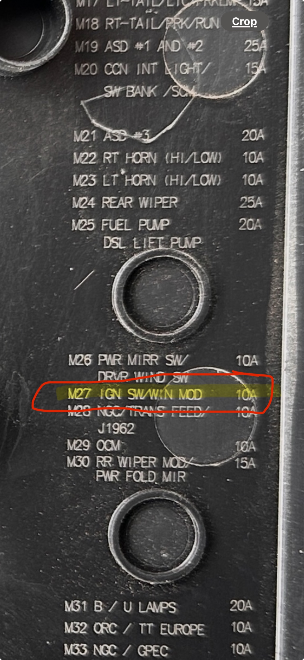

One clue is m27 fuse (ign sw win mod) was blown. I replaced and a few items are working again, but still no crank.

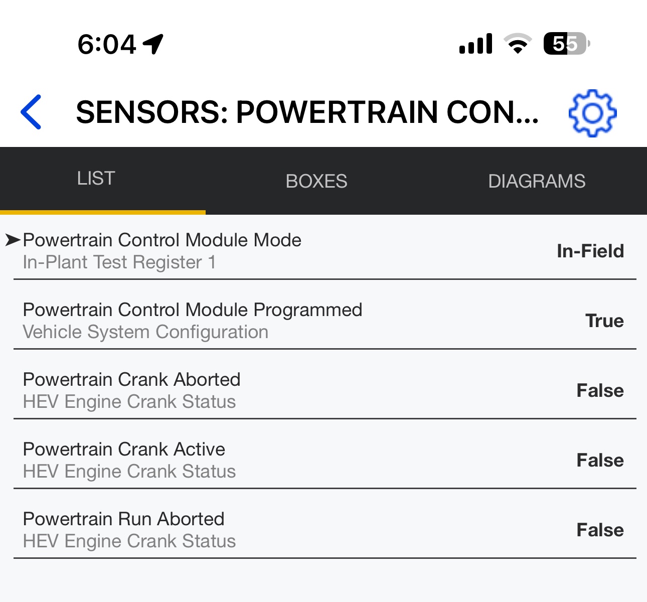

JScan reads this:
I will check. The dash was swapped with something from an SRT.

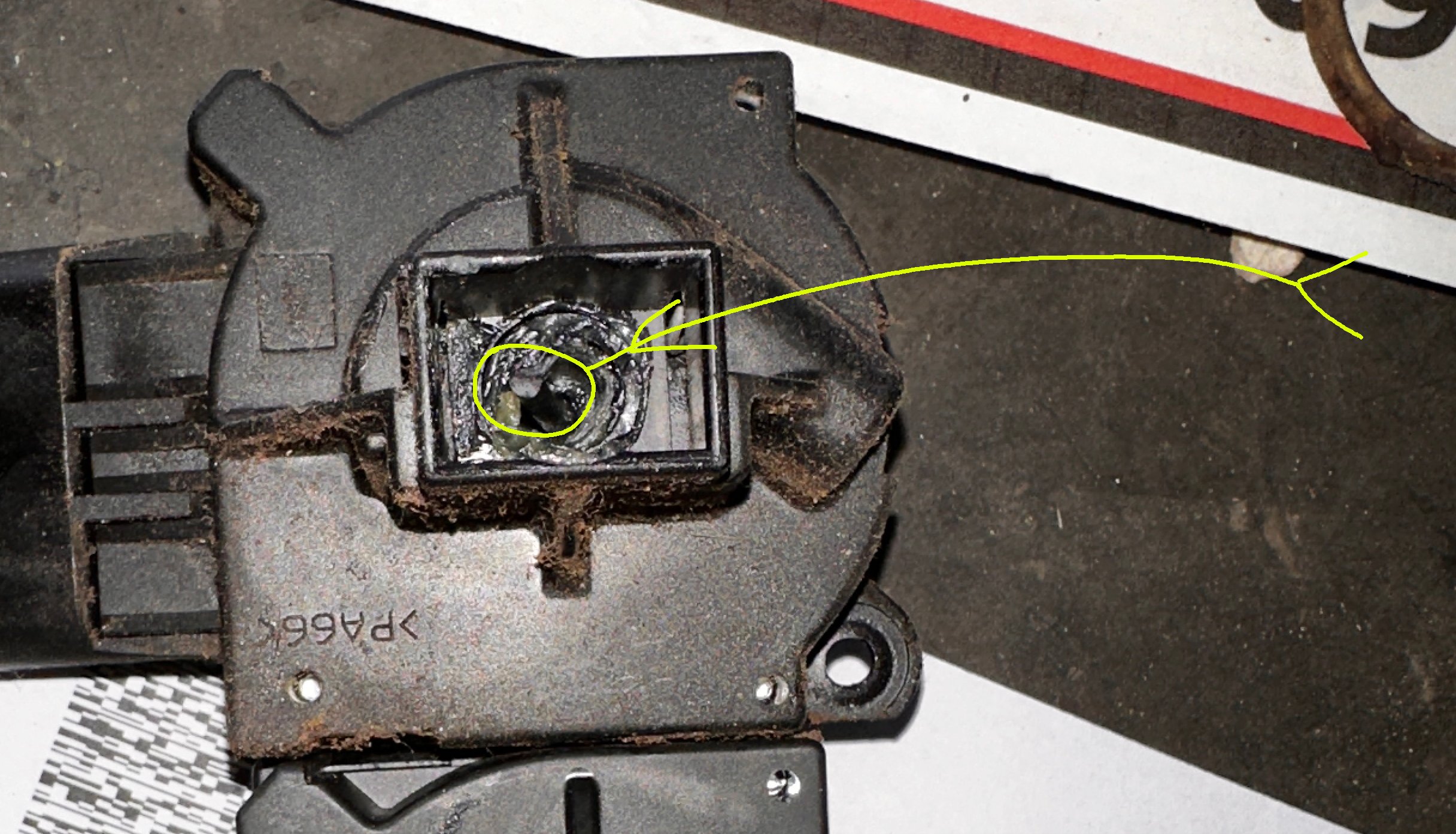

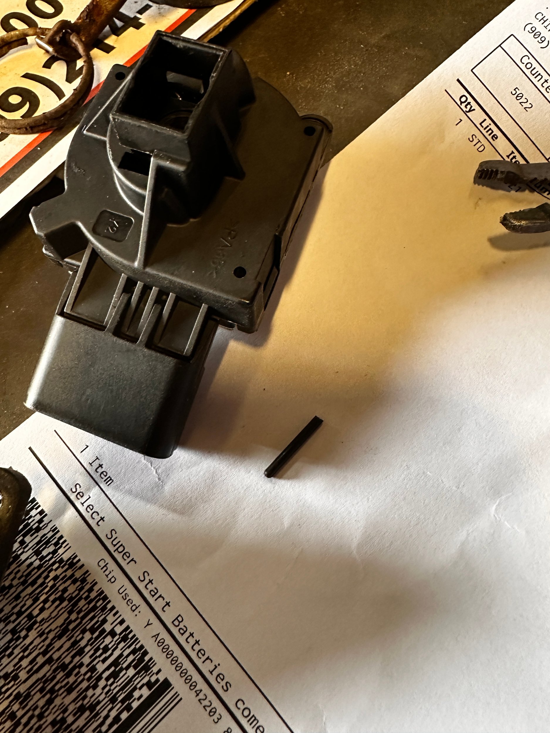

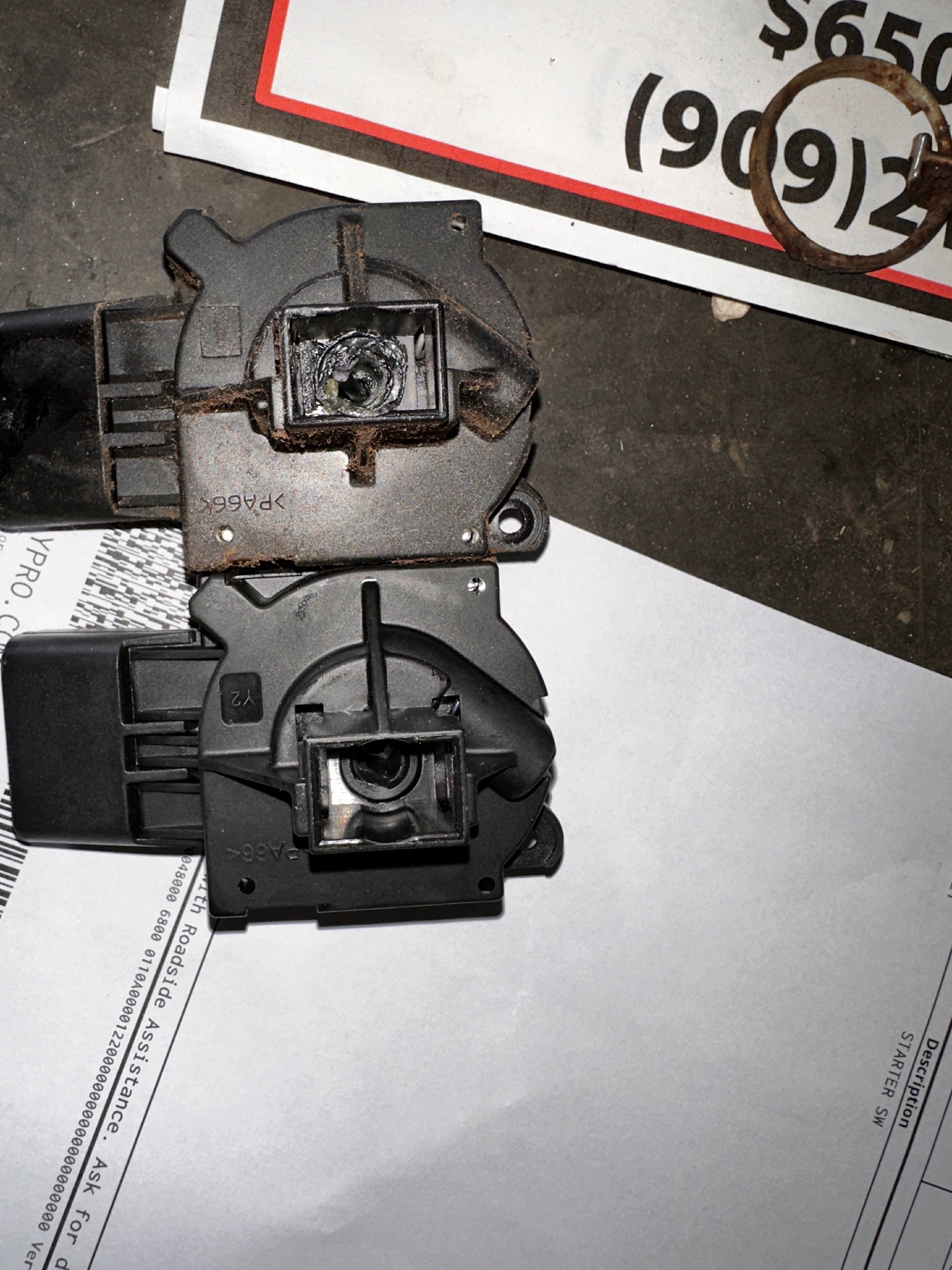

Meanwhile, I have pulled the ignition switch and found a little broken pin loose in the switch. i presume it is important and part of the ignition key part. Does this sound right?
Reactions: Artisanau
UPDATE! FIXED.
The broken pin is a door chime actuator. I installed the new ignition switch without the broken pin. Everything works except the annoyong door chime. Starts, gauges work, dash panel stuff is operational.

Some revisited facts, I pressure washed the engine compartment before the issue started. I changed the ignition switch (which seemed to cure the problem), I have blown M27 (10 amp) twice now when the problem occurs. It is not every time it blows. I also replaced my leaking locker air comp before this issue arised. The locker air comp stops working when the M27 fuse blows. No red light on dash. It is intermittent.
Any thoughts or advice is appreciated.
As an update, I found two issues on the m27 circuit. One was the new compressor has a cheap 12 connector. I fixed it and the variable noise and speed went away. When wiggling the harness, the motor would vary its speed. The second was someone “spliced” into the ignition “on” wire that connects the m27 fuse. A, it had too many things on it and B, the splice was stripped wires wrapped and taped, no scotch locks, t taps, etc. when I cut into the splice/removed tape, the ignition worked and sent a signal to start and it started. So, I bought some T Taps from McFadden Dale hardware and just need time to tidy up the loose ends. I did move the compressor hot lead to another switched circuit, the one that is in line with the switched cigarette plug. Fingers crossed that I’ve found it.

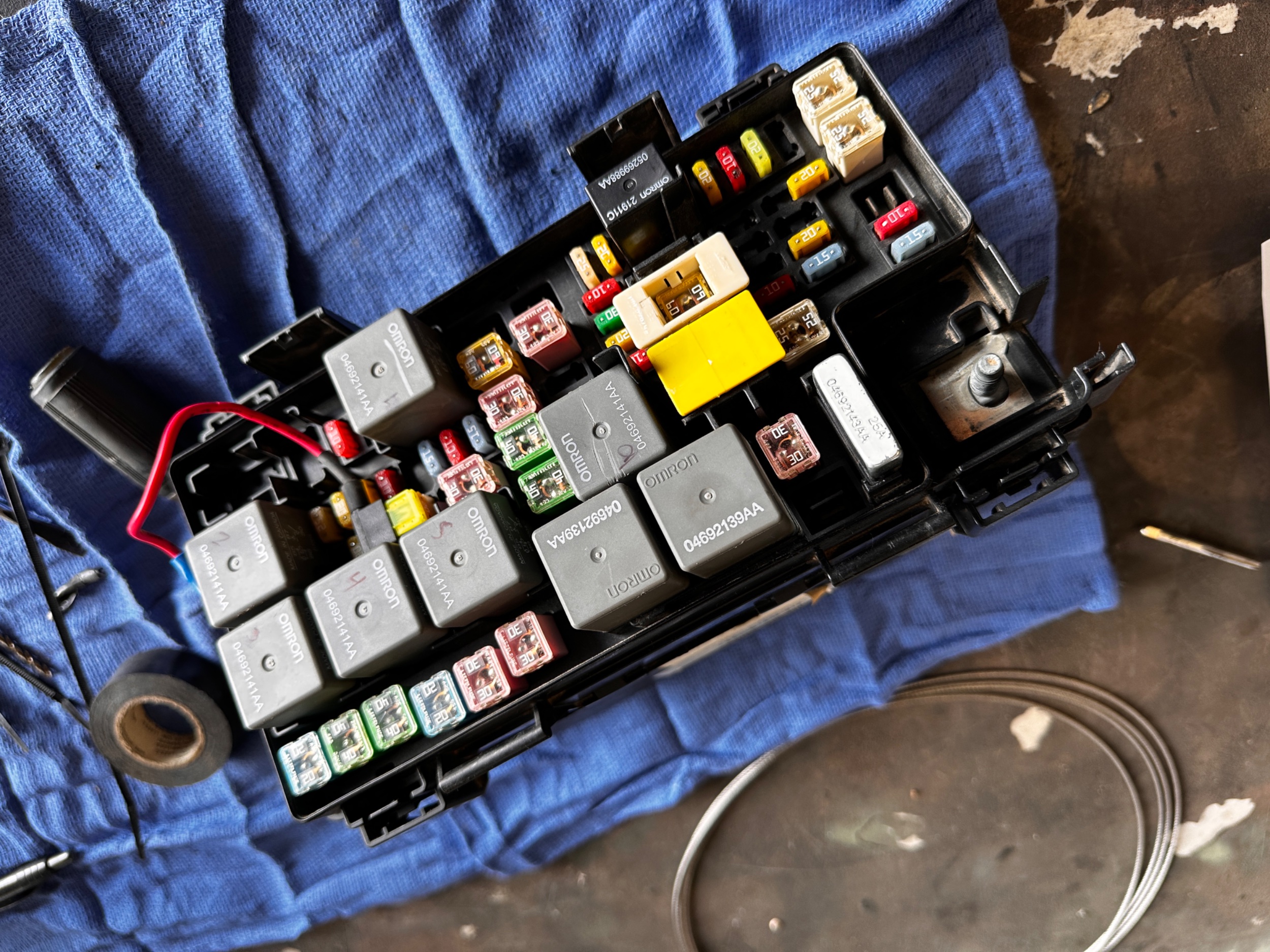

Well, the issue is back. Frustrating. I have the TIPM out and have cleaned it good and used contact cleaner on the harness plug in side. I'll put it back in today. I will also look at the neutral safety switch (it has a trans out of a 2009 Dodge ram.
The issue (at the moment) seems to arise when the Jeep is warm or been driven and up to temps. There is no 12v to the starter solenoid when key is turned to start. Something is blocking the signal, short, bad NS switch, etc. Starter spins the motor easily when jumped at the starter. On pre OBDI vehicles, turn the key to run and jump the starter and you are at least running.

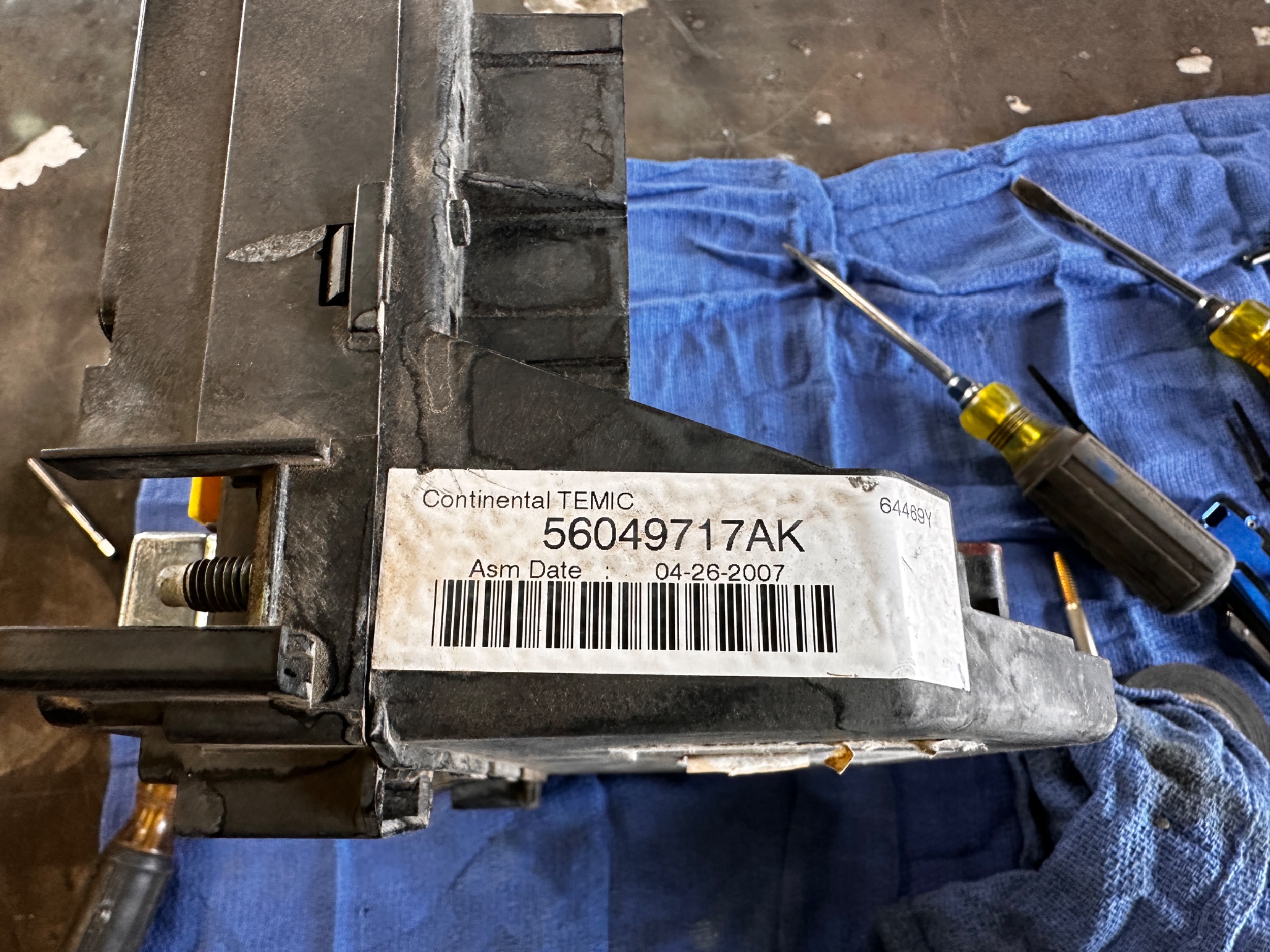

The trans in my JKU is a 545rfe (most likely🤷‍♂️) I think the sensor is outside. BUT, I did some testing and found/traced the problem to the tipm. I can jump pin 30 to 86 on k3 in the tipm and the starter cranks over the engine. The tipm did not send a signal out of 87 to 86. I purchased a tipm from mak’s and hope to have it to me soon.
Anyone have insight on the tests I did showing the tipm is the problem? It is the original with a date code of 2007

Yet another update in the no start saga. I have no confidence that it has been fixed but it is starting now. So far, zero "no starts". I bought a Mak's TIPM on Saturday and had it in by Tuesday. Great service, even with little details not very clear. I bought the extra 2 year warranty and it totaled about $800. Each step, the cost of parts I am throwing at the problem increases. Hopefully this was the fix. I was able to get a "crank, no start" by jumping pins in the K3 relay. Apparently, this is a solid indicator that the TIPM is bad.
