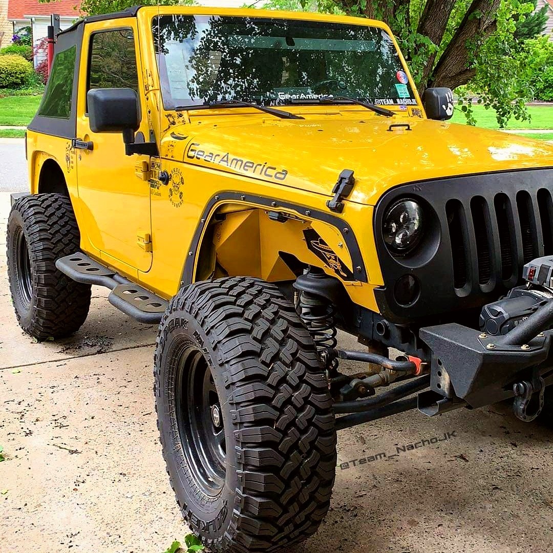

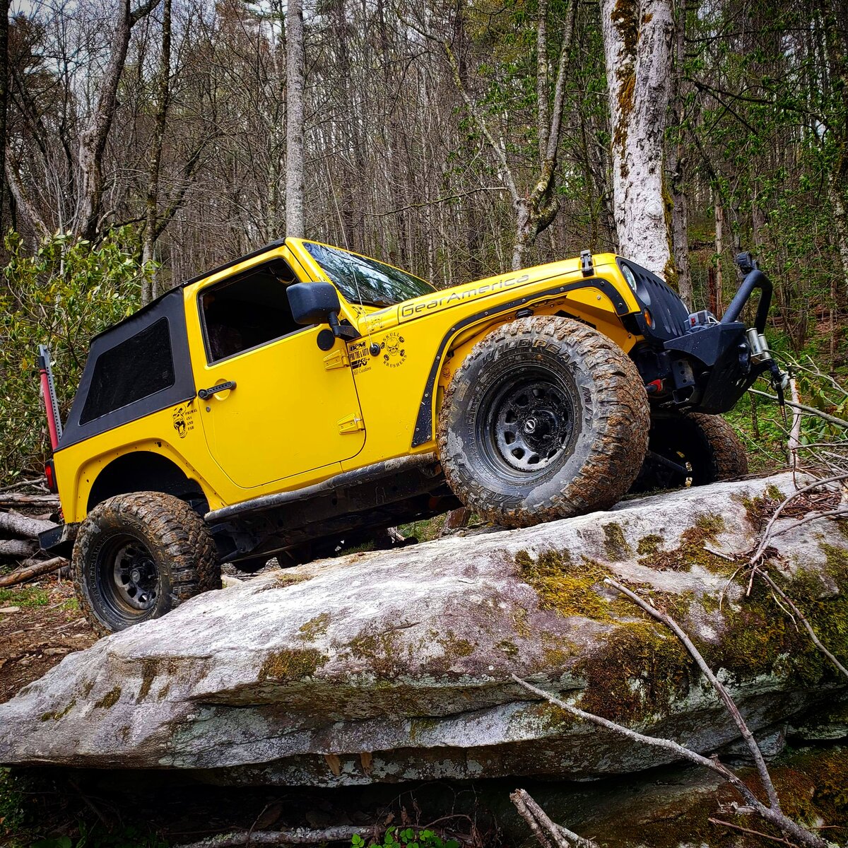

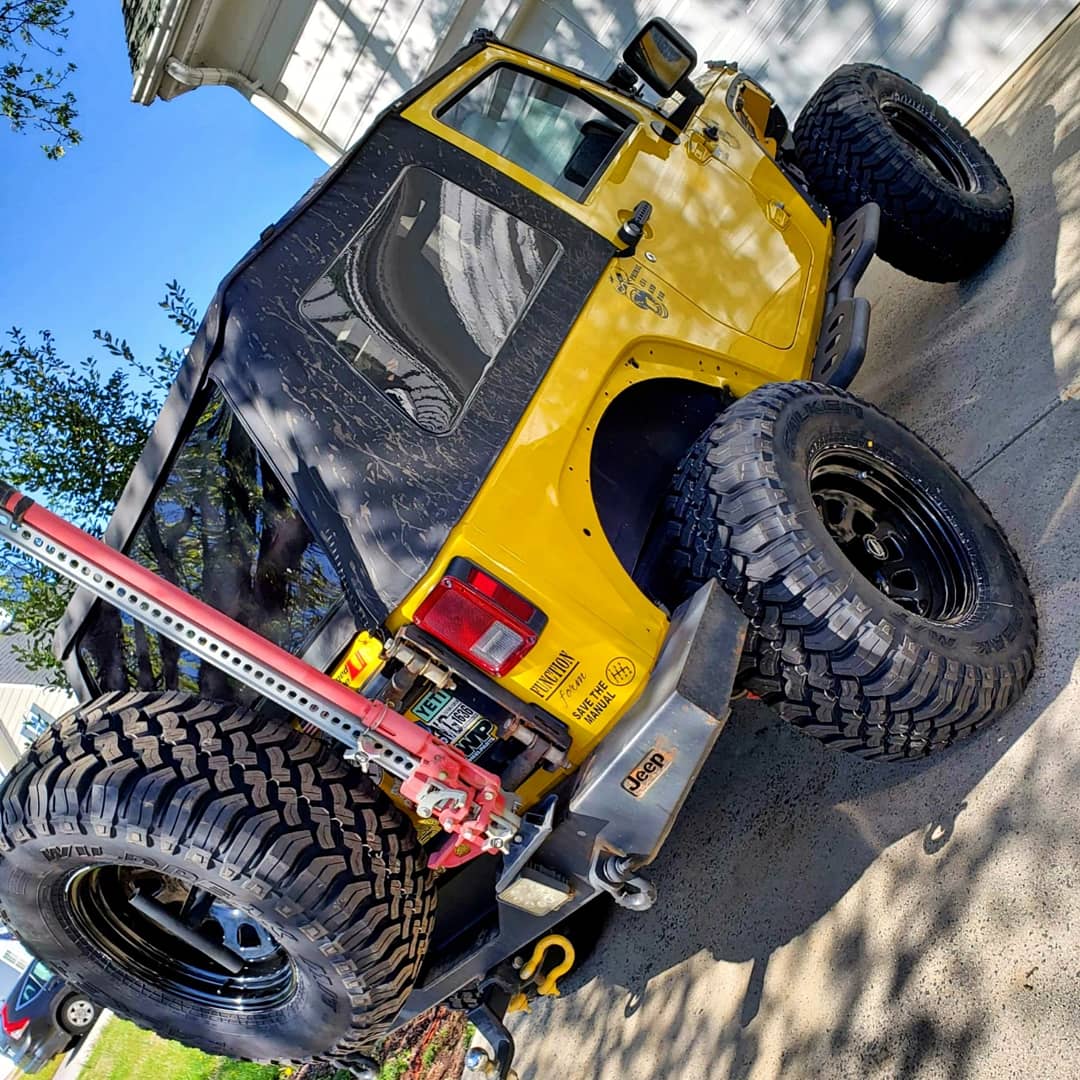

Hey everyone! New to this forum and still learning to navigate it. Thought I'd share my ride and talk with like minded individuals.
Here's My 2008 JK X Build Sheet:
INTAKE
K&N Cold Air Intake
EXHAUST
Cherry Bomb Glasspack
Cat and Resonator Delete
DRIVETRAIN
Dynatrac ProRock 44 Unlimited Front Axle
Carolina Driveline 1350 Front/Rear Driveshafts
CenterForce Dual Friction Clutch Set
CenterForce Heavy Duty Flywheel
Yukon 4.88 Gears (Front & Rear)
B&M Short Throw Shifter
B&M Precision Gear Selector
BRAKES
Duralast Gold Pads & Rotors
Metalcloak 26" Steel Braided Brake Lines
WHEELS & TIRES
35" Falken Wildpeak M/T (5)
17x9 -12mm Offset (4.5BS) Pro Comp RockCrawler 51 Steelies (5)
SUSPENSION
Rubicon Express 3.5" Suspension Lift
Rubicon Express HD Adjustable Track Bar
Core 4X4 Tier 3 Adjustable Control Arms
CavFab 1Ton Tie Rod
CavFab 1Ton Drag Link
JKS Quicker Sway Bar Link Disconnects
Dynatrac Extreme Duty Rebuildable Ball Joints
LIGHTING
Sunpie 7" LED Headlights
MicTuning Amber LED Cube Light Kit (2)
MicTuning 8pc Rock Light Kit
AuxBeam 3" LED Cube Light Kit (2)
CORSAIR Led Interior Lighting
EXTERIOR
RedRock 4x4 Stubby Front Bumper
SmittyBilt X20 10k Winch
Barricade Offroad Side Steps
Mopar Full Width Steel Rear Bumper
SkullKrushers Offroad Front Fender Liners & Gas Cap
OR Fab HD Spare Tire Mount
Bestop TrekTop NX
JCR Front Fender Deletes
SmittyBilt Oil Pan & Transmission Skid Plate
GS Power A Pillar Cube Light Brackets
INTERIOR
Herculiner Coated Tub
ParaGrip Grab Straps
ParaGrip Door Limiting Straps
NRG Innovations SRK 171-H Short Hub
NRG Innovations SRH Gen II Quick Release Hub
NRG Innovations RST-012R 320mm Steering Wheel
ApolloIntech Pro Switch Panel
OTHER
Cobra 75 CB Radio
FireStick 5' Tunable CB Antenna
Quadratec Mirror Relocation Kit
HiLift 48" Recovery Jack
HiLift Tubular Mount
GearAmerica HD Mega Shackles Front & Rear
GearAmerica Ultimate Recovery Kit
I'm still in the process of replacing a lot of components- I bought cheap stuff up front (bumpers, lights, etc.) since it's my first Jeep ever, and now that I've got a little experience off-roading and figured out what I like/don't like, we're upgrading yet again.
Future plans are: PR60 in the rear, new suspension & air bumps, 10" stretch, re-gear to 5.13/5.38, new powerplant, and roll on some 40's.
Thanks for taking time to read this! Please share your builds as well!

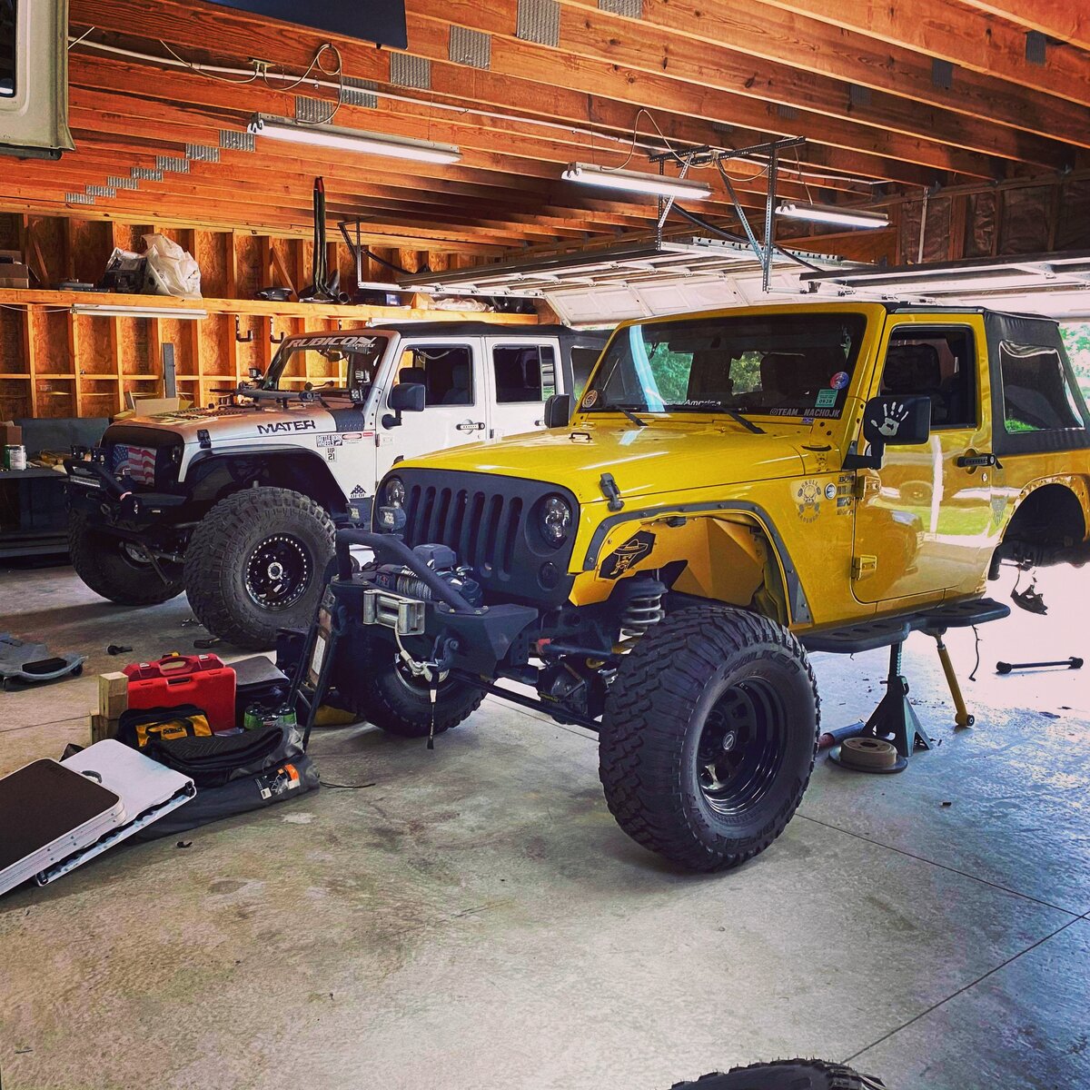

UPDATE: the front is pushed 1" so far, waiting on track bar frame side mounts and my PSC Hydro Assist with Ram to push that front end another 2"... looking at AccuTune for weld on coilover brackets and a dialed in front suspension. May have to replace that Rubicon Express Track bar in order to clear the ORO Swayloc that's also on order. Will be selling my JKS Quick discos as they're entirely too short lol. ANNNDDD the rear is out, but I'll update on that later🤪
Reactions: Chris
Thanks! Went ahead and swapped the coils for a 4.5" from 3.5", and upgraded the shocks to 6" for now. Getting ready for the bigger tires. Still have to do something about the brake booster, fuel cell, and rear brake lines. Threw the stock shafts back on to mark up and reference when getting the new distance from yoke to input shaft, F/R.

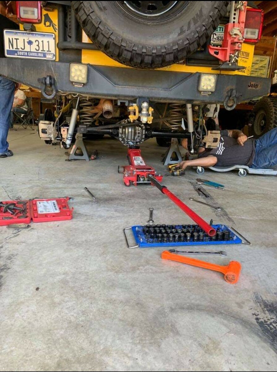

Alright, so update:
Sitting at 99.5"WB.
We're back on our own weight! Rear is pushed back 3"-will need to get new brackets and track bar for the rear axle, along with cutting the axle shock brackets and moving them up.
Still have to install the new shocks (pictured are the old ones, new ones should be here Wednesday). Also have to get drag link, steering box and ram brackets for the front (getting it prepped for a sturdy 3 link with the front pushed another 2").
For now it's driving well, the new coils make a world of difference and I'm pretty happy with where we're at. 37's are next and figuring out how I want to set the rear up in 21/22.
Keeping the 44R for now. We'll see how the flanges hold up.
Looks like I have some minor cutting and I've got to get rid of my God awful rear bumper.
More pictures once the new shocks are on. Cheers
