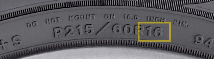

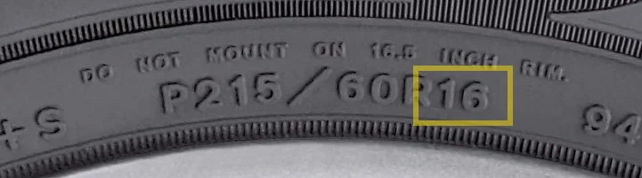

Tire Size
Choosing the right tire size is important for maintaining comfort in the Jeep Wrangler. You can find the tire sizes on the tires themselves, or you can find them on the label inside the driver's door jamb. If you want to go up in size, it's recommended you replace the rims as well.
Figure 1. Tire size located on all four tires.

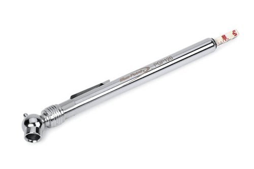

Tire PSI
The second most important thing, after having the right tire size, is to ensure proper tire pressure. The tire pressure tends to vary depending on the weather or if you have a tire leak. The cold weather deflates the tires, while the warm weather inflates them. It's important you invest in a four dollar tire gauge. Checking the tires once a month is a piece of maintenance that shouldn't be taken lightly. If the weather changes, be sure to check the tires as soon as you can. Uneven tire pressure could cause the Wrangler to handle poorly, and it will also cause it to pull in one direction; not to mention the tire wear it will cause. This piece of maintenance takes about two minutes total and could save you a lot of money down the line. The proper stock tire pressure for the Jeep Wrangler JK is 37 PSI for all four tires.
Figure 2. Tire pressure gauge.

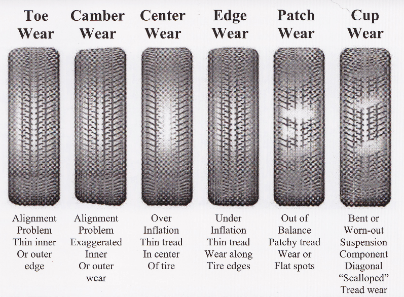

Tire Wear
Detecting uneven tire wear can save you a lot of money. There is a reason your tires are wearing unevenly, and if you catch it early on, you could save yourself the headache and the money of purchasing new tires. Bad alignment could cause the tires to wear unevenly, even if they are brand new. Improper tire pressure can also eat away at your tires, along with imbalanced wheels. It's important you glance at your tires as you walk by them, along with investing two minutes to thoroughly inspect each tire for uneven tire wear. As soon as you feel a difference in handling, check the tires and tire pressure.
Figure 3. Tire wear.
Tire Size
Tire PSI
Tire Wear
