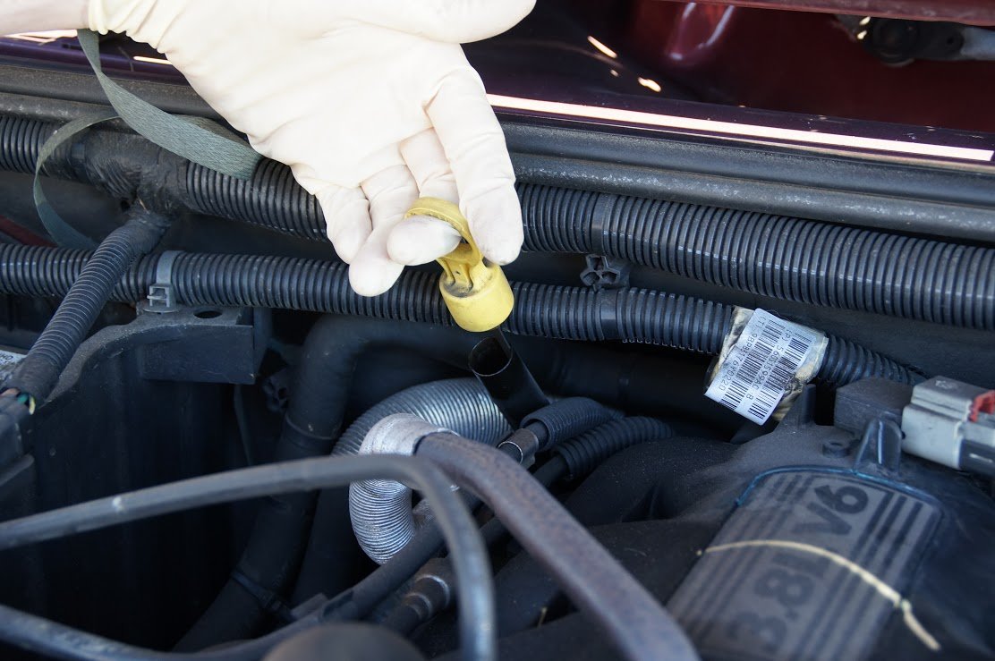

Using your Jeep as a daily driver, an off-road machine, or using it to tow makes for different maintenance intervals. When you use your Wrangler for towing, you can automatically change the fluid change intervals by 2,000 miles. So if you replace your engine oil every 5,000 miles, replace it every 3,000 miles instead. Be sure to always check your transmission fluid and transfer case fluid, as they may burn a lot quicker with a load behind you. Always rotate your tires and check them for unusual wear. If your car is misaligned, your tires will wear quickly. If it's misaligned and you're towing, it will wear out even faster.
Figure 2. Check fluids more regularly when towing.

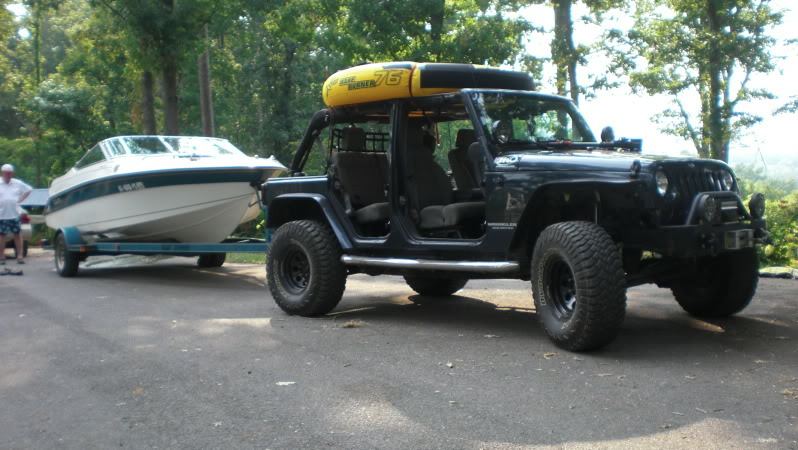

The Jeep Wrangler is capable of towing 2,000 to 3,500 lbs depending on the package you have. Check your owner's manual to know the exact number on your specific Jeep. Always check the trailer you're pulling and be sure you're calculating whatever goes on or in the trailer.
When you're buying a tow hitch, if your Jeep didn't come with one, be sure to get one that can handle up to 3,500 pounds. Note that if the tow hitch is capable of towing 6,000 pounds, it doesn't mean your Jeep can as well. Your maximum towing capacity is 3,500, so never go over it.
Figure 3. Wrangler's maximum towing capacity is 3,500 lbs.

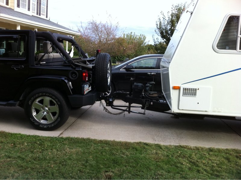

Figure 4. Towing with sway bar attached.
One item often overlooked is trailer frontal area.
From the JK/JKU Manual
Frontal Area
The frontal area is the maximum height multiplied by the maximum width of the front of a trailer.
JK is limited to 25 square feet
JKU is limited to 32 square feet
Pretty sure the trailer in this photo exceeds that.
