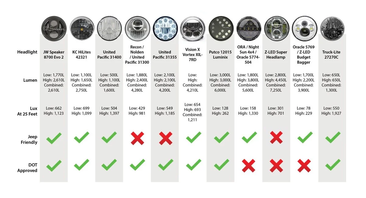

Here's a rating comparison of some of the more popular LED lights for the Jeep Wrangler JK:

So does more lumens mean more light?
Be aware that when choosing an LED light, there is way more to it than simply which one has the most lumens. A perfect example of this would be the Truck-Lite 7" LED Headlights. While they don't have as many Lumens as some of the others, it doesn't matter, because the reflector housing in which they are in provide a far better light output than almost any of the LED lights on this graph.
