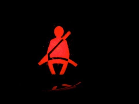

- Start with the ignition switch in the "OFF" position and your seat belt buckled.
- Switch the ignition switch to the "ON/RUN" position, but be careful not to start the engine. The seat belt reminder light will disappear from the dashboard at this time.
- You will have 60 seconds to perform the following steps, so move swiftly and correctly: Start your vehicle, and then buckle and unbuckle your seat belt three times within a 10-second period. Your seat belt should be fastened by the third pass.
- The seat belt reminder chime is now disengaged.
Figure 1. Your vehicle is designed to remind you to follow the best safety practices.

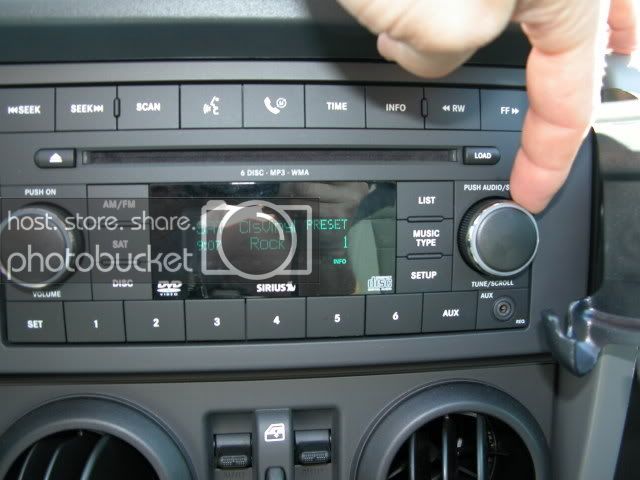

Step 3 – Set your clock
- Locate the "TIME" button, then press and hold it.
- Continue to do so until the hours begin blinking on the display.
- Using the right-side "TUNE/SCROLL" knob, set the current hour.
- Press the knob once more to set the minutes, and begin making adjustments as needed.
- Once the minutes and hours are set and saved, which is done by pressing the knob for a final time after each entry is made.
- Wait five seconds for programming to end.
- Alternately, press the "SETUP" button, and then select "SELECT HOME CLOCK."
- Set the hour, and then minutes for the current time, and save the entry by pressing the "TUNE/SCROLL" knob after each pass.
Figure 2. This is the clock setting procedure.
