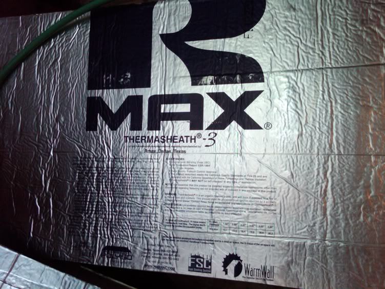

  • 3/4 inch Thermasheath-3 insulation sheets (2)

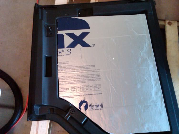

  • Lay the Thermasheath over the hardtop and trace the layouts to cut.
  • Cut the patterns out using the box cutter.

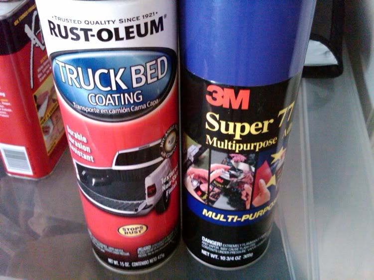

Figure 1. Truck bedliner and super glue.
Figure 2. Cut Thermasheath into the right pattern.

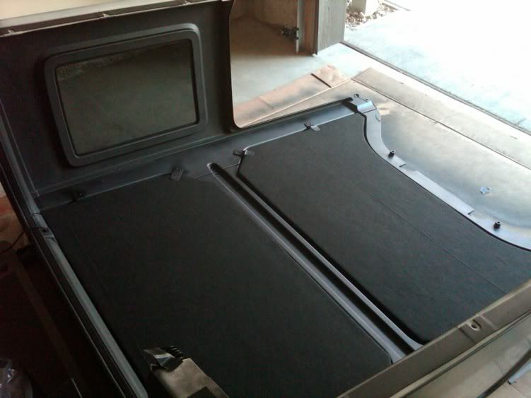

Step 2 – Insulate hardtop
Now that you have the exact cut outs of Thermasheath, it's time to adhere them to the top. Follow these steps:
  • Use the aerosol super glue to thoroughly spray the inside of the hardtop.
  • Wrap Thermasheath panels in the thin black carpeting.
  • Once glue is evenly settled, lay the Thermasheath cut outs into their respective places and let dry.

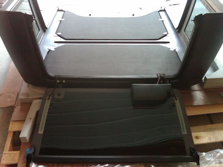

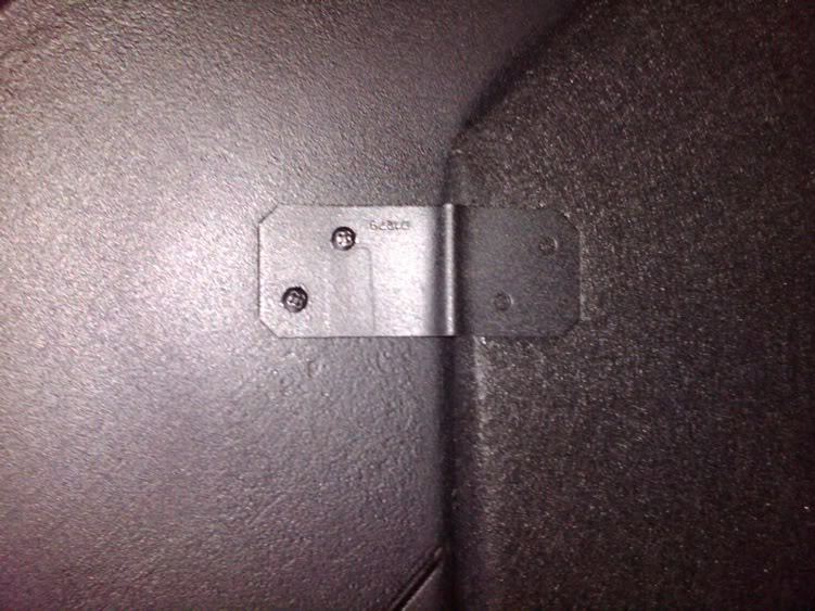

  • Screw hinges on each corner; one side on the Jeep's panel and the other on the new insulation to make sure the panels don't fall off in the long run.

Figure 4. Attach hinges with screws.

Figure 5. Finished product.
Figure 6. Another view of the finished product.

@Chris do you think the 3M Super 77 would work better than 3M high temp spray adhesive?
Ever found any better hinges? These seem to be doing a perfectly good job. And appear lightweight. Just wondering if there is a bit more robust hinge?
Does the hinge actually work? Or did you spray the RMAX directly to the roof panels? Would rubber mat be more sound deadening and heat resistant? Like that one level up frim sound deadener? Like that thick stuff you used on your TJ?
