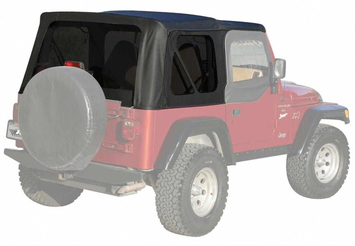

It could have a hole.
The soft top is soft, so over time, it could get ripped or worn that can cause a leak. Go around your Jeep looking for any wears, tears, or holes that could be causing water to go inside your cabin.
Figure 1. Inspect your soft top.
If you have a hard top, proceed to Step 2.

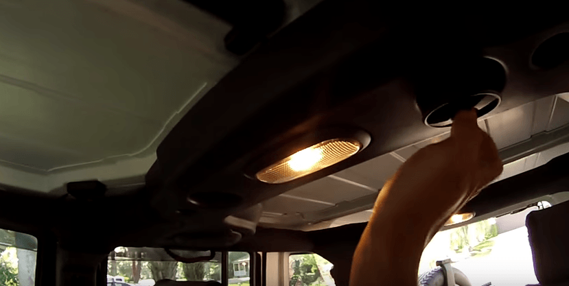

Step 2 – Check top's alignment
Your hard top could be installed incorrectly.
The hard top should be aligned a certain way. If it's misaligned, it could cause a leak. To properly install the hard top, always put the passenger's side on first, because the driver's side overhangs on the passenger's side. After you've installed the driver's side, pull it up, then let it down a few times to make sure it sits properly on the gasket and that the gasket isn't rolled over. Be sure to install both tops on first before you lock any of the locks. Make sure the center piece that screws in the sound bar is tight; many people forget to tighten it.
Figure 2. Tighten the center piece.
If the roof is installed properly, proceed to Step 3.

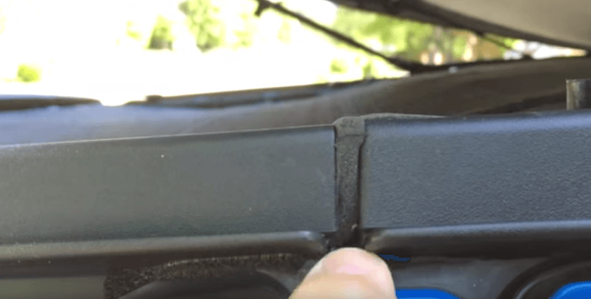

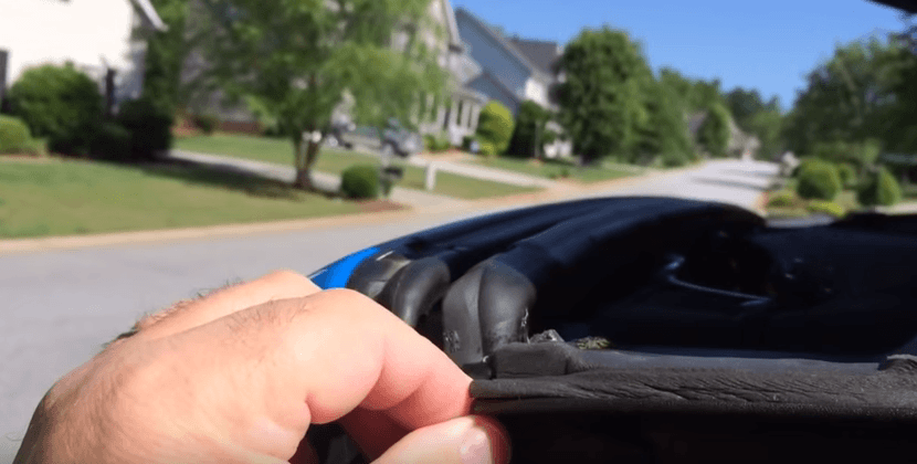

Step 3 – Check the weatherstripping
It could be worn.
Check the weatherstripping along the side of the Jeep. Be sure to check the little corners where weatherstripping meet. Also, check the corner where the windshield meets the top; this has been known to wear out or overhang, which causes a leak. If you discover wears in your weatherstripping, purchase new ones and replace it. You will need weatherstripping, adhesive removal, adhesive, and a weatherstripping installation tool to get the job done.
Figure 3. Check weatherstripping.
Figure 4. Check all corners.
It could be worn.
