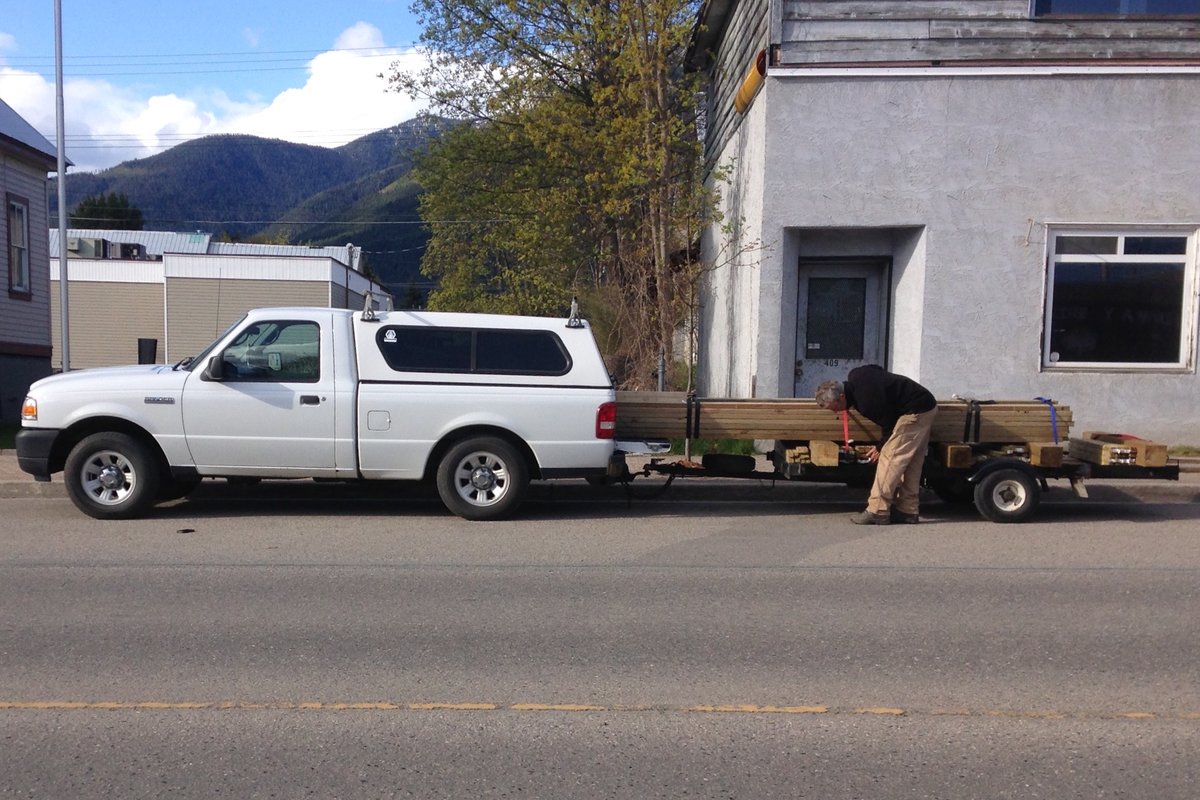

you cannot see but there is a Jeep in front towing it
