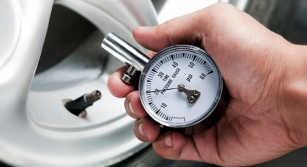

Step 1 – Check the tire pressure
Before going above and beyond by installing a flashpaq or even buying new tires, make sure to check your tire pressure. If the pressure is too low, your mileage will take a large hit. The best rule of thumb is to refill the air pressure according to the PSI level indicated on the sticker in your door jamb or owner's manual.

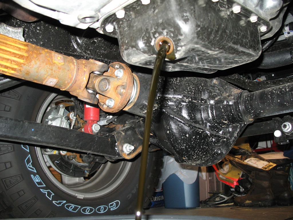

Step 2 – Maintain your vehicle
Keep up with all oil and filter changes. Remember: it's about fuel, spark and air. So if your engine is lacking in anyone of these areas, then make sure to give it a complete tune up and replace necessary components.

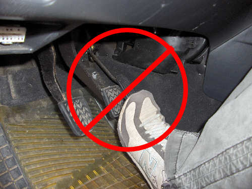

Step 3 – Change your driving habits
This is the most crucial thing to do in order to increase the fuel economy on your JK. If you drive a manual transmission, it will be easier to keep the revs under 3k and thereby increase your overall fuel economy. However, those of you who drive automatics, pay attention to your speed. Those who stay at 65 miles per hour tend to have the best highway results. The official terms for this is hypermilling, which refers to the art of driving. Also, pay attention to hard stops and heavy acceleration, and coast when allowed.
Figure 3. Learn the art of hypermilling.

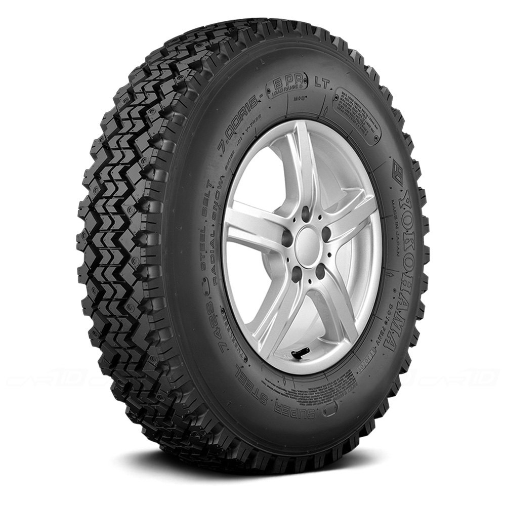

It is a hard tire to find, the Yokohama 742S 7.50R16 is 32" tall, 7.50" wide.
It might be too skinny for the JK Flare, but the point is gas mileage takes a hit with bigger, wider floatation tires. Most of us ignore that, me too. But I have always loved pizza cutters and after installing these, with no other changes, I could not believe the jump from 17mpg to 22mpg.
