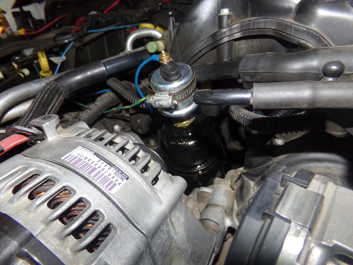

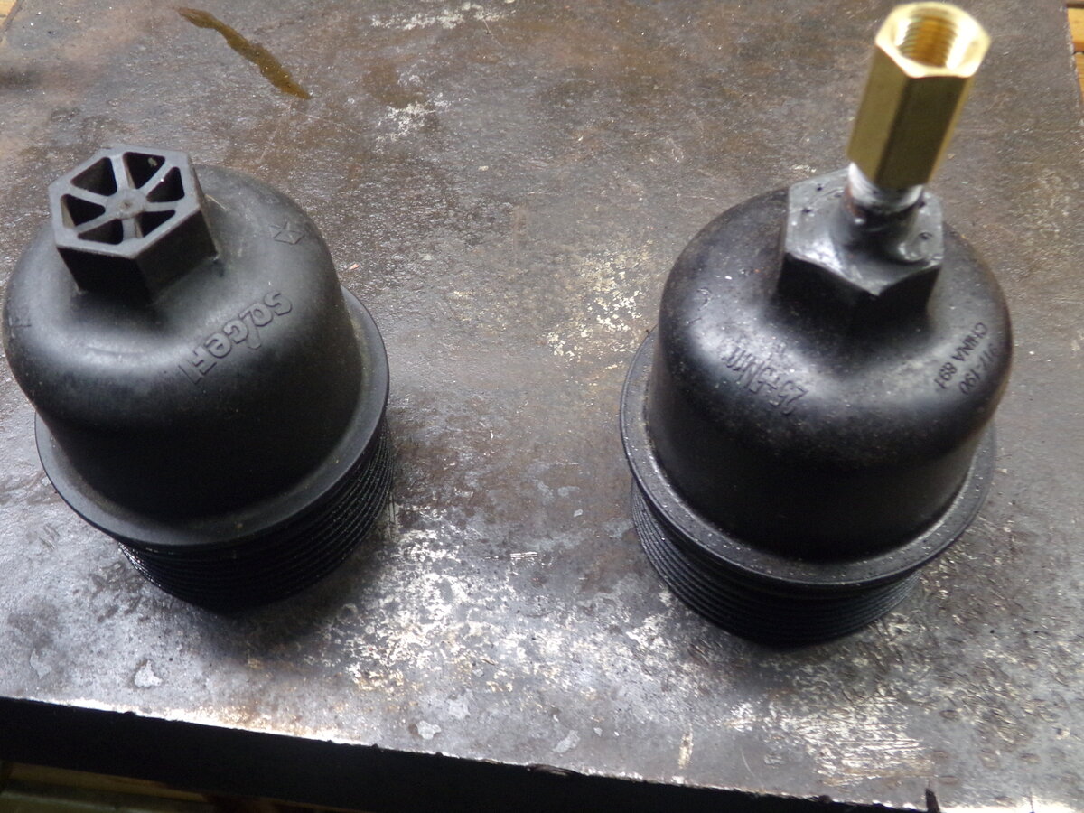

I found that by drilling and tapping the top center of oil filter cap on the 3.6 engine and screwing in a 1/8 th. short nipple one can adapt to an electric sender or pressure line. I put a layer of JB weld on the outside of the fitting for extra strength. Do not use a wrench on the adapter fitting to tighten the filter cap. Myself I use a crows foot on the cap. When the engine is first started cold you'll wonder if that 95 pound reading is correct. And it is. Later I'll see if I can post a picture or 2. I hate those idiot lights.....What they usually mean is get out and start walking.
You can buy those housings already tapped also.
