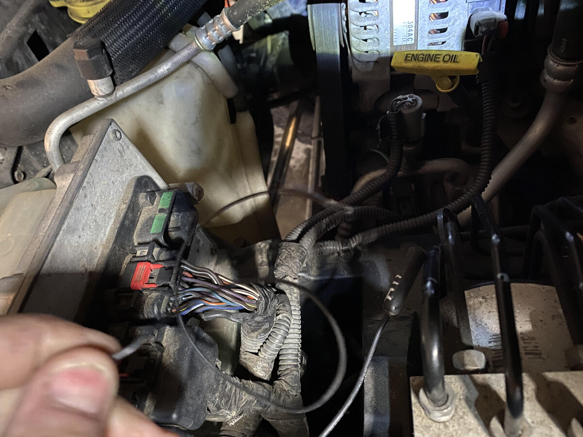

My front windshield washer pump was not working at all so I decided to pull the pump and check it out. I disconnected the negative battery terminal and pulled the connectors on the ECU to access the Pump. I pulled the pump checked it out cleaned everything up and I figured out a temporary fix until I get a new pump. I plugged all the connectors back in reconnected the battery, and now it wont start, does not even click. we have had a lot of winter weather here and I have had the jeep out nonstop over the last few days. I also noticed this connector and wire with nothing connected to it. The connector comes from the far left the harness to the ECU/PCM. It definitely looks like a ground can anybody here confirm that? The connector has some writing on it that says "ALL".
What year is your Jeep? If it is a broken ground wire there should be a terminal on a ground stud with no wire on it within reach.

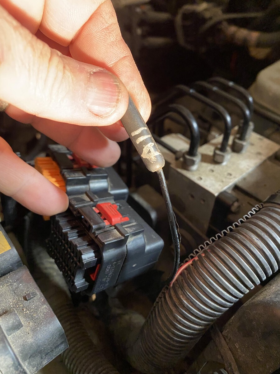

Here is another picture of the black connector on my PCM and the stray wire that has no home. If anyone has an 07 JKU do you have this wire attached to something. Their is another stray wire but it has a different type of connector on it even though it looks like the same wire. I have for a pinout for this connector but have yet to find one.
I looked at my 08 and don't see that wire in your hand, my guess it's something a PO ran for something. Never seen a factory wire with something hand written on it. Also the ground stud next to the ECM there is 1 wire connected to it with some numbers on it that looks like it goes under the ECM.
