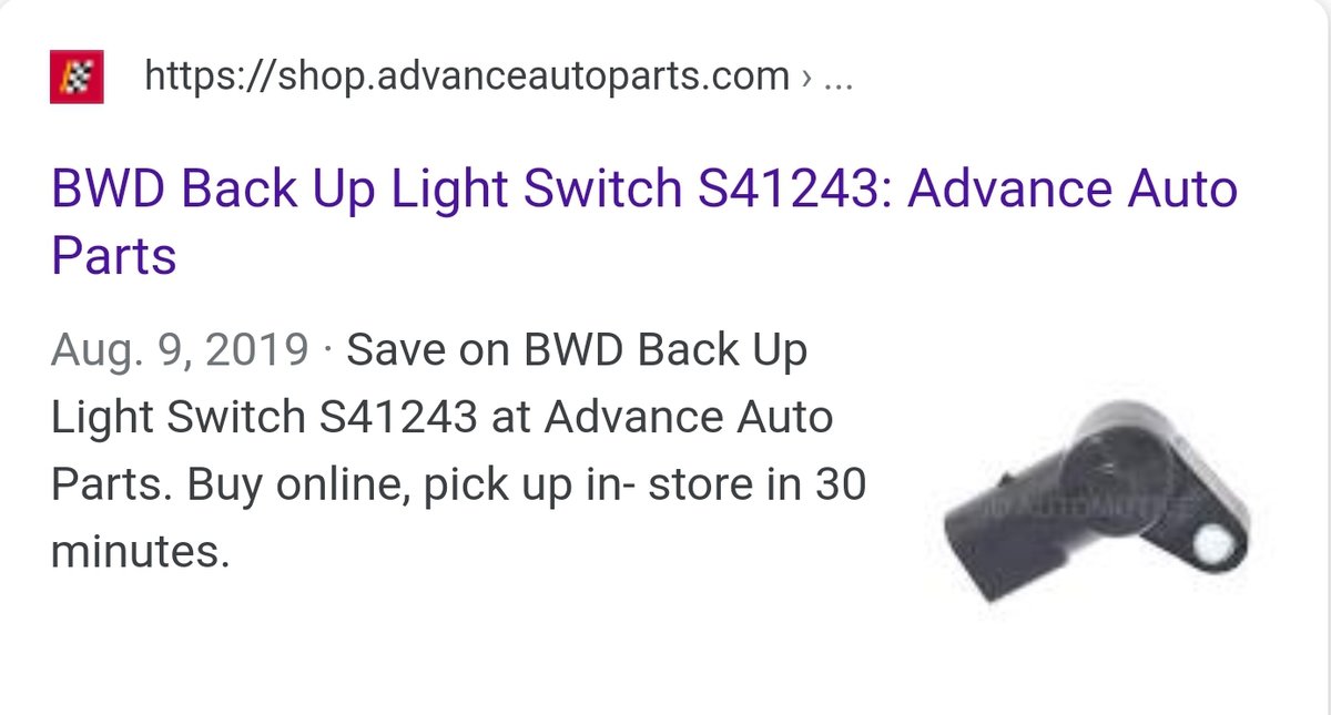

Does the old one pull out after you take the bolt off, I don't want to force it and it only turns
No firsthand experience I can give you, but looking at the photo, it looks like it's just an o-ring in there, so it should pop out. A small screwdriver under the main portion of the switch body should be all the help it needs.
