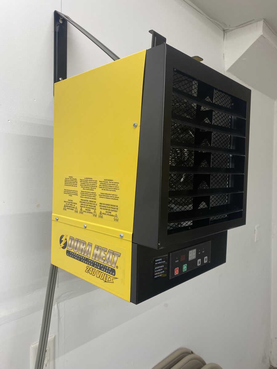

In my limited experience Switches usually get flaky and then die. Soon as my garage gets above Minus 20 I will commence with troubleshooting.
Best investment I've made in ages.
