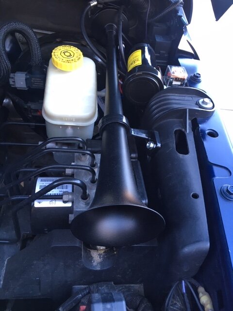

This is very loud 150db as promised by GAMPRO. Horn head is mounted with the existing brake cylinder 12mm mounting bolt by the firewall. I modified the bracket of the oem horn to mount the compressor sideways (yellow sticker) the relay is tucked-in by the side. All wires are hidden under.
Great spot. Unfortunately, I have a switch relay box right there. Sometimes I really wish I had one of these, though.
