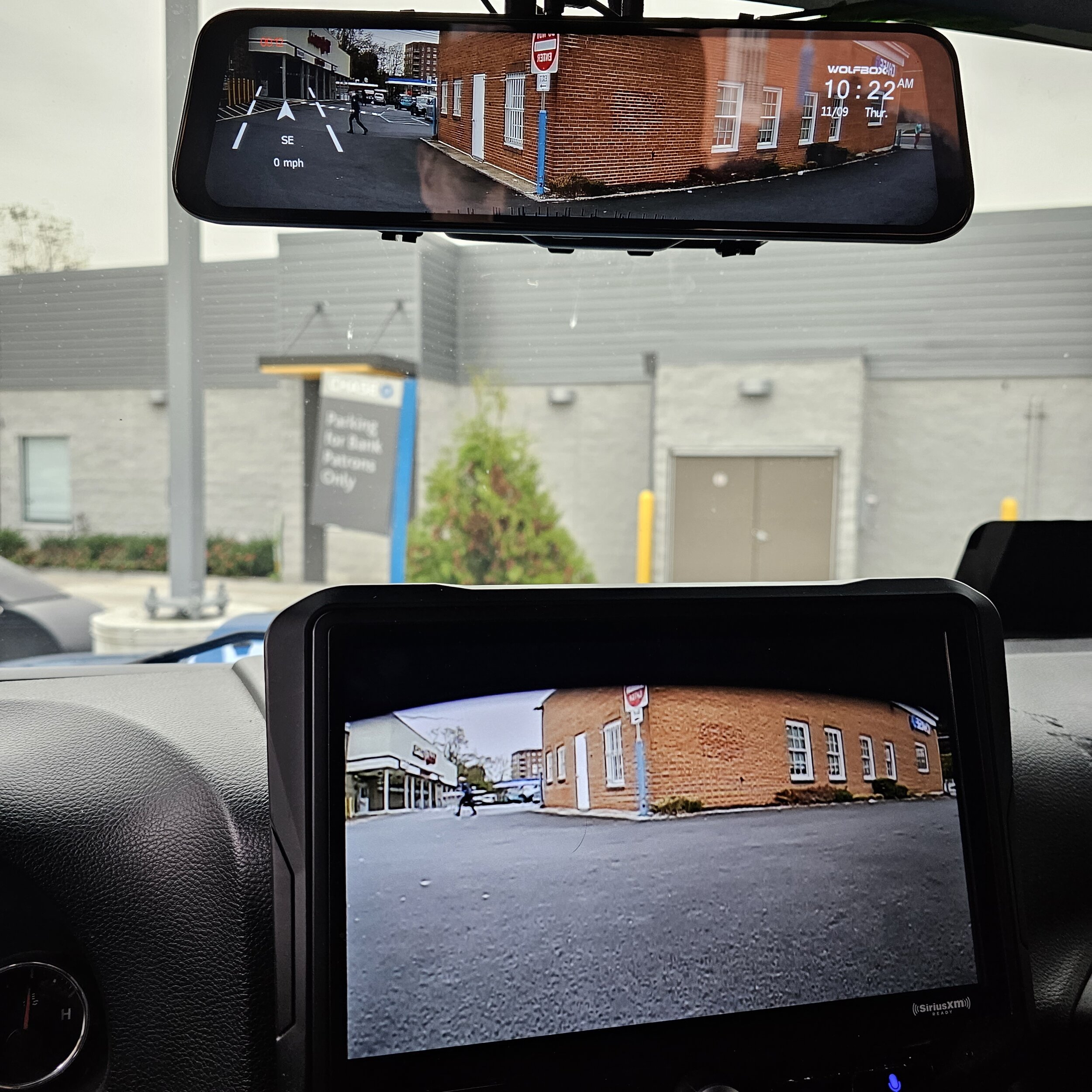

I have had the Volway 10" 2.5K dash cam mirror with backup camera (https://amzn.to/3uG3vkd) since December. It works great.I was looking at the Quadratec rear camera backup system. Has anyone used this system before and if so, what is your opinion of it. Or does anyone know of a good quality rear backup camera to tye into my existing stereo system?

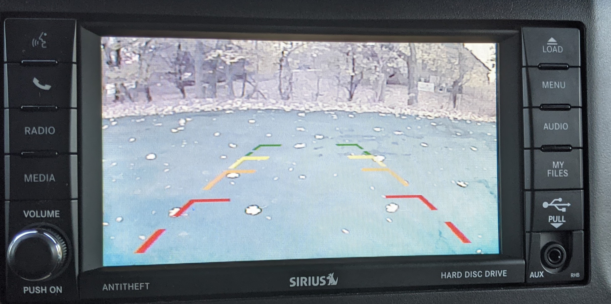

I looked at the Quadratec camera and ended up with this instead:
https://www.ebay.com/itm/3740160946...d=link&campid=5337789113&toolid=20001&mkevt=1
It fits perfectly, has a solid mounting bracket, a good wiring harness that allows power for the camera to be tied in at either end, and it works perfectly, all for under $60.
Quadratec wants $60 for the mount alone, or $150+ for a camera that comes with one.
It's my opinion that you can get an equal or better product for way less $$ elsewhere.
BTW, I tied that eBay camera into my factory head unit and updated the configuration to make it work with Jscan & the iCar Pro OBDII scanner.
That gave me a backup camera for less than $80 (including the iCar license of $20); which is about half the price for just a camera at Quadratec.

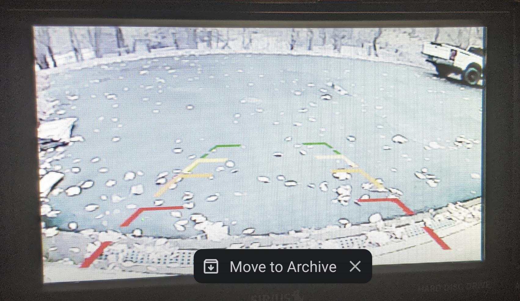

Thx. I'll take a look at some other places within the software. Under Adaptation, Radio & Camera it had a pick to make the rear camera "Active" but I didn't look any farther than that...IIRC, JSCAN has a couple of settings that need to be altered to enable the video feed.
JScan is great, but there are certainly some things that are buried in weird places.Thx. I'll take a look at some other places within the software. Under Adaptation, Radio & Camera it had a pick to make the rear camera "Active" but I didn't look any farther than that...
I found this on the Jscan site that documents what I've already done. I'll still look for other areas though to rule that out. The radio is acting like I would expect - triggered by reverse, camera options show up in settings now, check your surroundings, etc.JScan is great, but there are certainly some things that are buried in weird places.

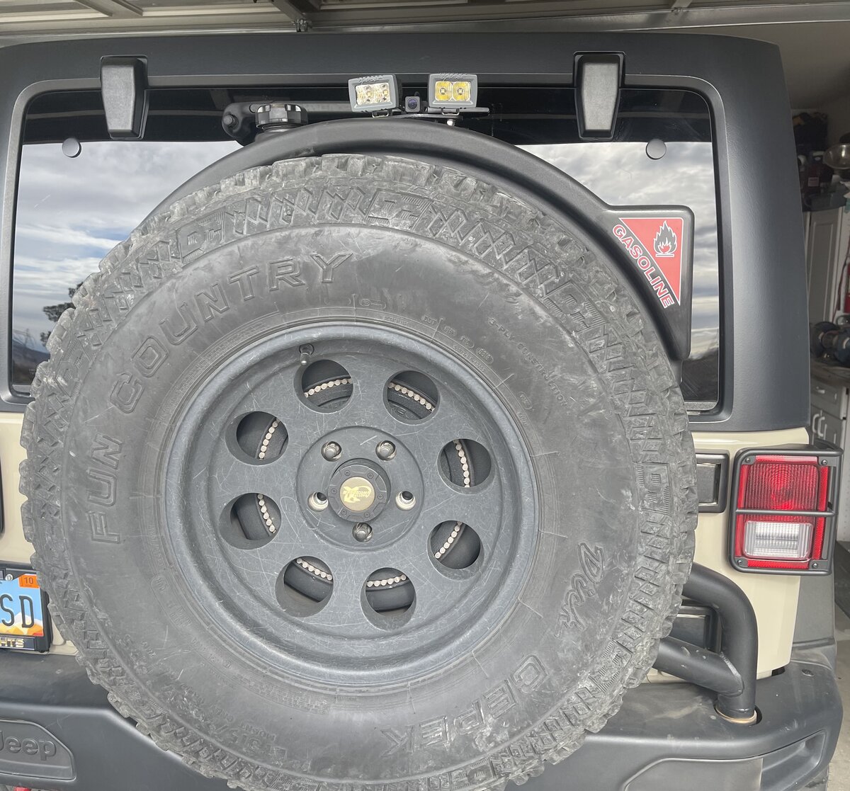

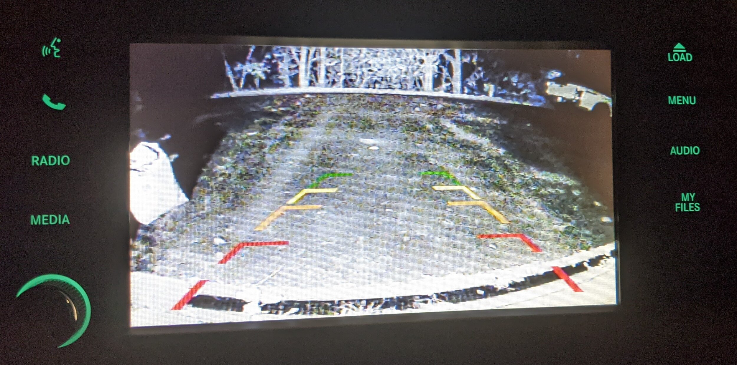

I also went with a camera that has IR. I am interested to try it out in different lighting. The picture I attached above is a bit washed out and I think that is due to the vehicle being in a darker garage. We'll see how it all works out...it has IR vision when its dark
I will try n take a pic during night but for now heres the dayI also went with a camera that has IR. I am interested to try it out in different lighting. The picture I attached above is a bit washed out and I think that is due to the vehicle being in a darker garage. We'll see how it all works out...
