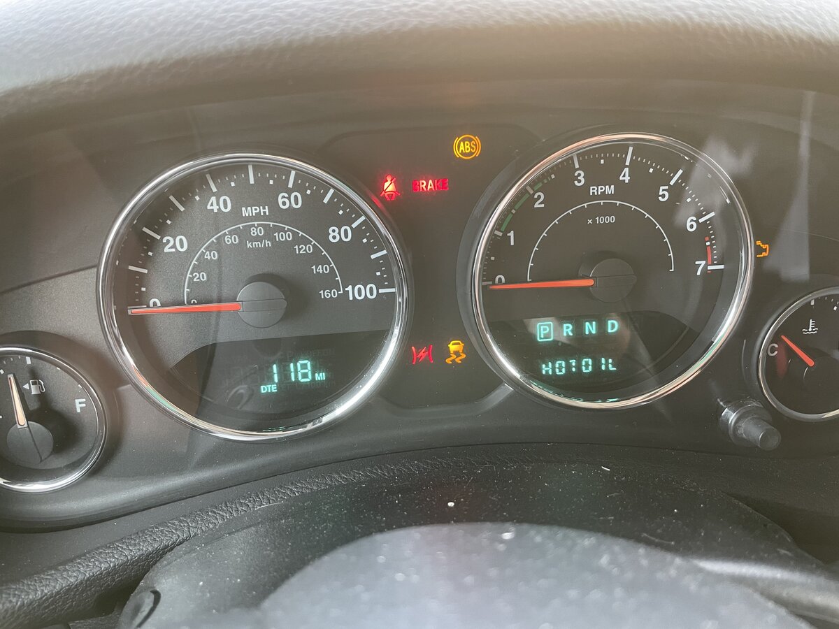

Hello, I have a 2016 Jeep Wrangler JK. Recently, it had started to not crank on first try. Now, it’s taking several tries before it actually cranks. The radio, A/c still comes on. Everything works, but it doesn’t start. It doesn’t click or act like it wants to start. It does nothing when the key is turned, besides turn the radio/ac on. Yesterday, I noticed “HOT OIL” come up on the dash. I checked oil level. It was fine. Temperature outside have been in the 90-100’s. I doubt that has anything to do with it.

I haven’t disconnected anything or changed anything. Not throwing any codes. Had battery checked. It was good. It only says “Hot Oil” when it’s failing to crank. Once it’s running, there’s no message.

I just searched and the Hot oil light has to do with your transmission. Have you checked the fluid level lately, does it look dirty or smell burn't.
The neutral start switch is located inside the transmission on the Jeeps and it could be the problem with the starter not working properly if the other things don't work that I suggested.
My advise would take it to a transmission shop and not a Dealer to have the transmission check out if everything else checks out ok.

when I got my oil changed, I had them check the transmission fluid. Said it looked brand new.
