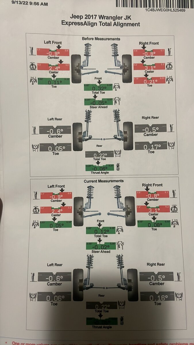

I posted a prior question about replacing a rc lift. I thought before I threw it in the trash I should at least get it aligned.
Alignment now done and after 45mph the jeep feels dangerous, impossible to keep straight. Wondering all over the place. Caster measures 3.0/3.1, everything else in spec.
For reference -
RC 2.5" Coil Lift
Adjustable track bars front and back
Drag bar links replaced (were shot)
Ball Joints Replaced
RC Steering stabilizer
Adjustable sway bar links
Wondering if I got my caster to 4.5 (or there abouts) with adjustable control arms if it would make any difference or am I barking up the wrong tree and something else is wrong?
