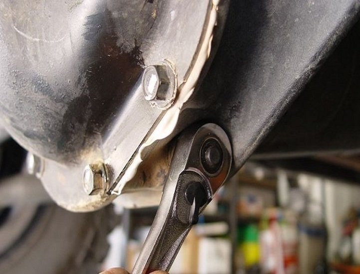

Figure 1. Use the ratchet drive to remove the top fill plug.

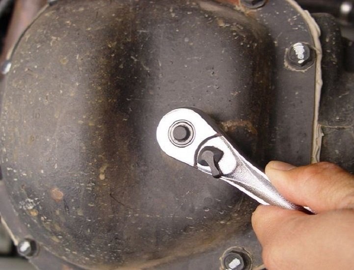

Figure 2. The same ratchet drive is used to remove the drain plug.

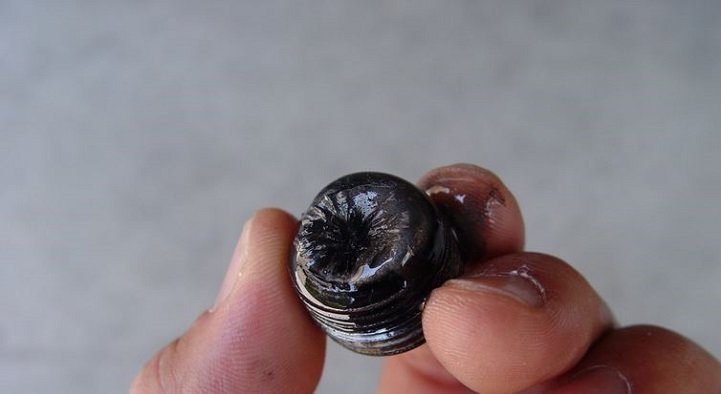

Step 2 – Inspect the drain bolt
The end of the drain bolt is magnetic in order to collect small metal shavings from normal wear and tear on the gears. If you find any large chunks attached, you need to remove the differential cover and inspect your gears. There is likely some damage. At the same time, you will also want to run a magnet through the pan with the old fluid to see if there are any large chunks of debris that came through the hole. This is an indication that you have some issues in the gears that you will need to have addressed and remedied. Before you replace the drain bolt, clean it up nicely with some brake cleaner and wipe it down with a rag.
Figure 3. Inspect the end of the drain bolt for any large debris and clean it up before reinstalling.

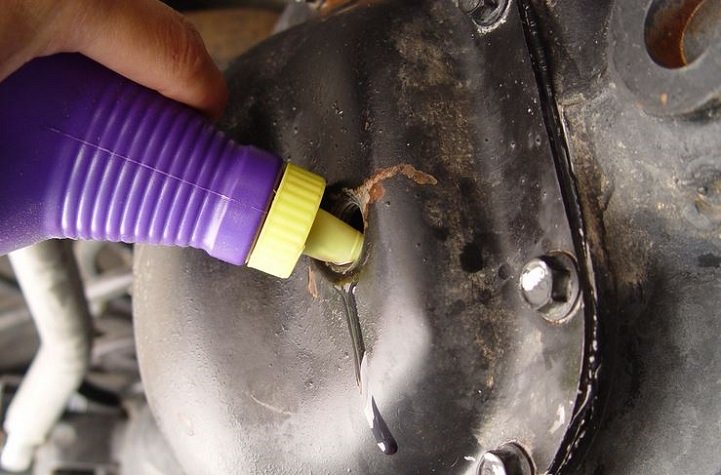

Step 3 – Replace drain bolt and re-fill differential
Figure 4. Stop adding fluid when it starts running back out.

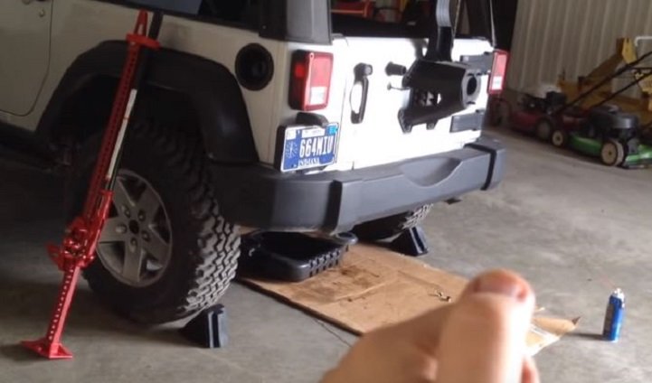

Step 4 – Repeat the process for rear differential
The process for draining and re-filling the rear differential is exactly the same with one minor difference. The rear axle will hold about one additional quart (2.375). Make sure to thoroughly check the drain plug as well as the used oil for any large chunks, and clean the drain plug as you did the front. Do not be concerned if the rear differential fluid is much darker and dirtier than the front, as this is quite normal.
Figure 5. The only difference with the rear from the front is that the rear hold more fluid.

- Using just the ratchet and extension without a socket, remove the fill plug from the differential cover.
- The fill plug has a recessed square hole into which the end of the 3/8" extension will fit.
- Remove the fill plug, this will allow faster draining when the drain plug is removed.
- Have your catch pan located underneath the differential and locate the drain plug on the bottom portion of the differential.
- The drain plug has the same recessed square port for the ratchet extension.
- Remove the lower drain plug and let all the oil drain out into the pan.

- Add new gear oil to the fill hole.
- With stock covers, you only need to fill it until it starts weeping out of the bottom of the fill hole (about 1.35 quarts).
- Do not over-fill.
- If you are using conventional Dino, you will need to add friction modifiers with the limited slip differentials.
- If you are using purely synthetic gear oil, you need no additives.
- Replace the fill plug and torque it to 25 ft/lbs, as well.
